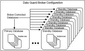

A Data Guard configuration consists of one primary database and up to nine standby databases. The databases in a Data Guard configuration are connected by Oracle Net and may be dispersed geographically. There are no restrictions on where the databases are located if they can communicate with each other. For example, you can have a standby database on the same system as the primary database, along with two standby databases on another system.
The Data Guard broker logically groups these primary and standby databases into a broker configuration that allows the broker to manage and monitor them together as an integrated unit. You can manage a broker configuration using either the Oracle Enterprise Manager graphical user interface or the Data Guard command-line interface.

The broker supports one or more Data Guard configurations, each of which includes a profile for the primary database and each standby database. A supported broker configuration consists of:
A configuration object, which is a named collection of database profiles. A database profile is a description of a database object including its current state, current status, and properties. The configuration object profiles one primary database and its standby databases that can include a mix of both physical and logical standby databases. The databases of a given configuration are typically distributed across multiple host systems.
Database objects, corresponding to primary or standby databases. The broker uses a database object's profile to manage and control the state of a single database on a given system. The database object may be comprised of one or more instance objects if this is a RAC database.
Instance objects. The broker treats a database as a collection of one or more named instances. The broker automatically discovers the instances and associates them with their database.
Figure 1-1 shows the relationship of these objects.
Figure 1-1 Relationship of Objects Managed by the Data Guard Broker

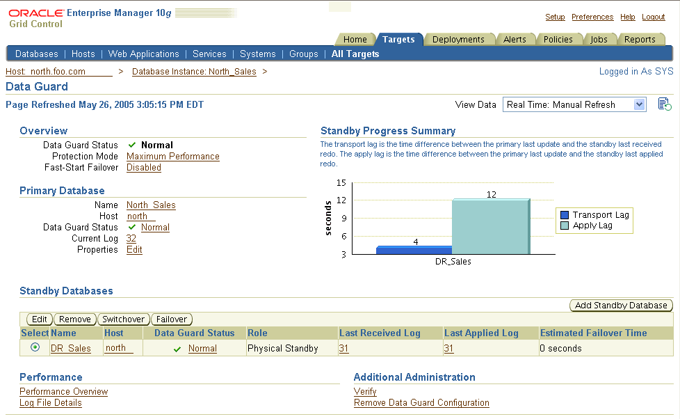

Oracle Enterprise Manager works with the Data Guard monitor to automate and simplify the management of a Data Guard configuration.
With Enterprise Manager, the complex operations of creating and managing standby databases are simplified through Data Guard management pages and wizards, including:
An Add Standby Database wizard that helps you to create a broker configuration, if one does not already exist, having a primary database and a local or remote standby database. The wizard can create a physical or logical standby database (non-RAC) or import an existing physical or logical (RAC or non-RAC) standby database. If the wizard creates a physical or logical standby database, the wizard also automates the creation of the standby control file, server parameter file, online redo log files, and the standby datafiles.
A switchover operation that helps you switch roles between the primary database and a standby database.
A failover operation that changes one of the standby databases to the role of a primary database.
Performance tools and graphs that help you monitor and tune redo transport services and log apply services.
Property pages that allow you to set database properties on any database and, if applicable, the settings are immediately propagated to all other databases and server parameter files in the configuration.
In addition, it makes all Oracle Net Services configuration changes necessary to support redo transport services and log apply services.
Figure 1-3 shows the Data Guard overview page in Oracle Enterprise Manager.
Figure 1-3 Data Guard Overview Page in Oracle Enterprise Manager

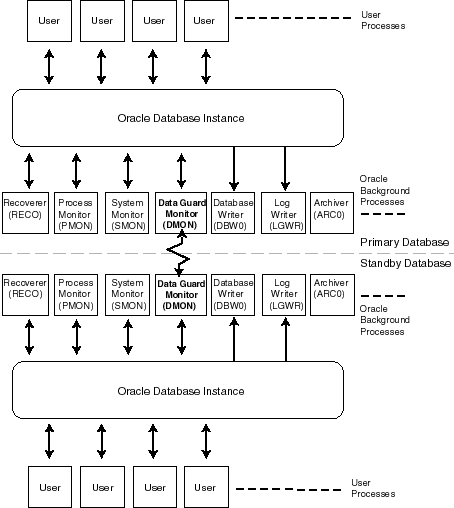

The following sections describe how the Data Guard monitor interacts with the Oracle database and with remote Data Guard monitors to manage the broker configuration.
The Data Guard monitor process (DMON) is an Oracle background process that runs for every database instance that is managed by the broker. When you start the Data Guard broker, a DMON process is created.
See Also:
Section 3.3 for information on starting the broker.Whether you use Oracle Enterprise Manager or DGMGRL to manage a database, the DMON process is the server-side component that interacts with the local database and the DMON processes of the other databases to perform the requested function. The DMON process is also responsible for monitoring the health of the broker configuration and for ensuring that every database has a consistent description of the configuration.
See Also:
Oracle Database Concepts for more information about the memory structures and processes that are used with an Oracle databaseFigure 1-4 shows the broker's DMON process as one of several background processes that constitute an instance of the Oracle database. Figure 1-4 shows multiple databases, each having its own DMON process.
Figure 1-4 Databases With Broker (DMON) Processes
The zigzag arrow in the center of Figure 1-4 represents the two-way Oracle Net Services communication channel that exists between the DMON processes of two databases in the same broker configuration.
This two-way communication channel is used to pass requests between databases and to monitor the health of all of the databases in the broker configuration.
