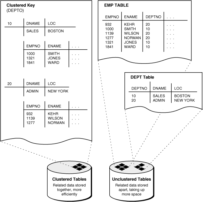

A cluster provides an optional method of storing table data. A cluster is made up of a group of tables that share the same data blocks. The tables are grouped together because they share common columns and are often used together. For example, the emp
and dept
table share the deptno
column. When you cluster the emp
and dept
tables (see Figure 18-1), Oracle Database physically stores all rows for each department from both the emp
and dept
tables in the same data blocks.
Because clusters store related rows of different tables together in the same data blocks, properly used clusters offer two primary benefits:
Disk I/O is reduced and access time improves for joins of clustered tables.
