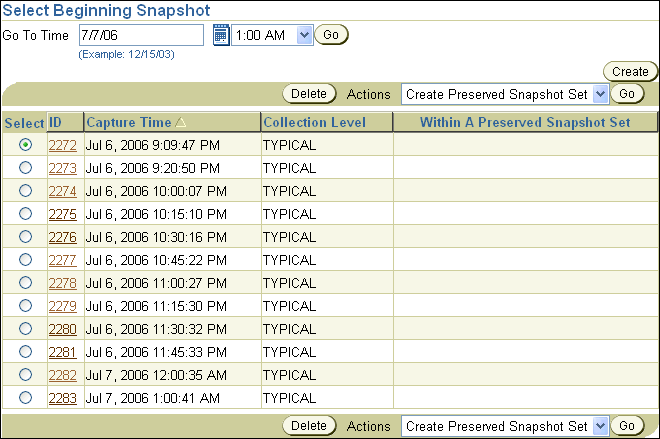

On the Database Performance page, under Additional Monitoring Links, click Snapshots.
The Snapshots page appears with a list of the most recent snapshots.
To filter the snapshots and only display the snapshots taken at the start of the desired baseline, select the time for the starting snapshot in the Go To Time field and click Go.
In this example, 12:00AM on July 7, 2006 is selected.
Select the starting snapshot for the baseline.
In this example, snapshot 2282 is selected.
From the Actions list, select Create Preserved Snapshot Set and click Go.
The Create Preserved Snapshot Set page appears with a list of subsequent snapshots displayed. Note that a system generated value is assigned in the Preserved Snapshot Name field.
Under Select Ending Snapshot, select the ending snapshot for the baseline and click OK.
In this example, snapshot 2283 is selected.

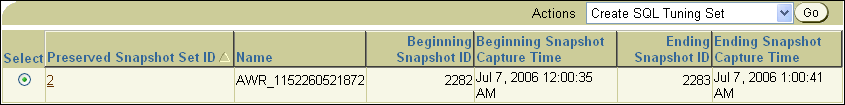

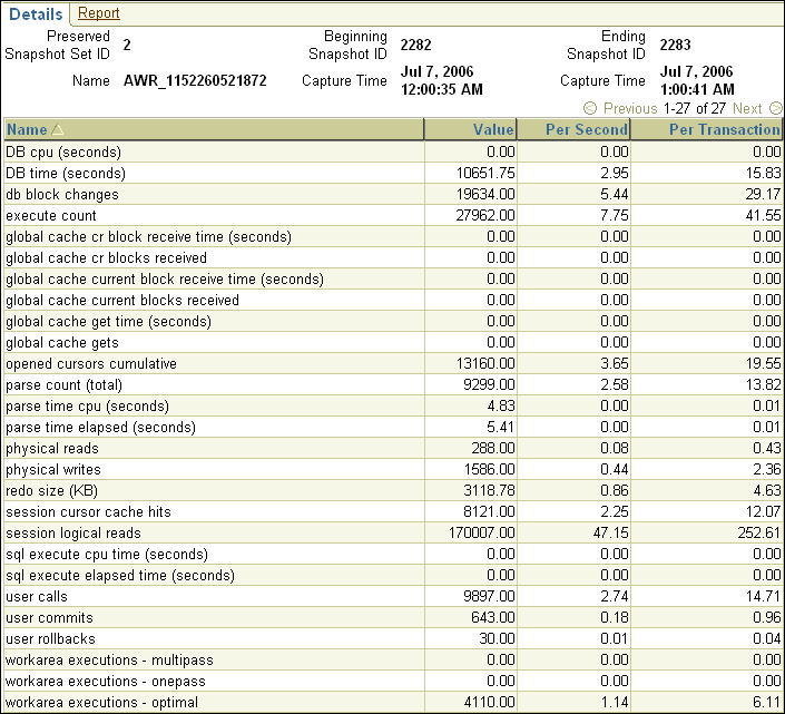

After the preserved snapshot set is taken, the Preserved Snapshot Sets page appears with a Confirmation message.
In this example, the preserved snapshot set that was created has a Preserved Snapshot Set ID of 2 and contains snapshots 2282 through 2283.
The preserved snapshot set that was created can now be used as a baseline for comparison to other snapshots when performance problems occur. To view the statistics gathered for this baseline, click the Preserved Snapshot Set ID link.
The Preserved Snapshot Set Details page appears with the statistics gathered for the baseline displayed.

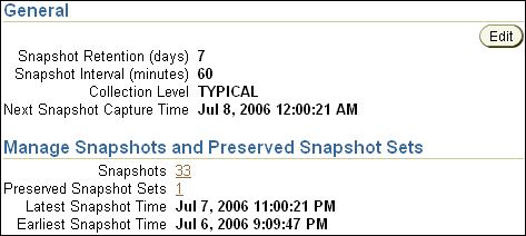

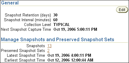

On the Database Administration page, under Statistics Management, click Automatic Workload Repository.
The Automatic Workload Repository page appears.

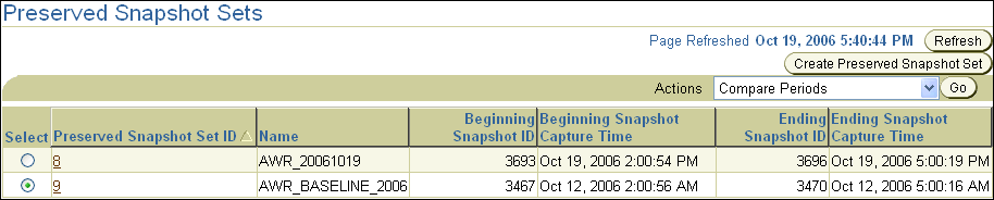

Under Manage Snapshots and Preserved Snapshot Sets, click the link next to Preserved Snapshot Sets.
The Preserved Snapshot Sets page appears.
Select the baseline you want to use for the report. At least one existing preserved snapshot set must be available to be used as a baseline.
From the Actions list, select Compare Periods and click Go.
The Compare Periods: Second Period Start page appears. Under First Period, the selected baseline is displayed. In this example, the baseline named AWR_BASELINE_2006 is selected.
You can compare the baseline selected in the first period to another baseline or a pair of snapshots.

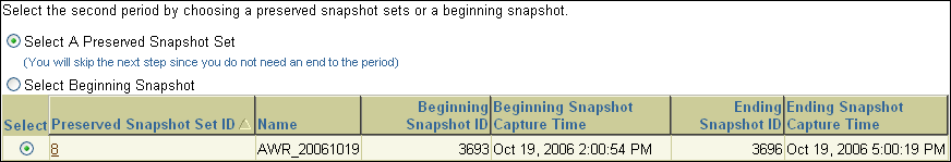

To compare to another baseline, select Select a Preserved Snapshot Set and then the baseline you want to use in the second period.
In this example, the preserved snapshot set named AWR_20061019 is selected.
Click Next. The Compare Periods: Review page appears. Proceed to Step 6.

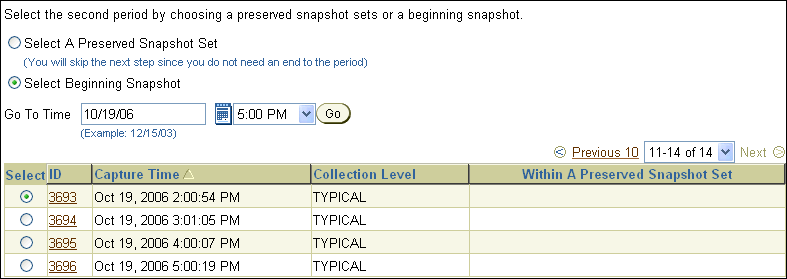

To compare to a pair of snapshots, select Select Beginning Snapshot and then the beginning snapshot you to use in the second period.
In this example, snapshot 3693, taken on October 19, 2006 at 2:00 p.m., is selected.
Click Next. The Compare Periods: Second Period End page appears. Continue with the next step.

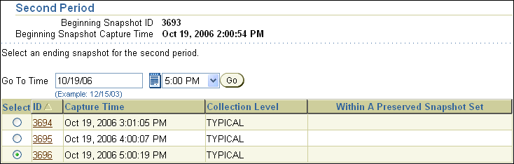

Select the ending snapshot for the snapshot period that will be included in the report and click Next.
In this example, snapshot 3696, taken on October 19, 2006 at 5:00 p.m., is selected.

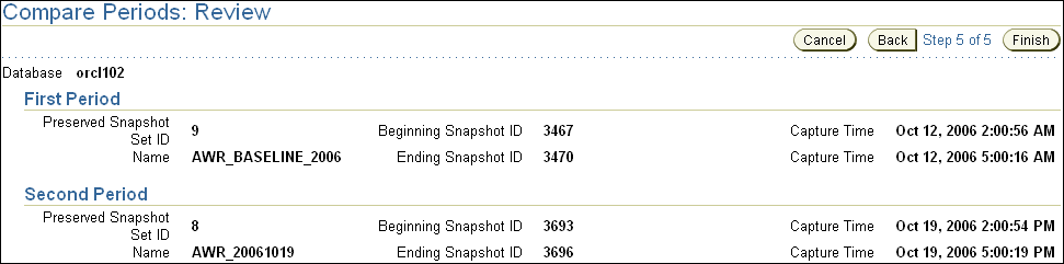

Review the selected periods that will be included in the report and click Finish.

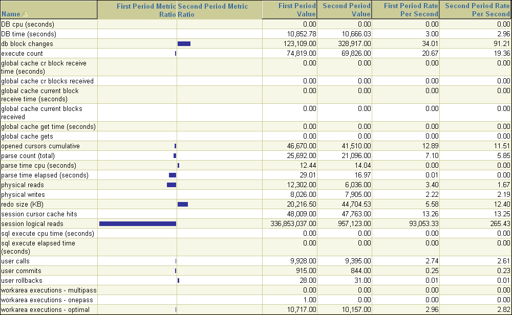

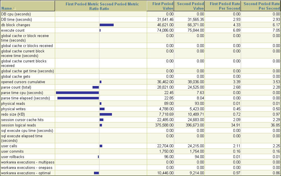

The Compare Periods: Results page appears. Data from the selected periods appears under the General subpage. Data can be viewed per second or per transaction by selecting the desired option from the View Data list.
In this example, parse time in the first period is much higher than the second.

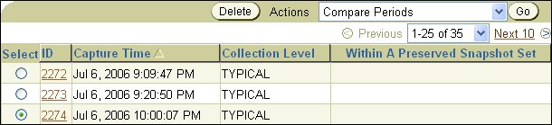

Under Manage Snapshots and Preserved Snapshot Sets, click the link next to Snapshots.
The Snapshots page appears. At least four existing snapshots must be available.
To filter the snapshots and display only the snapshot taken at the start of the comparison period, in the Go To Time field, select the time for the starting snapshot and click Go.
In this example, 10:00 p.m. on Thursday, July 6, 2006, is selected.
Under Select Beginning Snapshot, select the starting point for the first snapshot period that will be included in the report.
In this example, snapshot 2274, taken on Thursday, July 6, 2006 at 10:00 p.m., is selected.

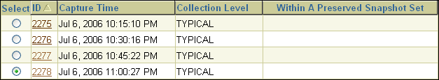

The Compare Periods: First Period End page appears.
Select the ending point for the first snapshot period that will be included in the report and click Next.
In this example, snapshot 2278, taken on Thursday, July 6, 2006 at 11:00 p.m., is selected.

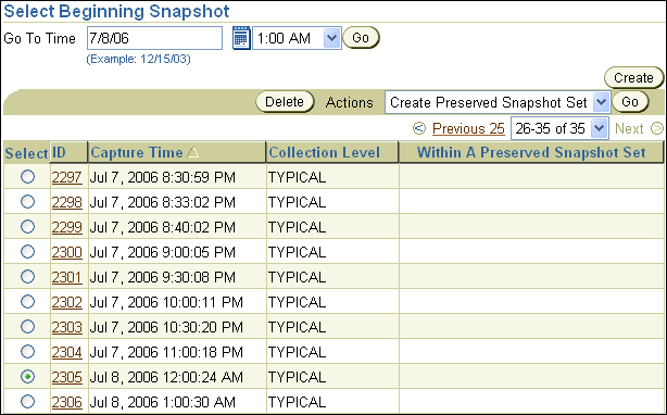

Select the starting point for the second snapshot period that will be included in the report and click Next.
In this example, snapshot 2302, taken on Friday, July 7, 2006 at 10:00 p.m., is selected.

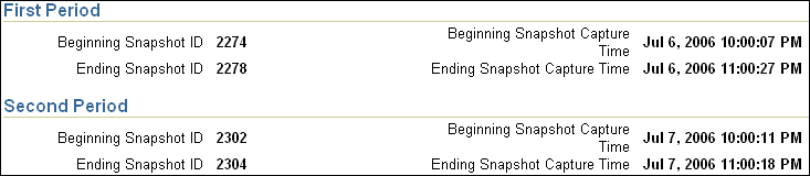

In this example, logical reads in the first period are much higher than the second.

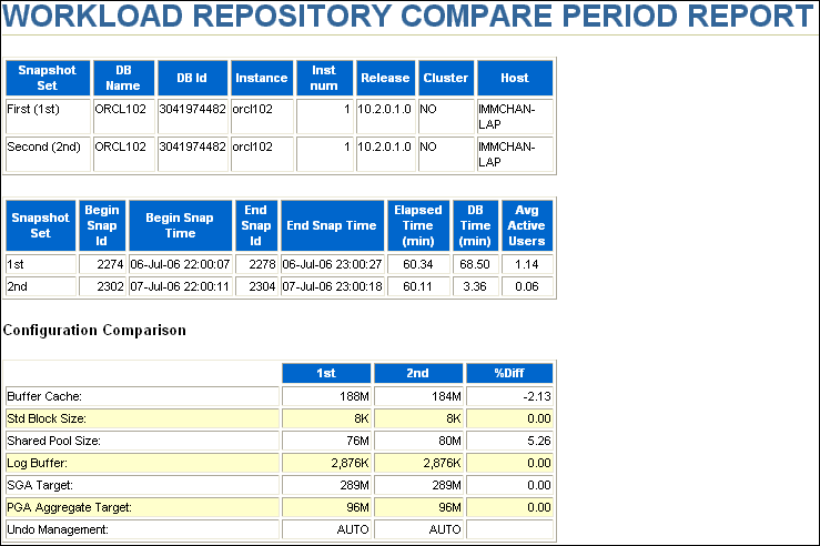

The report summary is at the beginning of the AWR Compare Periods report, and summarizes information about the snapshot sets and loads used in the report. The report summary contains the following sections:

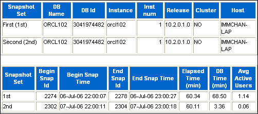

The Snapshot Sets section, shown in Figure 8-2, displays information about the snapshot sets used for this report, such as instance, host, and snapshot information.
In this example, the first snapshot period corresponds to the time when performance degradation was experienced on July 6, 2006 from 10:00 p.m. to 11:00 p.m. The second snapshot period represents a time when performance was stable on July 7, 2006 from 10:00 p.m. to 11:00 p.m.
The Configuration Comparison section compares the configurations used in the two snapshot sets. Any differences in the configurations are quantified as percentages differed in the %Diff column.

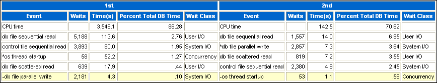

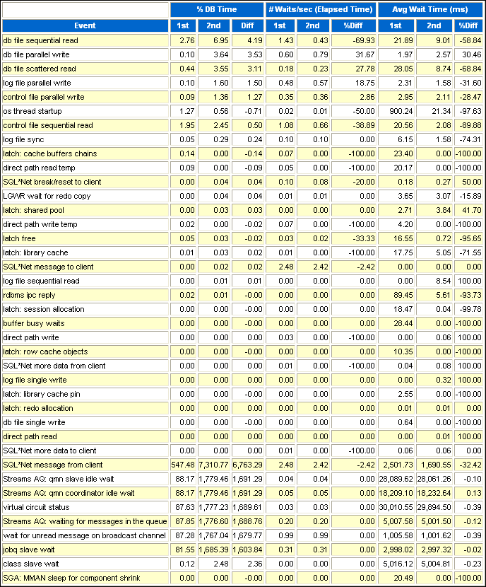

The Top 5 Timed Events section, shown in Figure 8-3, displays the five events or operations that consumed the most CPU time (represented as a percentage of total DB time) in each of the snapshot sets.
In this example, CPU time is much higher in the first period than in the second. Waits for the db file sequential read event is also significantly higher in the first period than in the second.
The Wait Events section, shown in Figure 8-4, compares the wait events in the two snapshot sets. The wait events are ordered based on the difference in total DB time spent on the wait event between the two snapshot sets, and are listed in descending order. Wait events at the top of this section have the greatest differential between the two snapshot sets, and may be possible causes for performance degradation over time.
In this example, the wait time for several events is much higher in the first period than in the second, such as db file sequential read, db file scattered read, latch free, and buffer busy waits.
See Also:

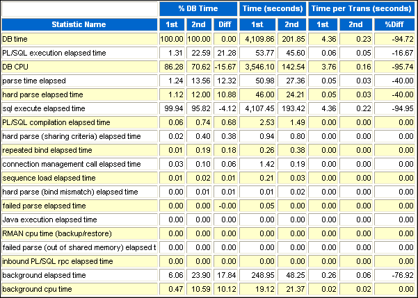

The Time Model Statistics section, shown in Figure 8-5, compares time model statistics in the two snapshot sets. The time model statistics are ordered based on the difference in total DB time spent on a particular type of operation between the two snapshot sets, and are listed in descending order. Time model statistics at the top of this section have the greatest differential between the two snapshot sets, and the related operations may be possible causes for performance degradation over time.
In this example, several statistics are much higher in the first period than in the second, such as DB time, DB CPU, and sql execute elapsed time. This information suggests that the majority of the database activity and CPU utilization are being used by the execution of SQL statements. The SQL Statistics section should be analyzed next to determine if a particular SQL statement is causing the performance degradation.

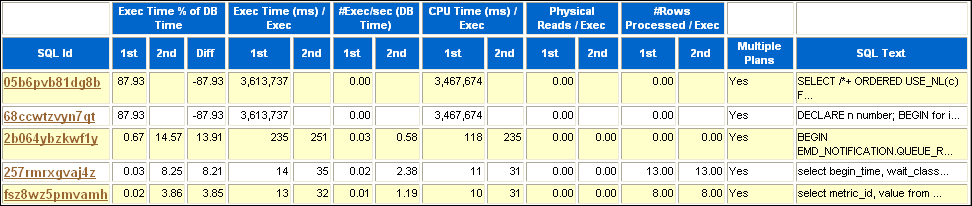

The SQL Statistics section compares the top SQL statements in the two snapshot sets. The SQL statements are ordered based on different comparison methods, but in all cases, the top ten SQL statements with the greatest differential between the two snapshot sets are shown. These SQL statements may be possible causes for performance degradation over time, and are ordered based on the following categories:
SQL statements in this section are ordered based on the difference in total DB time spent processing the SQL statement between the two snapshot sets and are listed in descending order, as shown in Figure 8-6.
Figure 8-6 Top 10 SQL Comparison by Execution Time
In this example, the time it took to execute the top two SQL statements consumed 87.93 percent of DB time in the first period, but not in the second. These two SQL statements are likely the high-load SQL statements that caused the performance degradation in the first period and should be investigated. Review the SQL statements in the Complete List of SQL Text subsection of the report and tune them, if necessary.

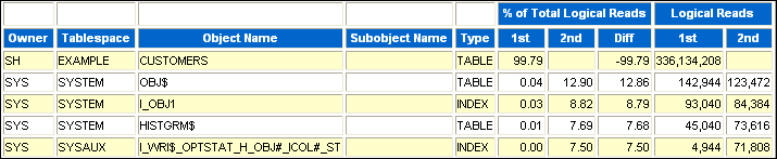

The Segment Statistics section compares segments, or database objects (such as tables and indexes), between the two snapshot sets. The segments are ordered based on different comparison methods, but in all cases the top five segments with the greatest differential between the two snapshot sets are shown. These segments may be the causes of performance degradation over time, and are ordered based on the following categories:
Segments in this section, shown in Figure 8-7, are ordered based on the difference in the number of logical reads (total number of reads from disk or memory) performed on the segment between the two snapshot sets, and are listed in descending order.
Figure 8-7 Top 5 Segments Comparison by Logical Reads
In the example, an extremely high percentage of logical reads are made on the CUSTOMERS table in the first period. Depending on the investigation of the high-load SQL statements, data access to this table may need to be tuned using an index or a materialized view.
