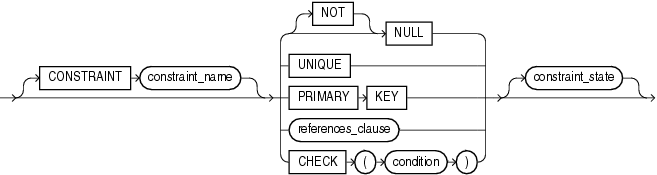

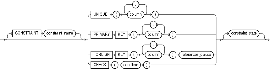

You can define constraints syntactically in two ways:
As part of the definition of an individual column or attribute. This is called inline specification.
As part of the table definition. This is called out-of-line specification.
NOT NULL constraints must be declared inline. All other constraints can be declared either inline or out of line.

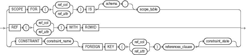

REF constraints let you describe the relationship between a column of type REF and the object it references.
ref_constraint REF constraints use the ref_constraint syntax. You define a REF constraint either inline or out of line. Out-of-line specification requires you to specify the REF column or attribute you are further describing.
For ref_column, specify the name of a REF column of an object or relational table.
For ref_attribute, specify an embedded REF attribute within an object column of a relational table.

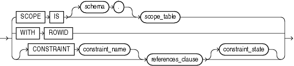

Both inline and out-of-line specification let you define a scope constraint, a rowid constraint, or a referential integrity constraint on a REF column.
If the scope table or referenced table of the REF column has a primary-key-based object identifier, then the REF column is a user-defined REF column.
See Also:
Oracle Database Object-Relational Developer's Guide for more information on REF datatypes
In a table with a REF column, each REF value in the column can conceivably reference a row in a different object table. The SCOPE clause restricts the scope of references to a single table, scope_table. The values in the REF column or attribute point to objects in scope_table, in which object instances of the same type as the REF column are stored.
Specify the SCOPE clause to restrict the scope of references in the REF column to a single table. For you to specify this clause, scope_table must be in your own schema or you must have SELECT privileges on scope_table or SELECT ANY TABLE system privileges. You can specify only one scope table for each REF column.

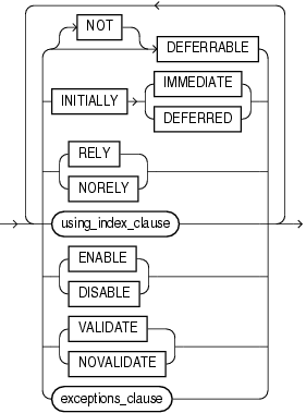

As part of constraint definition, you can specify how and when Oracle should enforce the constraint.
constraint_state You can use the constraint_state with both inline and out-of-line specification. Specify the clauses of constraint_state in the order shown, from top to bottom, and do not specify any clause more than once.
DEFERRABLE Clause The DEFERRABLE and NOT DEFERRABLE parameters indicate whether or not, in subsequent transactions, constraint checking can be deferred until the end of the transaction using the SET CONSTRAINT(S) statement. If you omit this clause, then the default is NOT DEFERRABLE.
Specify NOT DEFERRABLE to indicate that in subsequent transactions you cannot use the SET CONSTRAINT[S] clause to defer checking of this constraint until the transaction is committed. The checking of a NOT DEFERRABLE constraint can never be deferred to the end of the transaction.
If you declare a new constraint NOT DEFERRABLE, then it must be valid at the time the CREATE TABLE or ALTER TABLE statement is committed or the statement will fail.
Specify DEFERRABLE to indicate that in subsequent transactions you can use the SET CONSTRAINT[S] clause to defer checking of this constraint until after the transaction is committed. This setting in effect lets you disable the constraint temporarily while making changes to the database that might violate the constraint until all the changes are complete.
You cannot alter the deferrability of a constraint. Whether you specify either of these parameters, or make the constraint NOT DEFERRABLE implicitly by specifying neither of them, you cannot specify this clause in an ALTER TABLE statement. You must drop the constraint and re-create it.

Restriction on [NOT] DEFERRABLE You cannot specify either of these parameters for a view constraint.
INITIALLY Clause The INITIALLY clause establishes the default checking behavior for constraints that are DEFERRABLE. The INITIALLY setting can be overridden by a SET CONSTRAINT(S) statement in a subsequent transaction.
Specify INITIALLY IMMEDIATE to indicate that Oracle should check this constraint at the end of each subsequent SQL statement. If you do not specify INITIALLY at all, then the default is INITIALLY IMMEDIATE.
If you declare a new constraint INITIALLY IMMEDIATE, then it must be valid at the time the CREATE TABLE or ALTER TABLE statement is committed or the statement will fail.
Specify INITIALLY DEFERRED to indicate that Oracle should check this constraint at the end of subsequent transactions.
This clause is not valid if you have declared the constraint to be NOT DEFERRABLE, because a NOT DEFERRABLE constraint is automatically INITIALLY IMMEDIATE and cannot ever be INITIALLY DEFERRED.
VALIDATE | NOVALIDATE The behavior of VALIDATE and NOVALIDATE always depends on whether the constraint is enabled or disabled, either explicitly or by default. Therefore they are described in the context of "ENABLE Clause" and "DISABLE Clause".
ENABLE Clause Specify ENABLE if you want the constraint to be applied to the data in the table.
If you enable a unique or primary key constraint, and if no index exists on the key, then Oracle Database creates a unique index. Unless you specify KEEP INDEX when subsequently disabling the constraint, this index is dropped and the database rebuilds the index every time the constraint is reenabled.
You can also avoid rebuilding the index and eliminate redundant indexes by creating new primary key and unique constraints initially disabled. Then create (or use existing) nonunique indexes to enforce the constraint. Oracle does not drop a nonunique index when the constraint is disabled, so subsequent ENABLE operations are facilitated.
ENABLE VALIDATE specifies that all old and new data also complies with the constraint. An enabled validated constraint guarantees that all data is and will continue to be valid.
If any row in the table violates the integrity constraint, then the constraint remains disabled and Oracle returns an error. If all rows comply with the constraint, then Oracle enables the constraint. Subsequently, if new data violates the constraint, then Oracle does not execute the statement and returns an error indicating the integrity constraint violation.
If you place a primary key constraint in ENABLE VALIDATE mode, then the validation process will verify that the primary key columns contain no nulls. To avoid this overhead, mark each column in the primary key NOT NULL before entering data into the column and before enabling the primary key constraint of the table.
ENABLE NOVALIDATE ensures that all new DML operations on the constrained data comply with the constraint. This clause does not ensure that existing data in the table complies with the constraint.
If you specify neither VALIDATE nor NOVALIDATE, then the default is VALIDATE.
If you change the state of any single constraint from ENABLE NOVALIDATE to ENABLE VALIDATE, then the operation can be performed in parallel, and does not block reads, writes, or other DDL operations.
Restriction on the ENABLE Clause You cannot enable a foreign key that references a disabled unique or primary key.
DISABLE Clause Specify DISABLE to disable the integrity constraint. Disabled integrity constraints appear in the data dictionary along with enabled constraints. If you do not specify this clause when creating a constraint, then Oracle automatically enables the constraint.
DISABLE VALIDATE disables the constraint and drops the index on the constraint, but keeps the constraint valid. This feature is most useful in data warehousing situations, because it lets you load large amounts of data while also saving space by not having an index. This setting lets you load data from a nonpartitioned table into a partitioned table using the exchange_partition_clause of the ALTER TABLE statement or using SQL*Loader. All other modifications to the table (inserts, updates, and deletes) by other SQL statements are disallowed.
See Also:
Oracle Database Data Warehousing Guide for more information on using this settingDISABLE NOVALIDATE signifies that Oracle makes no effort to maintain the constraint (because it is disabled) and cannot guarantee that the constraint is true (because it is not being validated).
You cannot drop a table whose primary key is being referenced by a foreign key even if the foreign key constraint is in DISABLE NOVALIDATE state. Further, the optimizer can use constraints in DISABLE NOVALIDATE state.
See Also:
Oracle Database Performance Tuning Guide for information on when to use this settingIf you specify neither VALIDATE nor NOVALIDATE, then the default is NOVALIDATE.
If you disable a unique or primary key constraint that is using a unique index, then Oracle drops the unique index. Refer to the CREATE TABLE enable_disable_clause for additional notes and restrictions.
RELY Clause  RELY and NORELY are valid only when you are modifying an existing constraint (in the ALTER TABLE ... MODIFY constraint syntax). These parameters specify whether a constraint in NOVALIDATE mode is to be taken into account for query rewrite. Specify RELY to activate an existing constraint in NOVALIDATE mode for query rewrite in an unenforced query rewrite integrity mode. The constraint is in NOVALIDATE mode, so Oracle does not enforce it. The default is NORELY.
Unenforced constraints are generally useful only with materialized views and query rewrite. Depending on the QUERY_REWRITE_INTEGRITY mode, query rewrite can use only constraints that are in VALIDATE mode, or that are in NOVALIDATE mode with the RELY parameter set, to determine join information.
Restriction on the RELY Clause You cannot set a nondeferrable NOT NULL constraint to RELY.
See Also:
Oracle Database Data Warehousing Guide for more information on materialized views and query rewriteUsing Indexes to Enforce Constraints
When defining the state of a unique or primary key constraint, you can specify an index for Oracle to use to enforce the constraint, or you can instruct Oracle to create the index used to enforce the constraint.
using_index_clause You can specify the using_index_clause only when enabling unique or primary key constraints. You can specify the clauses of the using_index_clause in any order, but you can specify each clause only once.
If you specify schema.index, then Oracle attempts to enforce the constraint using the specified index. If Oracle cannot find the index or cannot use the index to enforce the constraint, then Oracle returns an error.
If you specify the create_index_statement, then Oracle attempts to create the index and use it to enforce the constraint. If Oracle cannot create the index or cannot use the index to enforce the constraint, then Oracle returns an error.
If you neither specify an existing index nor create a new index, then Oracle creates the index. In this case:
The index receives the same name as the constraint.
If table is partitioned, then you can specify a locally or globally partitioned index for the unique or primary key constraint.
Restrictions on the using_index_clause The following restrictions apply to the using_index_clause:
You cannot specify this clause for a view constraint.
You cannot specify this clause for a NOT NULL, foreign key, or check constraint.
You cannot specify an index (schema.index) or create an index (create_index_statement) when enabling the primary key of an index-organized table.
You cannot specify the parallel_clause of index_attributes.
The INDEXTYPE IS ... clause of index_properties is not valid in the definition of a constraint.
See Also:
CREATE INDEX for a description of index_attributes, the global_partitioned_index and local_partitioned_index clauses, and for a description of NOSORT and the logging_clause in relation to indexes
physical_attributes_clause and PCTFREE parameters and storage_clause

The following example creates the same table but with a referential integrity constraint on the REF column that references the object identifier column of the parent table:
CREATE TABLE customer_addresses ( add_id NUMBER, address REF cust_address_typ REFERENCES address_table);
The following example uses the type department_typ and the table departments_obj_t, created in "Creating Object Tables: Examples". A table with a scoped REF is then created.
CREATE TABLE employees_obj
   ( e_name   VARCHAR2(100),
     e_number NUMBER,
     e_dept   REF department_typ SCOPE IS departments_obj_t );
The following statement creates a table with a REF column which has a referential integrity constraint defined on it:
     e_number NUMBER,
     e_dept   REF department_typ REFERENCES departments_obj_t);

This example also shows that you can create an index for one constraint and use that index to create and enable another constraint in the same statement.
DEFERRABLE Constraint Examples The following statement creates table games with a NOT DEFERRABLE INITIALLY IMMEDIATE constraint check (by default) on the scores column:
CREATE TABLE games (scores NUMBER CHECK (scores >= 0));
To define a unique constraint on a column as INITIALLY DEFERRED DEFERRABLE, issue the following statement:
CREATE TABLE games (scores NUMBER, CONSTRAINT unq_num UNIQUE (scores) INITIALLY DEFERRED DEFERRABLE);
