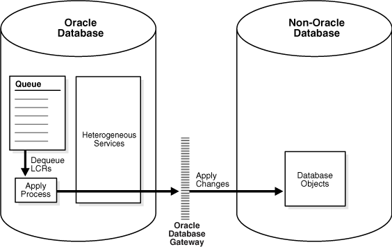

To share DML changes from an Oracle source database to a non-Oracle destination database, the Oracle database functions as a proxy and carries out some of the steps that would usually be done at the destination database. That is, the LCRs intended for the non-Oracle destination database are dequeued in the Oracle database itself and an apply process at the Oracle database applies the changes to the non-Oracle database across a network connection through an Oracle Database Gateway. Figure 5-1 shows an Oracle database sharing data with a non-Oracle database.
Figure 5-1 Oracle to Non-Oracle Heterogeneous Data Sharing
You should configure the Oracle Database Gateway to use the transaction model COMMIT_CONFIRM.
See Also:
The Oracle documentation for your specific Oracle Database Gateway for information about using the transaction modelCOMMIT_CONFIRM for your Oracle Database GatewayIn an Oracle to non-Oracle environment, a capture process or a synchronous capture functions the same way as it would in an Oracle-only environment. That is, a capture process finds changes in the redo log, captures them based on its rules, and enqueues the captured changes as logical change records (LCRs) into an ANYDATA queue. A synchronous capture uses an internal mechanism to capture changes based on its rules and enqueue the captured changes as row LCRs into an ANYDATA queue. In addition, a single capture process or synchronous capture can capture changes that will be applied at both Oracle and non-Oracle databases.
Similarly, the ANYDATA queue that stages the LCRs functions the same way as it would in an Oracle-only environment, and you can propagate LCRs to any number of intermediate queues in Oracle databases before they are applied at a non-Oracle database.
See Also:
Oracle Streams Concepts and Administration for general information about capture processes, synchronous captures, staging, and propagations
Chapter 1, "Understanding Oracle Streams Replication" for information about capture processes, synchronous captures, staging, and propagations in an Oracle Streams replication environment
An apply process running in an Oracle database uses Heterogeneous Services and an Oracle Database Gateway to apply changes encapsulated in LCRs directly to database objects in a non-Oracle database. The LCRs are not propagated to a queue in the non-Oracle database, as they would be in an Oracle-only Oracle Streams environment. Instead, the apply process applies the changes directly through a database link to the non-Oracle database.

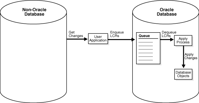

To capture and propagate changes from a non-Oracle database to an Oracle database, a custom application is required. This application gets the changes made to the non-Oracle database by reading from transaction logs, by using triggers, or by some other method. The application must assemble and order the transactions and must convert each change into a logical change record (LCR). Next, the application must enqueue the LCRs in an Oracle database using the DBMS_STREAMS_MESSAGING package or the DBMS_AQ package. The application must commit after enqueuing all LCRs in each transaction. Figure 5-2 shows a non-Oracle databases sharing data with an Oracle database.
Figure 5-2 Non-Oracle to Oracle Heterogeneous Data Sharing
Because the custom user application is responsible for assembling changes at the non-Oracle database into LCRs and enqueuing the LCRs at the Oracle database, the application is completely responsible for change capture. This means that the application must construct LCRs that represent changes at the non-Oracle database and then enqueue these LCRs into the queue at the Oracle database. The application can enqueue multiple transactions concurrently, but the transactions must be committed in the same order as the transactions on the non-Oracle source database.
