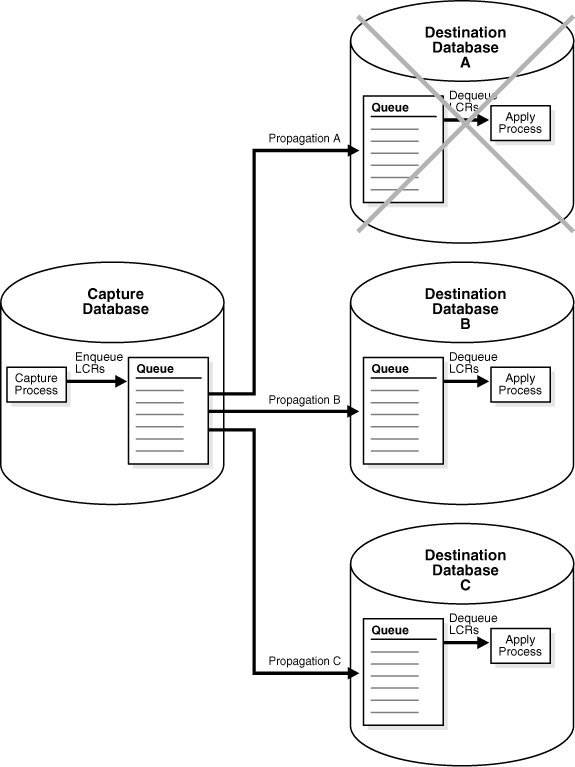

Figure 9-1 shows an Oracle Streams replication environment with a problem destination. Destination database A is down, and messages intended for destination database A are building up in the queue at the capture database.
Figure 9-1 Problem Destination in an Oracle Streams Replication Environment
You can use the following data dictionary views to determine when there is a problem with a propagation:
Query the V$BUFFERED_QUEUES view to identify how many messages are in a buffered queue and how many of these messages have spilled to hard disk.
Query the DBA_PROPAGATION and V$PROPAGATION_SENDER views to show the propagations in a database and the status of each propagation
To avoid degraded performance in this situation, use the SPLIT_STREAMS, MERGE_STREAMS_JOB, and MERGE_STREAMS procedures in the DBMS_STREAMS_ADM package. The SPLIT_STREAMS procedure splits off the stream for the problem propagation destination from all of the other streams flowing from a capture process to other destinations. The SPLIT_STREAMS procedure clones the capture process, queue, and propagation. The cloned versions of these components are used by the stream that is split off. While the stream that cannot propagate changes is split off, the streams to other destinations proceed as usual.

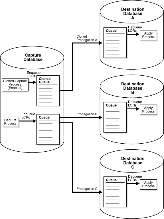

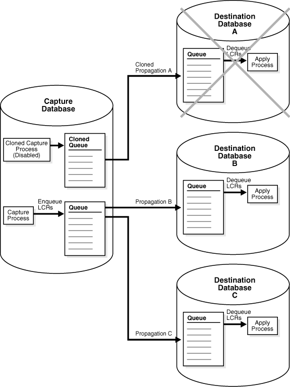

Figure 9-2 shows the cloned stream created by the SPLIT_STREAMS procedure.
When the problem destination becomes available again, you start the cloned capture process, and the cloned stream begins to send messages to the destination database again.
Figure 9-3 shows a destination database A that is up and running and a cloned capture process that is enabled at the capture database. The cloned stream begins to flow and starts to catch up to the original streams.
Figure 9-3 Cloned Stream Begins Flowing and Starts to Catch Up to One of the Original Oracle Streams

Re-creates the propagation called strms_prop_a. This propagation propagates messages from the streams_queue queue to the existing destination queue used by the cloned_prop_a propagation. The re-created propagation strms_prop_a uses the same rule set as the cloned propagation cloned_prop_a.
Starts the original capture process strms_capture from the lower SCN value of these two SCN values:
The acknowledged SCN of the cloned propagation cloned_prop_a.
The lowest acknowledged SCN of the other propagations that propagate changes captured by the original capture process (propagations strms_prop_b and strms_prop_c in this example).
When the strms_capture capture process is started, it might recapture changes that it already captured, or it might capture changes that were already captured by the cloned capture process cloned_capture. In either case, the relevant apply processes will discard any duplicate changes they receive.
Drops the cloned propagation cloned_prop_a.
Drops the cloned capture process cloned_capture.
Drops the cloned queue cloned_queue.
After the streams are merged, the Oracle Streams replication environment has the same components as it had before the split and merge operation.
The example in this section splits and merges streams by generating and running scripts. That is, the perform_actions parameter is set to FALSE in the SPLIT_STREAMS procedure. Also, the example merges the streams manually at the appropriate time. That is, the auto_merge_threshold parameter is set to NULL in the SPLIT_STREAMS procedure.
Complete the following steps to use scripts to split and merge streams:
In SQL*Plus, connect as the Oracle Streams administrator to the database with the capture process.
See Oracle Database Administrator's Guide for instructions about connecting to a database in SQL*Plus.
If it does not already exist, then create a directory object named db_dir to hold the scripts generated by the procedures:
CREATE DIRECTORY db_dir AS '/usr/db_files';
Run the following procedure to generate a script to split the streams:
DECLARE
    schedule_name  VARCHAR2(30);
    job_name       VARCHAR2(30);
BEGIN
  DBMS_STREAMS_ADM.SPLIT_STREAMS(
    propagation_name        => 'strms_prop_a',
    cloned_propagation_name => 'cloned_prop_a',
    cloned_queue_name       => 'cloned_queue',
    cloned_capture_name     => 'cloned_capture',
    perform_actions         => FALSE,
    script_name             => 'split.sql',
    script_directory_object => 'db_dir',
    auto_merge_threshold    => NULL,
    schedule_name           => schedule_name,
    merge_job_name          => job_name);
END;
Running this procedure generates the split.sql script. The script contains the actions that will split the stream flowing through propagation strms_prop_a from the other propagations flowing from the strms_capture capture process.

Running the script performs the following actions:
Runs the SET_UP_QUEUE procedure in the DBMS_STREAMS_ADM package to create a new queue called cloned_queue.
Runs the CREATE_PROPAGATION procedure in the DBMS_PROPAGATION_ADM package to create a new propagation called cloned_prop_a. This new propagation propagates messages from the cloned_queue queue to the existing destination queue used by the strms_prop_a propagation. The cloned propagation cloned_prop_a uses the same rule set as the original propagation strms_prop_a.
The CREATE_PROPAGATION procedure sets the original_propagation_name parameter to strms_prop_a and the auto_merge_threshold parameter to NULL.
Runs the STOP_CAPTURE procedure in the DBMS_CAPTURE_ADM package to stop the capture process strms_capture.
Queries the acknowledge SCN for the original propagation strms_prop_a. The acknowledged SCN is the last SCN acknowledged by the apply process that applies the changes sent by the propagation. The ACKED_SCN value in the DBA_PROPAGATION view shows the acknowledged SCN for a propagation.
Runs the CREATE_CAPTURE procedure in the DBMS_CAPTURE_ADM package to create a new capture process called cloned_capture. The start SCN for cloned_capture is set to the value of the acknowledged SCN for the strms_prop_a propagation. The cloned capture process cloned_capture uses the same rule set as the original capture process strms_capture.
Runs the DROP_PROPAGATION procedure in the DBMS_PROPAGATION_ADM package to drop the original propagation strms_prop_a.
Runs the START_CAPTURE procedure in the DBMS_CAPTURE_ADM package to start the original capture process strms_capture with the start SCN set to the value of the acknowledged SCN for the strms_prop_a propagation.
Correct the problem with the destination of cloned_prop_a. The problem is corrected when the destination queue for cloned_prop_a can accept propagated messages and an apply process at the destination database can dequeue and process these messages.
