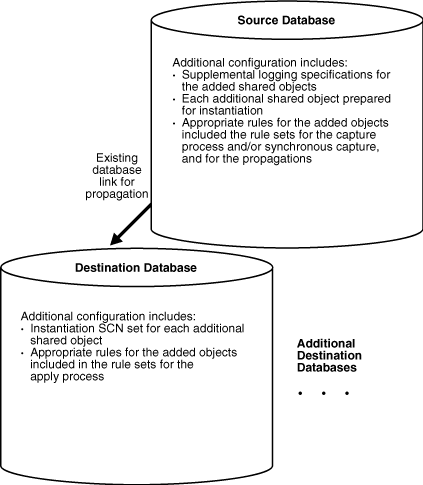

Figure 8-1 shows the additional configuration steps that must be completed to add shared database objects to a single-source Oracle Streams environment.
Figure 8-1 Example of Adding Shared Objects to a Single-Source Environment
To avoid losing LCRs, you should complete the configuration in the following order:

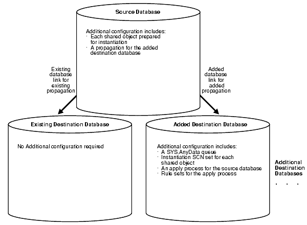

As in the example that describes "Adding Shared Objects to an Existing Single-Source Environment", before creating or altering propagation rules in a running Oracle Streams environment, ensure that any propagations or apply processes that will receive LCRs as a result of the new or altered rules are configured to handle these LCRs. Otherwise, LCRs can be lost.
This example assumes that the shared database objects are read-only at the destination databases. If the shared objects are read/write at the destination databases, then the replication environment will not stay synchronized because Oracle Streams is not configured to replicate the changes made to the shared objects at the destination databases.
Figure 8-2 shows the additional configuration steps that must be completed to add a destination database to a single-source Oracle Streams environment.
Figure 8-2 Example of Adding a Destination to a Single-Source Environment

Create one or more apply processes at the new destination database to apply the changes from its source database. Ensure that each apply process uses rule sets that are appropriate for applying changes. Do not start any of the apply processes at the new database. See "Creating an Apply Process That Applies Captured LCRs" for instructions.
Keeping the apply processes stopped prevents changes made at the source databases from being applied before the instantiation of the new database is completed, which would otherwise lead to incorrect data and errors.
Configure any necessary propagations to propagate changes from the source databases to the new destination database. Ensure that each propagation uses rule sets that are appropriate for propagating changes. See "Creating a Propagation that Propagates LCRs".

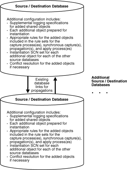

Figure 8-3 shows the additional configuration steps that must be completed to add shared database objects to a multiple-source Oracle Streams environment.
Figure 8-3 Example of Adding Shared Objects to a Multiple-Source Environment
When there are multiple source databases in an Oracle Streams replication environment, change cycling is possible. Change cycling happens when a change is sent back to the database where it originated. Typically, you should avoid change cycling. Before you configure your replication environment, see Chapter 4, "Oracle Streams Tags", and ensure that you configure the replication environment to avoid change cycling.
At each populated database, specify any necessary supplemental logging for the objects being added to the environment. See "Managing Supplemental Logging in an Oracle Streams Replication Environment" for instructions.
Either stop all of the capture processes that will capture changes to the added objects, stop all of the propagations that will propagate changes to the added objects, or stop all of the apply process that will apply changes to the added objects:

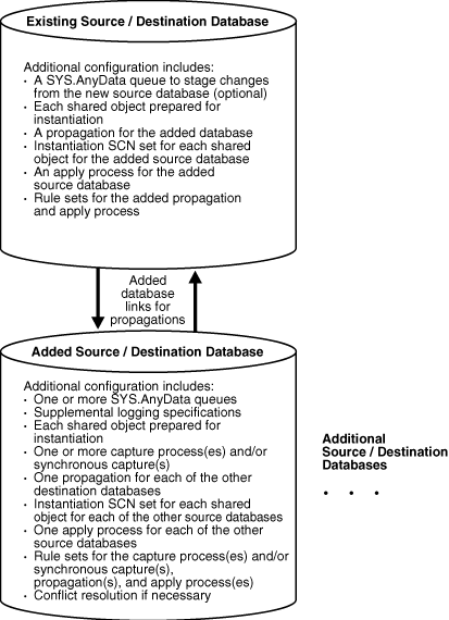

Figure 8-4 Example of Adding a Database to a Multiple-Source Environment
Complete the following steps to add a new source/destination database to an existing multiple-source Oracle Streams environment:
Ensure that no changes are made to the objects being shared at the database you are adding to the Oracle Streams environment until the instantiation at the database is complete.Complete the necessary tasks to prepare each database in your environment for Oracle Streams:
Configure an Oracle Streams administrator.
Set initialization parameters relevant to Oracle Streams.
For each database that will run a capture process, prepare the database to run a capture process.
Configure network connectivity and database links.
Some of these tasks might not be required at certain databases.
