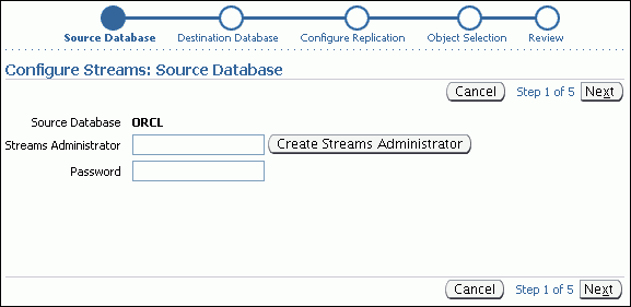

The Oracle Streams tool in Enterprise Manager includes two wizards that configure an Oracle Streams replication environment. The following sections describe the wizards and how to open them:
The Steams Global, Schema, Table, and Subset Replication wizard can configure an Oracle Streams environment that replicates changes to the entire source database, certain schemas in the source database, certain tables in the source database, or subsets of tables in the source database.
This wizard can configure an Oracle Streams environment that maintains DML changes, DDL changes, or both. The database objects configured for replication by this wizard can be in multiple tablespaces in your source database. This wizard only configures a single-source replication environment. It cannot configure a bi-directional replication environment.
You can run this wizard in Database Control or Grid Control. To run this wizard in Database Control, meet the following requirements:
This wizard, or the scripts generated by this wizard, must be run at an Oracle Database 10g Release 2 or later database.
The destination database configured by this wizard must be an Oracle Database 10g Release 1 or later database.
To run this wizard in Grid Control, meet the following requirements:
This wizard, or the scripts generated by this wizard, must be run at an Oracle9i Release 2 (9.2) or later database.
The destination database configured by this wizard must be an Oracle9i Release 2 (9.2) or later database.
Figure 6-1 shows the opening page of the Steams Global, Schema, Table, and Subset Replication wizard.
Figure 6-1 Oracle Streams Global, Schema, Table, and Subset Replication Wizard

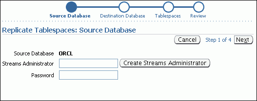

The Oracle Streams Tablespace Replication wizard can configure an Oracle Streams environment that replicates changes to all of the database objects in a particular self-contained tablespace or in a set of self-contained tablespaces. A self-contained tablespace has no references from the tablespace pointing outside of the tablespace. For example, if an index in the tablespace is for a table in a different tablespace, then the tablespace is not self-contained. When there is more than one tablespace in a tablespace set, a self-contained tablespace set has no references from inside the set of tablespaces pointing outside of the set of tablespaces.
This wizard can configure a single-source replication environment or a bi-directional replication environment. This wizard does not configure the Oracle Streams environment to maintain DDL changes to the tablespace set nor to the database objects in the tablespace set. For example, the Oracle Streams environment is not configured to replicate ALTER TABLESPACE statements on the tablespace, nor is it configured to replicate ALTER TABLE statements on tables in the tablespace.
If this wizard configures the replication environment directly (not with scripts), then both databases must be Oracle Database 10g Release 2 or later databases.
If the replication environment is configured with scripts generated by this wizard, then the destination database must be an Oracle Database 10g Release 1 or later database. If the script configures an Oracle Database 10g Release 1 database, then the script must be modified so that it does not configure features that are available only in Oracle Database 10g Release 2 or later, such as queue-to-queue propagation.
Each database configured by this wizard, or the scripts generated by this wizard, must be Oracle Database 10g Release 1 or later database.
This wizard, or the scripts generated by this wizard, must be run at an Oracle Database 10g Release 1 or later database.
If this wizard is run at an Oracle Database 10g Release 2 or later database, and the wizard configures the replication environment directly (not with scripts), then both databases must be Oracle Database 10g Release 2 or later databases.
If this wizard is run at an Oracle Database 10g Release 2 or later database, and the replication environment is configured with generated scripts, then the destination database must be an Oracle Database 10g Release 1 or later database. If the script configures an Oracle Database 10g Release 1 database, then the script must be modified so that it does not configure features that are available only in Oracle Database 10g Release 2 or later, such as queue-to-queue propagation.
Figure 6-2 shows the opening page of the Oracle Streams Tablespace Replication wizard.
Figure 6-2 Oracle Streams Tablespace Replication Wizard

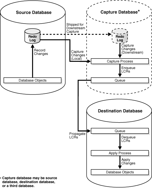

Local capture means that a capture process runs on the source database. Downstream capture means that a capture process runs on a database other than the source database. These procedures can either configure local capture or downstream capture for the database specified in the source_database parameter.
The database that captures changes made to the source database is called the capture database. These procedures can configure one of the following databases as the capture database:
Source database (local capture)
Destination database (downstream capture)
A third database (downstream capture)
Figure 6-3 shows the role of the capture database.
The database on which the procedure is run is configured as the capture database for changes made to the source database. Therefore, to configure local capture at the source database, run the procedure at the source database. To configure downstream capture at the destination database or a third database, run the procedure at the destination database or third database.
If the source database or a third database is the capture database, then these procedures configure a propagation to propagate changes from the capture database to the destination database. If the destination database is the capture database and you are not configuring bi-directional replication, then this propagation between databases is not needed. In this case, the propagation is not configured if the capture_queue_name and apply_queue_name are the same.
Also, the capture_name and capture_queue_name parameters must be set to NULL when both of the following conditions are met:
The destination database is the capture database.
The bi_directional parameter is set to TRUE.
When both of these conditions are met, these procedure configure two capture processes at the destination database, and these capture processes must have different names. When the capture_name and capture_queue_name parameters are set to NULL, the system generates a different name for the capture processes. These procedures raise an error if both conditions are met and either the capture_name parameter or the capture_queue_name parameter is set to a non-NULL value.
When these procedures configure downstream capture, they always configure archived-log downstream capture. These procedures do not configure real-time downstream capture. However, you can configure redo transport services for real-time downstream capture before running a procedure, and then set the downstream_real_time_mine capture process parameter to Y after the procedure completes. You can also modify the scripts generated by these procedures to configure real-time downstream capture.
If these procedures configure bi-directional replication, then the capture process for the destination database always is a local capture process. That is, these procedures always configure the capture process for changes made to the destination database to run on the destination database.

The destination database is the capture database for downstream capture of source database changes.
The RMAN DUPLICATE or CONVERT DATABASE command will be used for database instantiation.
This database link is required because the POST_INSTANTIATION_SETUP procedure with a non-NULL setting for the instantiation_scn parameter runs the SET_GLOBAL_INSTANTIATION_SCN procedure in the DBMS_APPLY_ADM package at the destination database. The SET_GLOBAL_INSTANTIATION_SCN procedure requires the database link. This database link must be created after the RMAN instantiation and before running the POST_INSTANTIATION_SETUP procedure.
If a third database is the capture database for downstream capture of source database changes, then the following database links are also required:
A database link is required from the third database to the source database.
A database link is required from the third database to the destination database.

If you decided to use a local capture process at the source database, then log file transfer is not required. However, if you decided to use downstream capture for the source database, then configure log file transfer from the source database to the capture database before you run the procedure.
Complete the following steps to prepare the source database to transfer its redo log files to the capture database, and to prepare the capture database to accept these redo log files:
Configure Oracle Net so that the source database can communicate with the capture database.
Configure authentication at both databases to support the transfer of redo data.
Redo transport sessions are authenticated using either the Secure Sockets Layer (SSL) protocol or a remote login password file. If the source database has a remote login password file, then copy it to the appropriate directory on the downstream capture database system. The password file must be the same at the source database and the downstream capture database.
