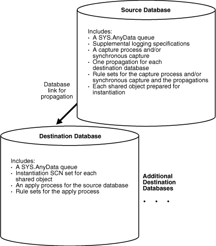

Figure 7-1 shows an example Oracle Streams single-source replication environment.
Figure 7-1 Example Oracle Streams Single-Source Environment
You can create an Oracle Streams environment that is more complicated than the one shown in Figure 7-1. For example, a single-source Oracle Streams environment can use downstream capture and directed networks.
In general, if you are configuring a new Oracle Streams single-source environment in which changes for shared objects are captured at one database and then propagated and applied at remote databases, then you should configure the environment in the following order:

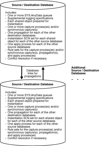

Figure 7-2 shows an example multiple-source Oracle Streams environment.
Figure 7-2 Example Oracle Streams Multiple-Source Environment
You can create an Oracle Streams environment that is more complicated than the one shown in Figure 7-2. For example, a multiple-source Oracle Streams environment can use downstream capture and directed networks.
When there are multiple source databases in an Oracle Streams replication environment, change cycling is possible. Change cycling happens when a change is sent back to the database where it originated. Typically, you should avoid change cycling. Before you configure your replication environment, see Chapter 4, "Oracle Streams Tags", and ensure that you configure the replication environment to avoid change cycling.
