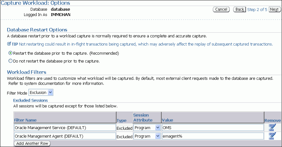

Inclusion filters enable you to specify user sessions that will be captured in the workload. This is useful if you want to capture only a subset of the database workload.
Exclusion filters enable you to specify user sessions that will not be captured in the workload. This is useful if you want to filter out session types that do not need to captured in the workload, such as background processes that may already be running on the test system. For example, if the system where the workload will be replayed is running Oracle Enterprise Manager (EM), replaying captured EM sessions on the system will result in duplication of workload. In this case, you may want to use exclusion filters to filter out EM sessions.

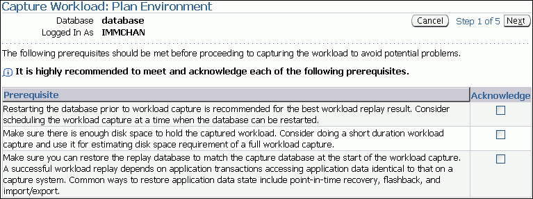

The Capture Workload: Plan Environment page appears.
Verify that all prerequisites are met before proceeding.
For information about the prerequisites, see "Prerequisites for Capturing a Database Workload".
For each verified prerequisite, check the box in the Acknowledge column. Once all prerequisites are verified, click Next.
The Capture Workload: Options page appears.
Select the workload capture options:
Under Database Restart Options, select whether the database will be restarted before workload capture.
It is recommended that the database be restarted before capturing a workload to enable a clean state for workload capture. Otherwise, potential problems may arise when replaying the workload. For more information, see "Restarting the Database".
Under Workload Filters, select whether to use exclusion filters by selecting Exclusion in the Filter Mode list, or inclusion filters by selecting Inclusion in the Filter Mode list.
To add filters, click Add Another Row and enter the filter name, session attribute type, and attribute value in the corresponding fields. For more information, see "Defining the Workload Filters".
After selecting the desired workload capture options, click Next.

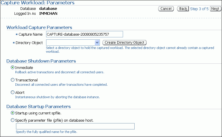

The Capture Workload: Parameters page appears.
Define the parameters for the workload capture:
Under Workload Capture Parameters, in the Capture Name field, enter a name for the workload capture. In the Directory Object list, select the directory where the captured workload will be stored. You must select a directory that does not already contain a workload capture. For more information, see "Setting Up the Capture Directory".
To create a new directory object, click Create Directory Object. The Create Directory Object page appears. In the Name field, enter a name for the directory object. In the Path field, enter the path to the directory object. To test if the directory exists in the file system, click Test File System. If the directory does not exist, it will need to be created first.
Under Database Shutdown Parameters, select the type of database shutdown method to perform. This option only appears if the database will be restarted before workload capture. The types of available database shutdown methods include:
Immediate
An immediate shutdown will roll back all active transactions and disconnect all connected users prior to shutting down the database.
Transactional
A transactional shutdown will first complete all active transactions and then disconnect the connected user prior to shutting down the database.
Abort
An abort shutdown will shut down the database instantaneously by aborting all active transactions.
Under Database Startup Parameters, select if the database will restart using the current default server parameter file (spfile) or a specific parameter file (pfile). To select a pfile, enter the fully qualified name for the pfile. This option only appears if the database will be restarted before workload capture.
After defining the parameters for the workload capture, click Next.

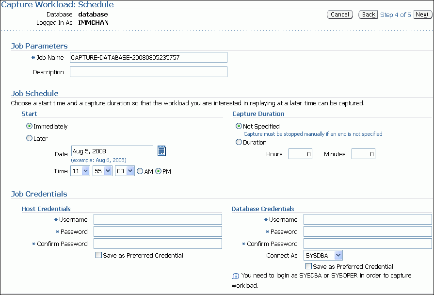

The Capture Workload: Schedule page appears.
Under Job Parameters, define the parameters for the job:
In the Job Name field, enter a name for the job name or accept the system generated name.
In the Description field, enter an optional description of the job.
Under Job Schedule, specify a start time and duration for the workload capture:
Under Start, select whether the job will run immediately by selecting Immediately, or at a later time by selecting Later and specifying the desired time using the Date and Time fields.
Under Capture Duration, specify how long the job will run by selecting Duration and specifying the desired duration using the Hours and Minutes fields. To not specify a capture duration, select Not Specified. If a capture duration is unspecified, the job must be stopped manually.
Under Job Credentials, enter the host and database login credentials:
Under Host Credentials, enter the username and password for the host system.
Under Database Credentials, enter the username and password for the database that will used for the workload capture. The user needs the DBA privilege in order to capture the workload.
Click Next.
The Capture Workload: Review page appears.
Review the job settings for the workload capture that have been defined.
To run the job, click Submit. To make changes, click Back. To cancel the workload capture without saving changes, click Cancel.

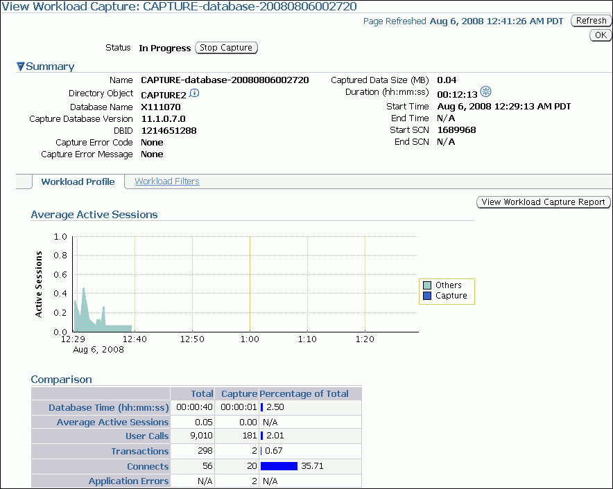

Once workload capture begins, you can monitor the capture process using the View Workload Capture page, as described in "Monitoring Workload Capture Using Enterprise Manager".

This section describes how to monitor an active workload capture using Enterprise Manager.
To monitor an active workload capture:
On the Software and Support page, under Real Application Testing, click Database Replay.
The Database Replay page appears.
Under Active Capture and Replay, select the workload capture you want to monitor and click View.
The View Workload Capture page appears.
Under Summary, information about the workload capture is displayed.
To view the workload profile, click the Workload Profile tab.
Under Average Active Sessions, the Active Sessions chart provides a graphic display of the captured session activity compared to the uncaptured session activity (such as background activities or filtered sessions).
Under Comparison, various statistics for the workload capture are displayed, including database time, average active sessions, user calls, transactions, connects, and application errors. The statistics for the total session activity are displayed in the Total column, and the statistics for the captured session activity are displayed in the Capture column. The Percentage of Total column displays the percentage of total session activity that are being captured in the workload.
To view the workload capture report, click View Workload Capture Report.
To view workload filters used by the workload capture, click the Workload Filters tab.
Details about the workload filters used by the workload capture are displayed, including the workload filter name, type, session attribute, and value.
To return to the Database Replay page, click OK.

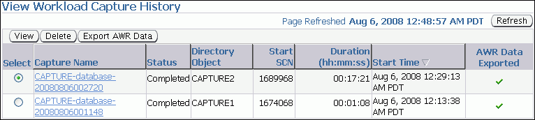

To manage a completed workload capture:
Click View Workload Capture History.
The View Workload Capture History page appears.
To delete a workload capture, select the workload capture and click Delete.
To export AWR data for a workload capture, select the workload capture and click Export AWR Data.
Exporting AWR data enables detailed analysis of the workload. This data is also required if you plan to run the AWR Compare Period report on a pair of workload captures or replays.
To view details about a workload capture, select the workload capture and click View.
