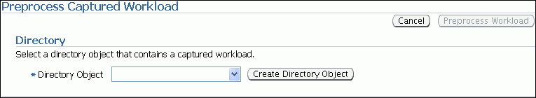

In the Directory Object list, select a directory that contains the captured workload that you want to preprocess.

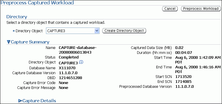

After a directory is selected, the Preprocess Captured Workload page will be refreshed to display the Capture Summary section, which contains information about the captured workload in the selected directory.
To view additional details about the captured workload, expand Capture Details. The expanded Capture Details section displays the workload profile and details for the captured workload.
Click Preprocess Workload.

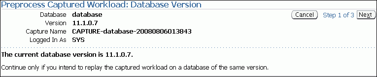

The Preprocess Captured Workload: Database Version page appears.
Ensure that the current database version displayed matches the database version on the intended replay system and click Next.
Preprocessing must be performed on a system that is running the same version of Oracle Database as the replay system.
