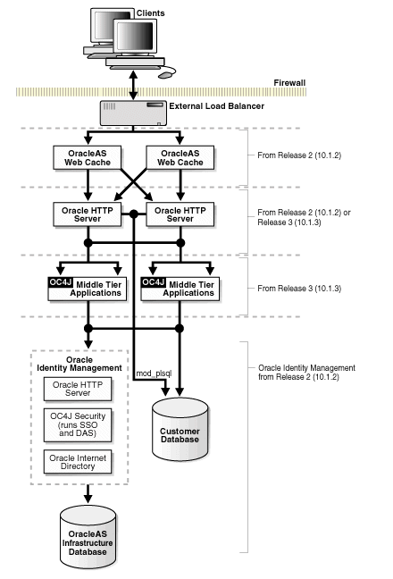

The following figures show two active-active topologies. The difference in the topologies is whether you install Oracle HTTP Server and OC4J in the same Oracle home or in separate Oracle homes.
Figure 3-1 shows an active-active topology with Oracle HTTP Server and OC4J in the same Oracle home. Figure 3-2 shows an active-active topology with Oracle HTTP Server and OC4J in separate Oracle homes.
Figure 3-1 Active-Active Topology with Oracle HTTP Server and OC4J in the Same Oracle Home
Description of Figure 3-1 follows
Description of "Figure 3-1 Active-Active Topology with Oracle HTTP Server and OC4J in the Same Oracle Home"
Figure 3-2 Active-Active Topology with Oracle HTTP Server and OC4J in Separate Oracle Homes
Description of Figure 3-2 follows
Description of "Figure 3-2 Active-Active Topology with Oracle HTTP Server and OC4J in Separate Oracle Homes"

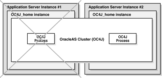

Figure 3-3 shows an OracleAS Cluster (OC4J) configured across two Oracle Application Server instances, with OC4J processes running on each instance. If Oracle Application Server instance 1 fails, the OC4J process on instance 2 contains the session state information and can handle the requests. This configuration enables web application session state replication failover within an OracleAS Cluster (OC4J).
Figure 3-3 Web Application Session State Failover Within an OracleAS Cluster (OC4J)
Description of Figure 3-3 follows
Description of "Figure 3-3 Web Application Session State Failover Within an OracleAS Cluster (OC4J)"
Minimum Number of Instances and Processes Needed
To protect against software or hardware failure while maintaining state with the least number of OC4J processes, you need to configure at least two OC4J processes in the same cluster. For example, if you have two Oracle Application Server instances, instance 1 and instance 2, you can configure two OC4J processes on each instance. With this configuration, stateful session applications are protected against hardware and software failures, and the client maintains state if either of the following types of failures occurs:
  • If one of the OC4J processes fails, then the client request is redirected to the other OC4J process in the same Oracle Application Server instance. State is preserved and the client does not notice any irregularity.
  • If Oracle Application Server instance 1 terminates abnormally, then the client is redirected to an OC4J process on Oracle Application Server instance 2. The state is preserved and the client does not notice any irregularity.

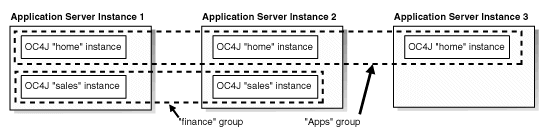

3.1.4 About Groups
By placing OC4J instances in groups, you can perform some common administrative tasks at the group level. For example, from the Group page in Application Server Control, you can perform these tasks on all the members of a group:
  • Process management operations, such as start, stop, or restart
  • Deployment operations, such as deploy, undeploy, and redeploy
  • JDBC management operations, such as creating, modifying, or removing JDBC data sources and connection pools
  • JMS Provider operations, such as creating and removing JMS destinations, and creating, modifying, or removing JMS connection factories
To display the Group page, click the name of a group in the Group section of the Cluster Topology page.
Each OC4J instance must be in a group. A group called "default_group" is created automatically when you install Oracle Application Server.
Figure 3-4 shows three Oracle Application Server instances. Each of these Oracle Application Server instances has an OC4J instance called "home" and they belong to a group called "Apps". The figure also shows that two of the three Oracle Application Server instances have an OC4J instance called "sales", and these OC4J instances belong to a group called "finance".
Figure 3-4 Groups of OC4J Instances
Description of Figure 3-4 follows
Description of "Figure 3-4 Groups of OC4J Instances"
Note that a group does not need to have OC4J instances in all the Oracle Application Server instances in the cluster. For example, in Figure 3-4, the "sales" OC4J instance exists only in two of the Oracle Application Server instances. This is valid.
Oracle Application Server does not enforce that the instances in a group be configured identically. However, you should ensure that some configurations (such as data sources, JMS resources, and security provider settings) are identical so that your applications return the same response to the client regardless of which instance is processing the request.
For more information on groups, see "Guidelines for Creating OC4J Instances and Groups" in the Application Server Control online help.

3.1.6 Using Oracle Identity Management with Active-Active Topologies
Oracle Application Server Release 3 (10.1.3.1.0) does not provide Oracle Identity Management, but you can use Oracle Application Server Release 3 (10.1.3.1.0) with Oracle Identity Management from Release 9.0.4, Release 2 (10.1.2), or Release 10.1.4.
You can associate the active-active topology with Oracle Identity Management, if you need Oracle Identity Management services such as Oracle Internet Directory, OracleAS Single Sign-On, OracleAS Certificate Authority, and Oracle Directory Integration and Provisioning.
You install the Release 3 (10.1.3.1.0) active-active topology and the Oracle Identity Management instances separately. After installation, you use Application Server Control Console to associate the Release 3 (10.1.3.1.0) instances with the Oracle Internet Directory in the Oracle Identity Management.
For instructions on how to associate Oracle Identity Management with Release 3 (10.1.3.1.0) instances, see the section "Configuring Instances to Use 10.1.4, 10.1.2, or 9.0.4 Oracle Identity Management" in the Oracle Application Server Administrator's Guide.
In high availability environments, you need both your Release 3 (10.1.3) instances and your Oracle Identity Management instances to be highly available. This guide describes high availability for the Release 3 (10.1.3) instances only. For high availability for Oracle Identity Management, see the Oracle Application Server High Availability Guide for the Oracle Identity Management release you are using.
Figure 3-7 shows Oracle Application Server Release 3 (10.1.3) instances in an active-active topology running with Oracle Identity Management from Release 2 (10.1.2).
Figure 3-7 Oracle Application Server Middle Tiers with Oracle Identity Management
Description of Figure 3-7 follows
Description of "Figure 3-7 Oracle Application Server Middle Tiers with Oracle Identity Management"
