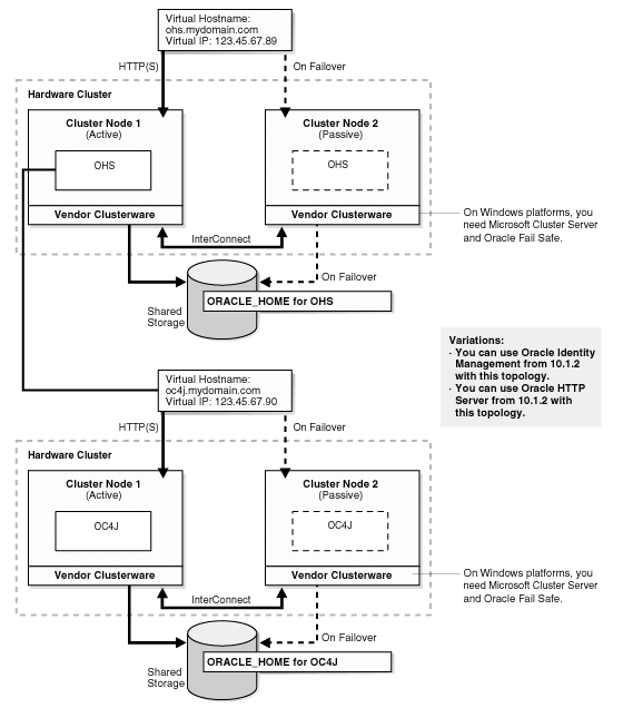

Figure 4-1 shows a diagram of an active-passive topology with the Oracle Application Server Oracle home installed on the shared storage. The Oracle home contains both Oracle HTTP Server and OC4J. Figure 4-2 shows a distributed active-passive topology, where Oracle HTTP Server and OC4Jare installed on different Oracle home.
Figure 4-1 Active-Passive Topology with Oracle HTTP Server and OC4J in the Same Oracle Home
Description of Figure 4-1 follows
Description of "Figure 4-1 Active-Passive Topology with Oracle HTTP Server and OC4J in the Same Oracle Home"
Figure 4-2 Active-Passive Topology with Oracle HTTP Server and OC4J in Separate Oracle Homes
Description of Figure 4-2 follows
Description of "Figure 4-2 Active-Passive Topology with Oracle HTTP Server and OC4J in Separate Oracle Homes"
