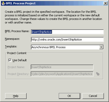

In the BPEL Process Name field, enter a descriptive name. For example, InsertShipNotice.
Specifying a Name for the New BPEL Process Project
From the Template box, select Asynchronous BPEL Process. Keep the default selection for Use Default under Project Content.

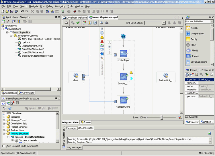

Click OK. A new BPEL process, with the required source files including bpel.xml, InsertShipNotice.bpel, and InsertShipNotice.wsdl is created.
The next task is to add a partner link to the BPEL process. A partner link defines the link name, type, and the role of the BPEL process that interacts with the partner service.
To add a partner link
Drag and drop PartnerLink, from the Component Palette, into the border area of the process diagram. The Create Partner Link dialog box appears.

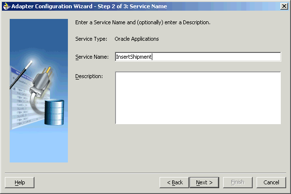

Click Next, and the Service Name dialog box appears.
Enter the following information:
In the Service Name field, enter a service name.
In the Description field, enter a description for the service. This is an optional field. Click Next.
Specifying the Service Name

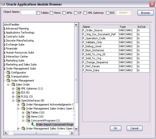

Click Get Object to open the Oracle Applications Module Browser.
Selecting a Concurrent Program from the Module Browser
Oracle Applications Module Browser includes the various product families that are available in Oracle Applications. For example, Applications Technology or Order Management Suite are product families in Oracle Applications. The product families contain the individual products. For example, Order Management Suite contains the Order Management product. The individual products contain the business entities associated with the product. For example, the Order Management product contains the Sales Order business entity.
Business entities contain the various application modules that are exposed for integration. These modules are grouped according to the interface they provide. concurrent programs can be found under the OpenIntefaces category.
Select a concurrent program, and then click OK. You can select only one concurrent program for each adapter service.
Note: You can also search for a concurrent program by entering the name of the program in the Object Name field. Select the CP check box, and then click Search.
The concurrent program is added to Operation Objects. Click Next in the Operation dialog box.

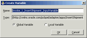

Click the Create icon next to the Input Variable field. Enter a descriptive name for the variable in the Create Variable dialog box that appears. You can also accept the default name. Click OK.
Creating the Input Variable

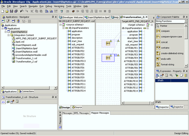

Select the Source Variable and Target Variable from the respective boxes. Elements are mapped from the Source Variable to the Target Variable.
Select the Source Part of the variable from which to map elements. For example, the source part may be a payload schema consisting of a purchase order request.
Select the Target Part of the variable to which to map elements. For example, the target part may be a payload schema consisting of a purchase order acknowledgment.
Mapper File specifies the file in which you create the mappings using the XSLT Mapper Transformation tool. Click the Create icon next to the Mapper File field to create a new transformation mapping file.
The transformation mapping file appears.
The Design view for the transformation mapping file appears by default.
Editing the Transformation Mapping File
You can define the parameter values in the Design view. Drag a string function to the Design area. Connect the function to the appropriate parameter for which you want to define a value.
Note: You can use an input parameter value from the source variable, transform it using a string function, and then use it as the input parameter value for the target variable.
Double-click the icon for the function. The Edit Function dialog box appears.
Supplying the Function Parameters
Repeat steps 8 and 9 for all the parameters that you must supply.

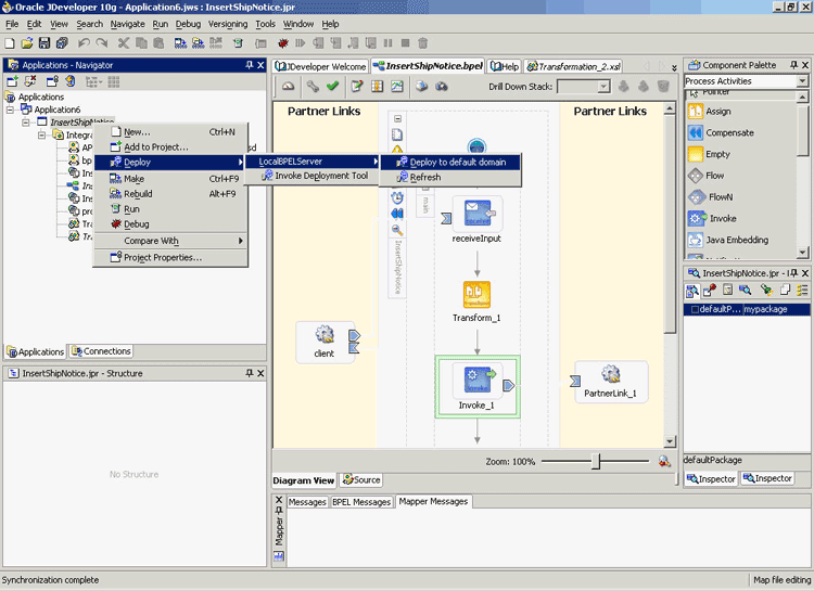

You must deploy the BPEL process before you can run it. The BPEL process is first compiled, and then deployed to the BPEL server.
To deploy the BPEL process
Select the BPEL project in the Applications window.
Right-click the project name, then select Deploy from the menu that appears.
If you are deploying the process on the local BPEL server, select Local BPEL Server, followed by Deploy to Default Domain.
Deploying the BPEL Process
Note: If you want to deploy to a different BPEL server, select Invoke Deployment Tool.
The Password Prompt dialog box appears. Enter the password for the default domain in the Domain Password field, and then click OK.
Specifying the Domain Password
The BPEL process is compiled and deployed. You can check the progress in the Messages window.

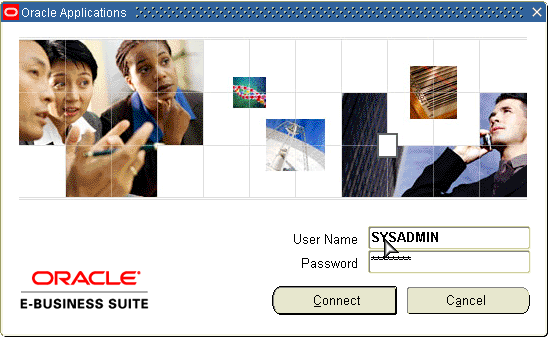

Log in to Oracle Applications as the System Administrator.
Oracle Applications Login Dialog Box

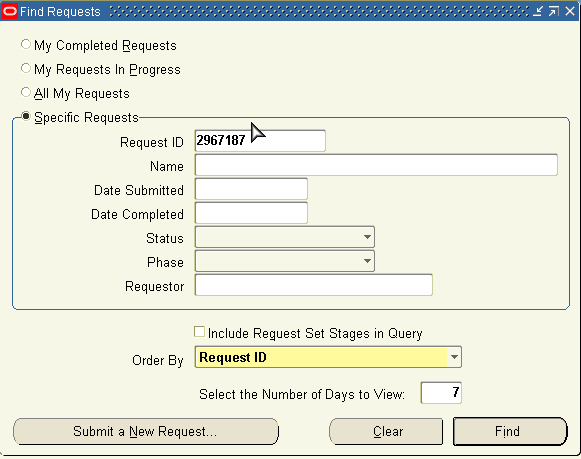

Search for the Request by entering the Request Id that you got from the audit trail, then click Find.
Find Requests Dialog Box
The Request details are displayed. You can check for details such as the Phase and Status of the request.

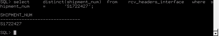

If the Status of the request is Complete, you can also query the appropriate table in Oracle Applications to search for the relevant records that have been inserted.
Querying Oracle Applications for a Record
