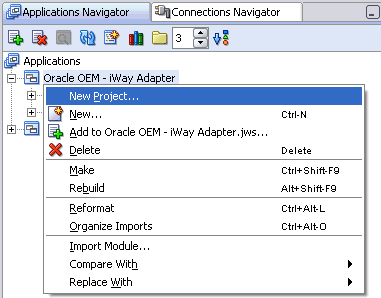

  1. At the top of the upper left pane, click the Applications Navigator tab and select an application.
    Workspaces list in JDeveloper
  2. Right-click the application and select New Project.

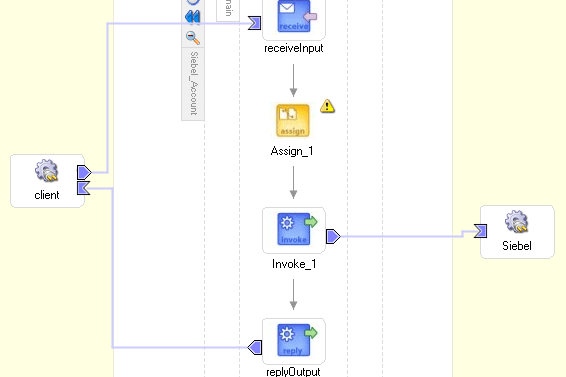

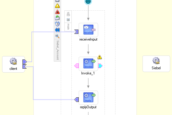

  7. From the Process Activities pane on the right, drag an Invoke activity to the visual editor and place it between the Receive activity (receiveInput) and the Reply activity (replyOutput).
    The Invoke process activity is shown in the following diagram view.
    Diagram view showing Invoke process activity
  8. Drag the right arrow from Invoke_1 and connect it to the Siebel PartnerLink.
    The Edit Invoke dialog box is displayed.
    Perform the following steps:
    1. Click the first icon to the right of the Input Variable field, then click OK in the Create Variable window that is displayed.
    2. Repeat the previous step to create a default variable for Output Variable.
  9. Click OK.
  10. Drag an Assign process activity and drop it between the receiveInput Receive activity and Invoke_1 Invoke activity.
    The following image shows the new Assign activity in JDeveloper visual editor.
    JDeveloper diagram view showing new process activities

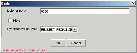

    The Basic dialog box is displayed.
    Basic dialog box
  5. Enter a port number in the Listener port field.
  6. Leave the default synchronization type.
  7. Click OK.
    The New Gallery dialog box is displayed.

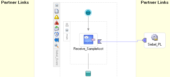

  10. From the Process Activities pane on the right, drag a Receive activity to the visual editor and place it in the designated placeholder labeled Drop Activity Here.
  11. Connect the Receive activity to the Siebel_PL PartnerLink.
    The Edit Receive dialog box is displayed.
    1. Specify a name for the Receive Activity, for example, Receive_SampleAcct.
    2. Click the first icon to the right of the Variable field, then click OK in the Create Variable dialog box that is displayed.
    3. Verify that the Create Instance check box is selected.
  12. Click Apply.
    The Edit Receive dialog box should no longer display any warnings or errors.
  13. Click OK.
  14. Select Save from the File menu.
    The completed inbound BPEL process looks as follows:
    Completed BPEL process shown in diagram view

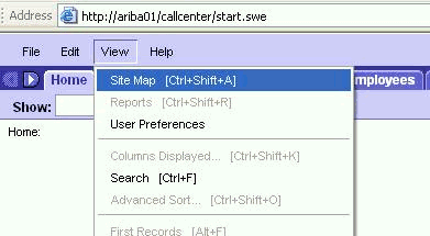

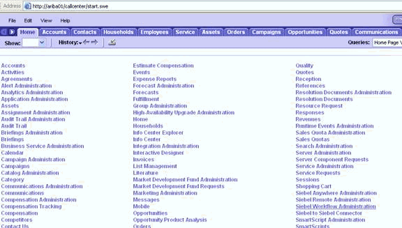

  2. Click View and select Site Map from the list.
    The Site Map view is displayed.
    Site Map View
  3. Click Siebel Workflow Administration.
    The Siebel Workflow Administration page is displayed.

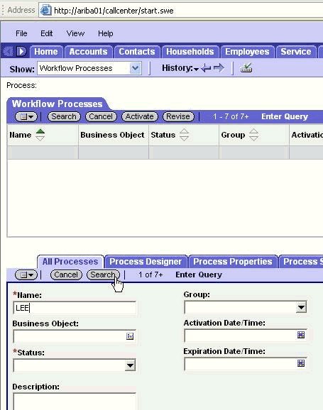

  4. Click Workflow Processes.
    The Workflow Processes page is displayed.
    Workflow Processes

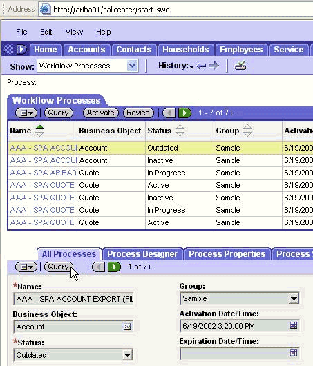

  5. Click Query to search for the Workflow needed to trigger a Siebel event.
    Workflow Processes

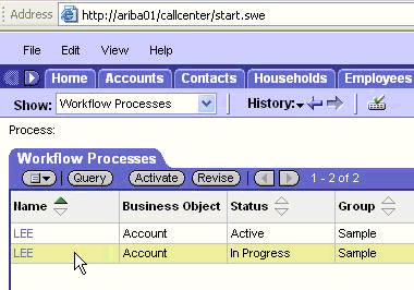

  6. Enter a Siebel workflow name and click Search.
    Workflow Processes

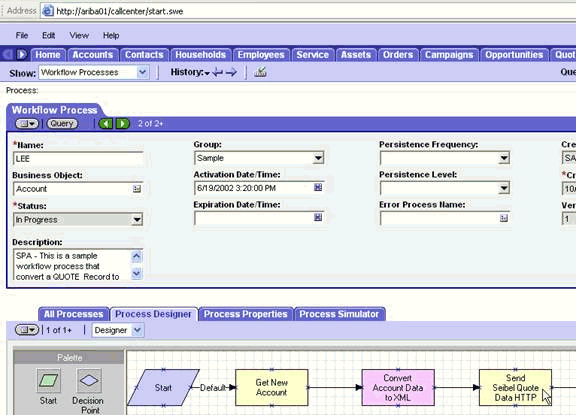

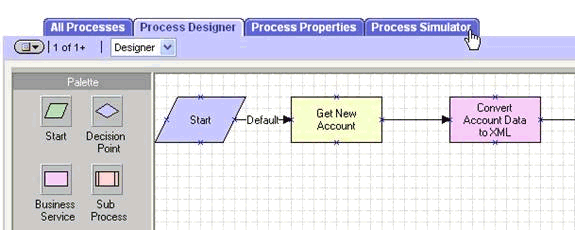

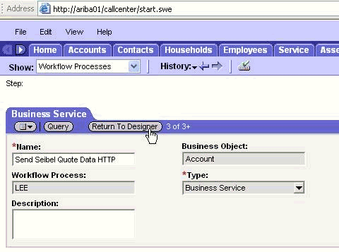

  7. Select the workflow.
    Process Designer tab
  8. Click the Process Designer tab and double-click the Send Siebel Quote Data HTTP workflow element.

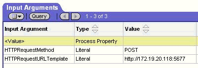

    The Input Arguments tab is displayed.
    Input Arguments tab
  9. Enter the IP address and port for the HTTPRequestURLTemplate input argument.
  10. Click Return To Designer.

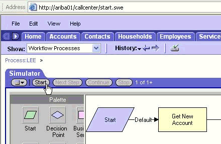

  11. Click the Process Simulator tab.
    The Simulator tab is displayed.
    Simulator tab
  12. Click Start then Continue to complete the Siebel event triggering process.

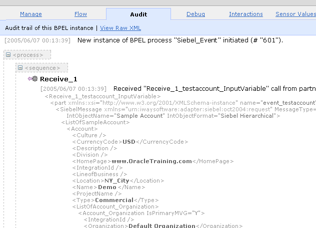

Verifying the Results
To verify your results:
  1. Log in to Oracle BPEL Console at
    http://host:port/BPELConsole
  2. Provide a valid user name and password.
  3. Click the Instances tab.
    Recently received runtime events are displayed in the Instances tab.
    Instances tab
  4. Click the Siebel instance, then click Audit to see the event message.
    The message received from the Siebel system is displayed in the Audit tab.
