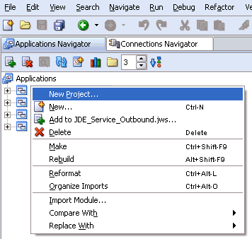

At the top of the upper left pane, click the Applications Navigator tab.
Right-click an application node that you created and select New Project.

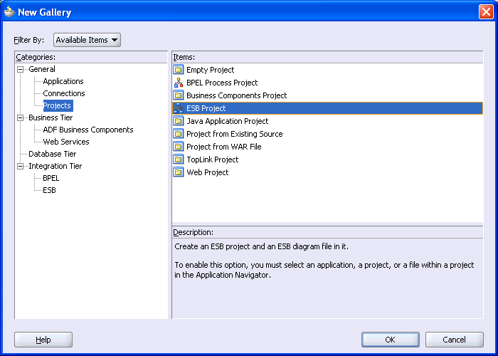

The New Gallery window is displayed.

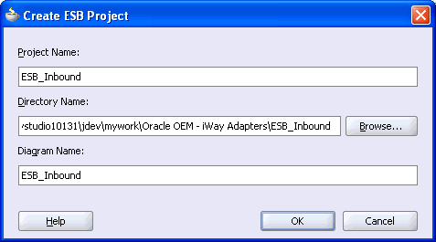

From the Items list, select ESB Project Project and click OK.
The Create ESB Project dialog box is displayed.
Perform the following steps:
Specify a name for the ESB project.
The Directory Name field and Diagram Name fields are updated automatically.
Click OK.
The ESB project is added at the top of the upper left pane.

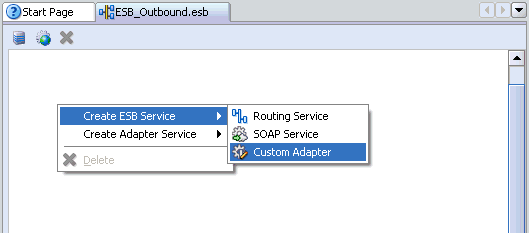

Right-click the ESB project in the middle pane, select Create ESB Service followed by Custom Adapter.

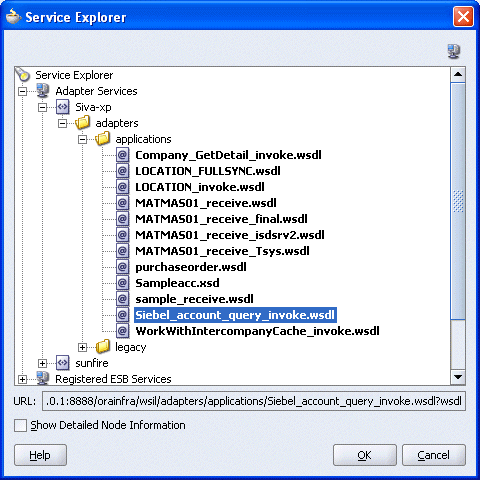

Enter a name for the adapter service and click the Service Explorer icon (second icon from the left preceding the WSDL File field).

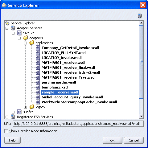

The Service Explorer dialog box is displayed.
Expand your new connection under Adapter Services, followed by adapters, and then applications.
The WSDL tree displayed in the Service Explorer dialog box lists any WSDL files you have created using Application Explorer. The WSDL tree is generated by a WSDL servlet, which is automatically deployed as part of the BPEL Server installation.
Select an outbound WSDL file that has been created using Application Explorer and click OK.
The WSDL File field in the Create Adapter Service dialog box displays the name and location of the selected WSDL file.

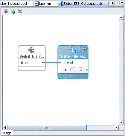

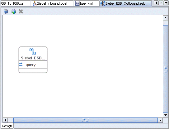

The new ESB project appears in the visual editor.

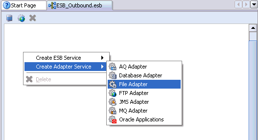

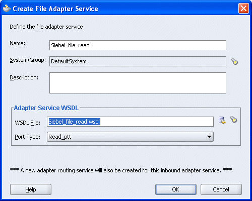

Right-click the ESB project in the middle pane, select Create Adapter Service followed by File Adapter.
The Create File Adapter Service dialog box is displayed.
Enter a name for the File adapter and click the Configure adapter service wsdl icon next to the WSDL File field.

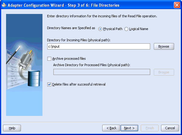

The Adapter Configuration Wizard - Step 3 of 6: File Directories window is displayed.
Enter the path of the input directory where you are placing the incoming XML file and click Next.

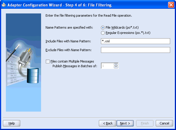

The Adapter Configuration Wizard - Step 4 of 6: File Filtering window is displayed.
Enter the input file extension, for example *.xml, and click Next.

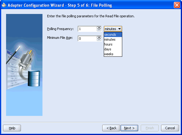

The Adapter Configuration Wizard - Step 5 of 6: File Polling window is displayed.
Change the Polling Frequency to seconds and click Next.

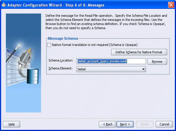

The Adapter Configuration Wizard - Step 6 of 6: Messages window is displayed.

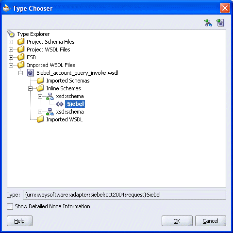

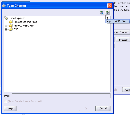

Click Browse to select the WSDL.

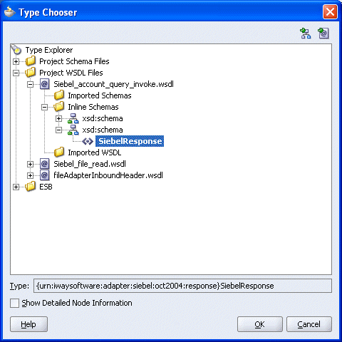

The Type Chooser window is displayed.

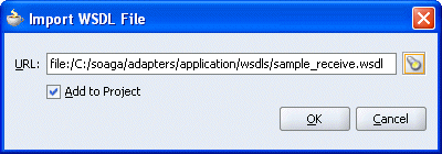

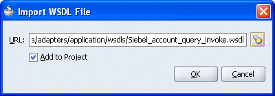

Click the Import WSDL File icon on the upper right corner of the dialog box.
The Import WSDL File dialog box is displayed.
Select the WSDL file and click OK.
The Imported WSDL Files folder is added.
Expand the Imported WSDL Files folder, select an Inline Schema, for example, PS8, and click OK.
You are returned to the Adapter Configuration Wizard - Step 6 of 6: Messages window.
Click Next.

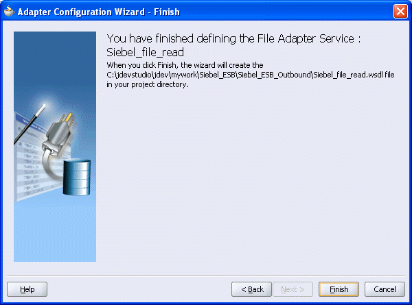

The Adapter Configuration Wizard - Finish window is displayed.
Click Finish.
You are returned to the Create File Adapter Service dialog box.
Click OK.

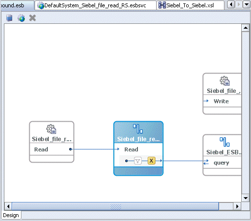

The Read operation with a routing service is added to the ESB outbound project view.

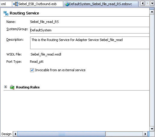

Providing a Routing Service for the Read Operation

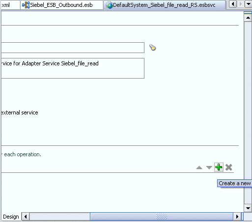

Double-click the routing service.
The Routing Service window is displayed.
Expand the Routing Rules.
Click the green plus sign icon, which represents the option to Create a new Routing Rule.

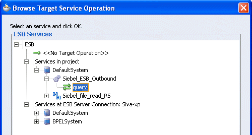

The Browse Target Service Operation window opens.
Expand Services in project, Default System, your adapter service node, for example, CARRIER, and select the service name, for example, CARRIER.
Click OK.
You are returned to the Routing Rules window.

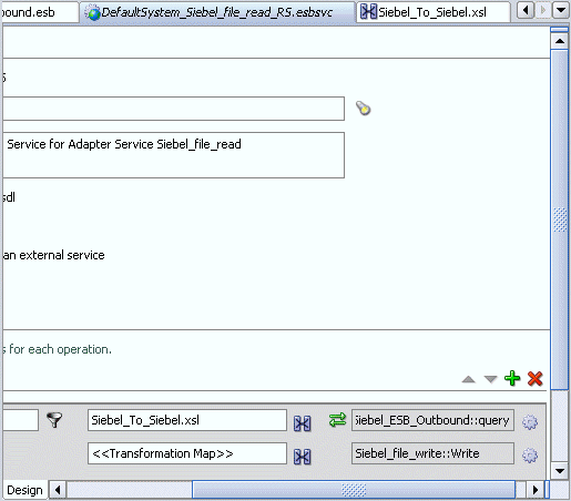

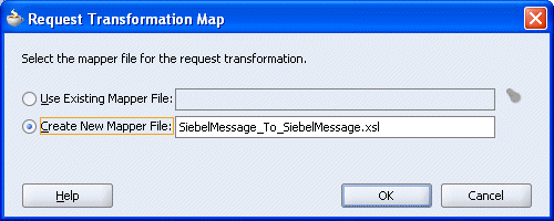

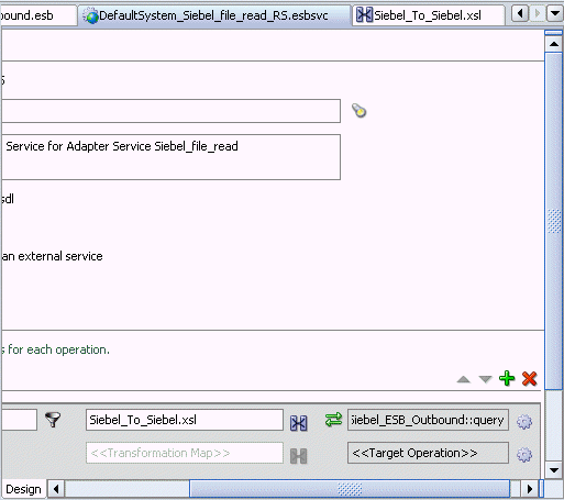

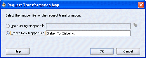

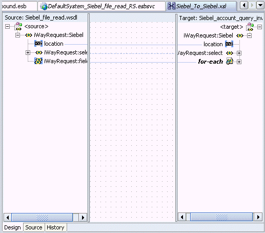

Click on the icon next to the <<Transformation Map>> field (Select an existing mapper file or create a new one).
The Request Transformation Map dialog box is displayed.
Select the Create New Mapper File option, specify the file name, and click OK.

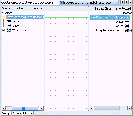

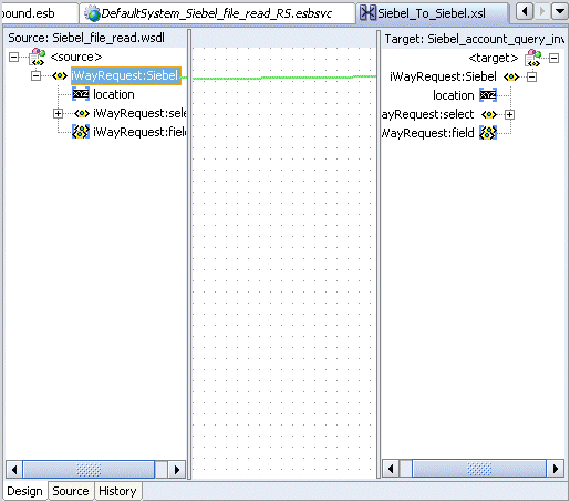

The following mapping window is displayed.
Select the WSDL file and map it to the Write operation.

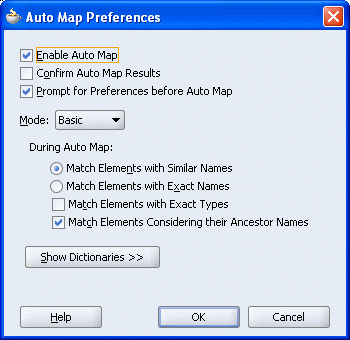

Once you map the WSDL file, the Auto Map Preferences dialog box is displayed.
Click OK.
The mapping is completed as shown in the following window.

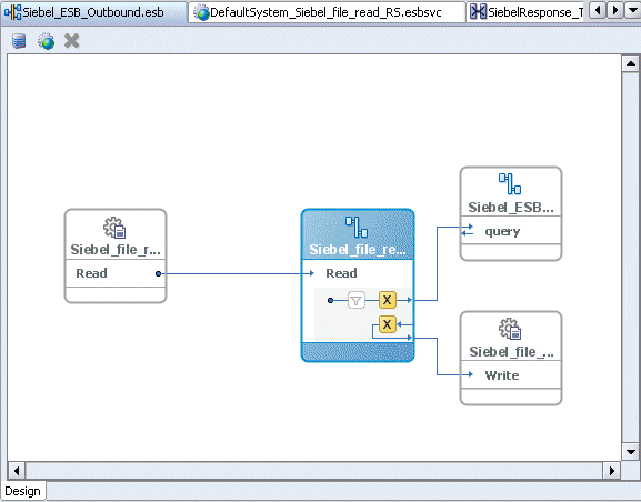

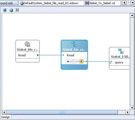

Double-click the ESB outbound project file in the left pane, for example, ESB_Outbound.esb.
Notice that the Routing service is now created for the Read operation.

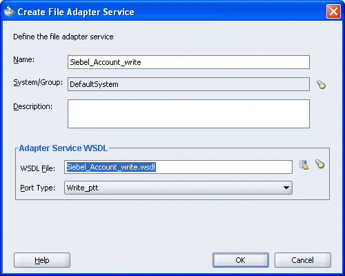

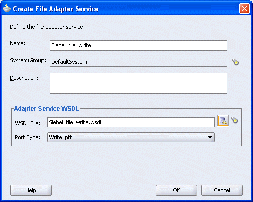

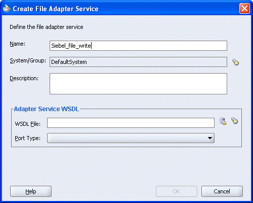

The Adapter Configuration Wizard - Welcome window is displayed.
Click Next.
The Adapter Configuration Wizard - Step 1 of 4: Service Name window is displayed.
Click Next.

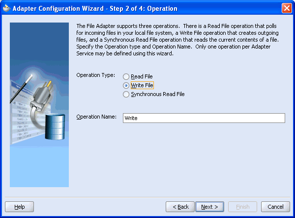

The Adapter Configuration Wizard - Step 2 of 4: Operation window is displayed.

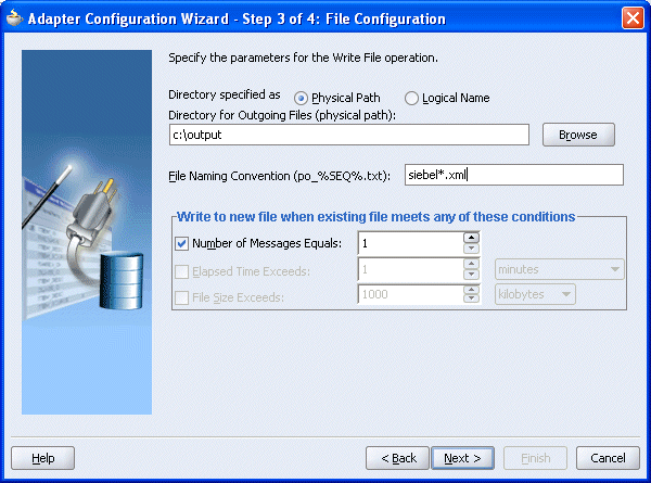

Click Write File as the Operation Type and click Next.
The Adapter Configuration Wizard - Step 3 of 4: File Configuration window is displayed.

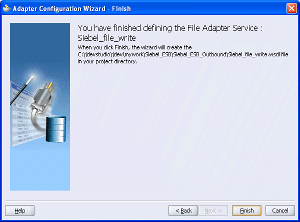

Enter the path of the output directory and name of the output file and click Next.

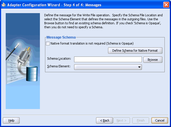

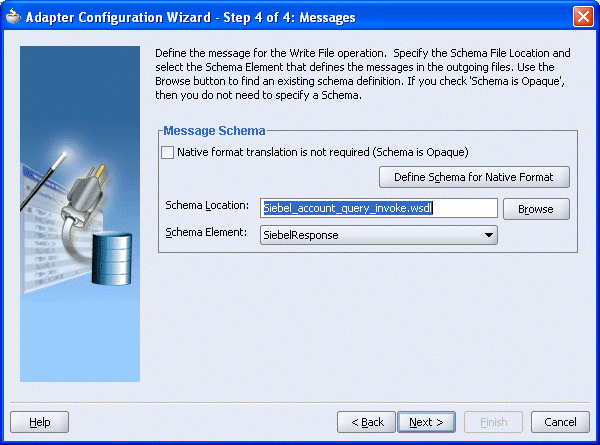

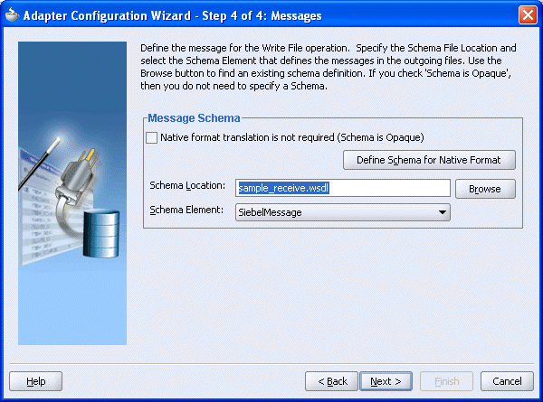

The Adapter Configuration Wizard - Step 4 of 4: Messages window is displayed.

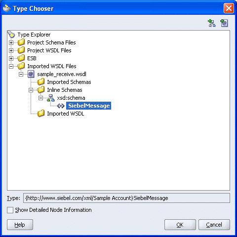

Expand the Project WSDL Files folder, select an Inline Schema, for example, PS8, and click OK.
You are returned to the Adapter Configuration Wizard - Step 4 of 4: Messages window.
Click Next.

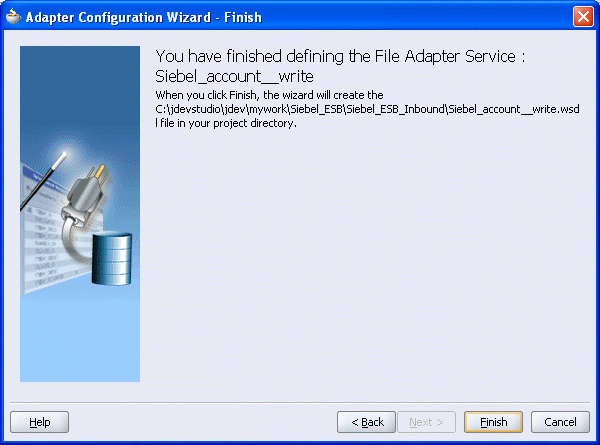

Click Finish.
Click OK.
The Write operation is added to the ESB outbound project view.

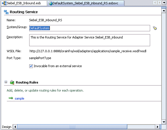

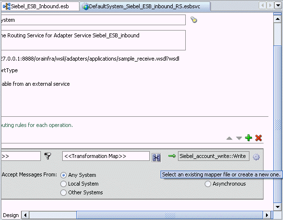

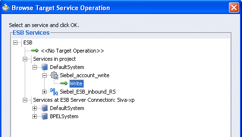

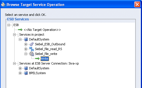

Click on the icon next to the <<Target Operation>> field (Browse for target service operations).
Expand Services in project, Default System, your adapter service node, for example, write_operation, and select the service name, for example, Write.
Click OK.

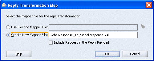

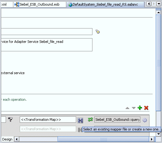

The Reply Transformation Map dialog box is displayed.

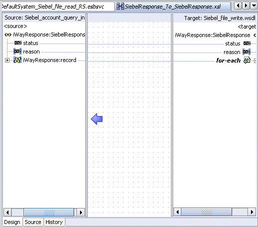

Click OK.
Notice that the Routing service is now created for the Write operation.

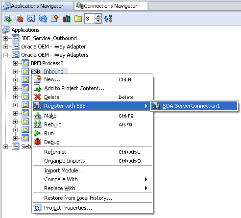

Deploying the Project

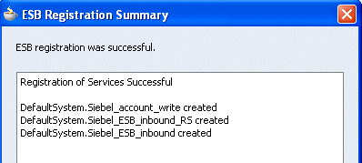

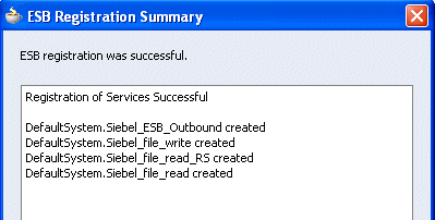

Right-click the created project, for example, ESB_Outbound, select Register with ESB, and the server connection, for example, ServerConnection1.
After successful deployment, the Registration of services Successful message is displayed.

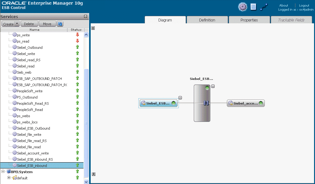

Logon to the ESB Control console to check whether the project has been successfully deployed.
The deployed process is listed under the Default System node.

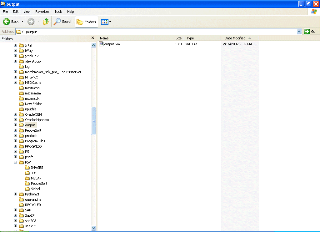

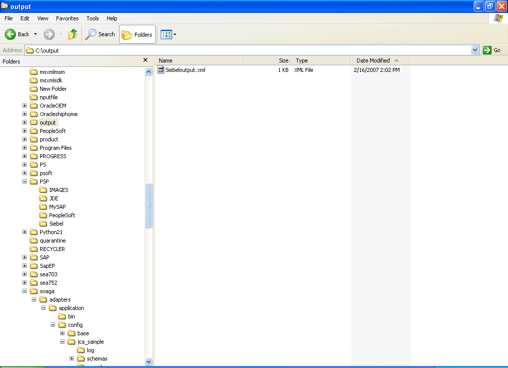

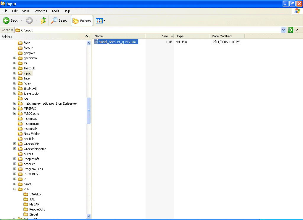

Place the XML file in the folder that you specified during the creation of the Read operation.
Check whether you are receiving the response in the output folder, which you have specified during the creation of the write operation and also the corresponding instance in the ESB Control console.
If the response is not received in the output folder, check the instance and the logs for the corresponding errors in the ESB Control console.
Click OK.

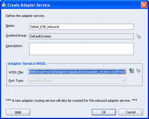

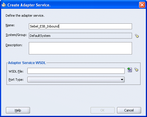

The Create Adapter Service dialog box is displayed.
Select an inbound WSDL file that has been created using Application Explorer and click OK.
Click OK.

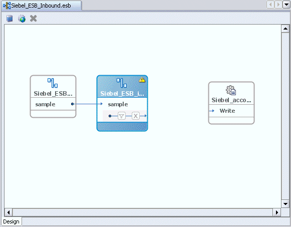

Creating a Write Process Operation Using the File Adapter
Expand the Imported WSDL Files folder, select an Inline Schema, for example, DEBMAS05, and click OK.
Click Next.
Click Finish.
Click OK.
The Write operation with a routing service is added to the ESB inbound project view.
Providing a Routing Service for the Write Operation

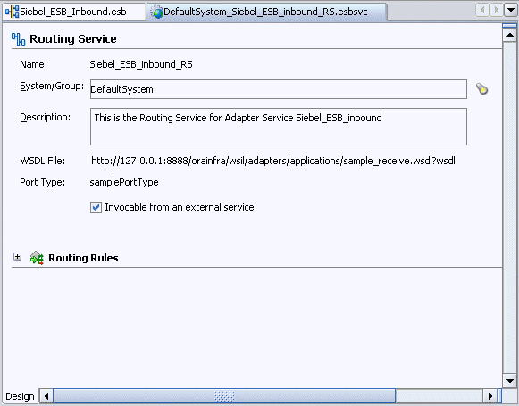

Expand Services in project, Default System, your adapter service node, for example, ESB_write, and select the service name, for example, Write.
Click OK.

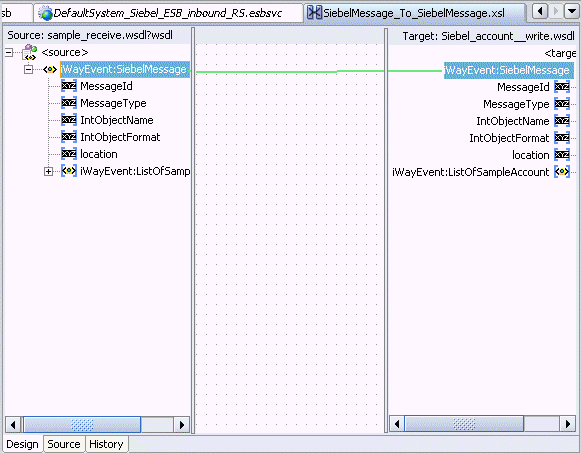

Click OK.
The mapping is completed.
Notice that the Routing service is now created for the Write operation in the middle pane.
Right-click the created project, for example, ESB_Inbound, select Register with ESB, and the server connection, for example, ServerConnection1.
Trigger the event.
Check whether you are receiving the response in the output folder, which you have specified during the creation of the write operation.
