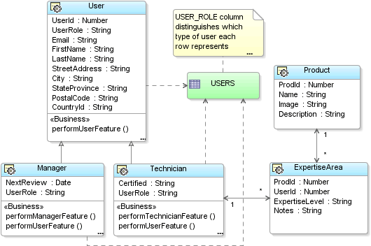

Figure 26-2 shows what the business domain layer would look like if you created distinct User
, Manager
, and Technician
entity objects to allow distinguishing the different kinds of business information in a more formal way inside your application. Since technicians and managers are special kinds of users, their corresponding entity objects would extend the base User
entity object. This base User
entity object contains all of the attributes and methods that are common to all types of users. The performUserFeature()
method in the figure represents one of these common methods.
Then, for the Manager
and Technician
entity objects you can add specific additional attributes and methods that are unique to that kind of user. For example, in the figure, Manager
has an additional NextReview
attribute of type Date
to track when the manager must next review his employees. There is also a performManagerFeature()
method that is specific to managers. Similarly, the Technician
entity object has an additional Certified
attribute to track whether the technician has completed training certification. The performTechnicianFeature()
is a method that is specific to technicians. Finally, also note that since expertise areas only are relevant for technicians, the association between "users" and expertise levels is defined between Technician
and ExpertiseArea
By modeling these different kinds of users as distinct entity objects in an inheritance hierarchy in your domain business layer, you can simplify having them share common data and behavior and implement the aspects of the application that make them distinct.

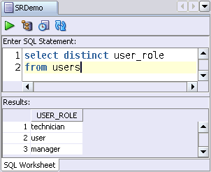

Next, determine the valid values that the descriminator column takes on in your table. You might know this off the top of your head, or you could execute a simple SQL statement in the JDeveloper SQL Worksheet to determine the answer. To access the worksheet:
Choose View | Connection Navigator.
Expand the Database folder and select the SRDemo
connection.
Choose SQL Worksheet from the right-mouse context menu.
Figure 26-3 shows the results of performing a SELECT DISTINCT
query in the SQL Worksheet on the USER_ROLE
column in the USERS
table. It confirms that the rows are partitioned into three groups based on the USER_ROLE
discriminator values: user
, technician
, and manager
