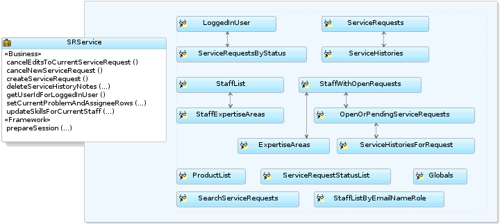

Figure 10-3 shows the SRService
application module that implements the business service layer of the SRDemo application. Notice that its data model includes numerous view object instances, including several master/detail hierarchies. The view layer of the demo consists of JSF pages whose UI components are bound to data from the view object instances in the SRService
's active data model, and to built-in operations and service methods on its client interface. In Section 10.6, "Overview of How SRDemo Pages Use the SRService", you'll find an overview of exactly what aspects of this application module each page uses.

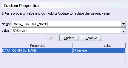

. To change the default data control name to a shorter, or simply more preferable name, do the following:
To change the application module name:
Open the application module in the Application Module Editor.
Open the Custom Properties page.
In the Name combobox, select the DATA_CONTROL_NAME
property from the dropdown list.
Enter your preferred data control name in the Value field and click OK to close the wizard.
Figure 10-4 shows the custom property setting that changed the data control name of the SRService
from the default SRServiceDataControl
to the shorter SRService
name that matches the name of the application module. You'll notice the change immediately in the Data Control Palette.

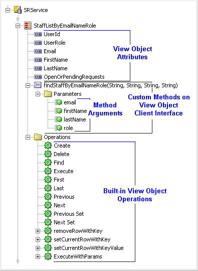

Figure 10-7 shows how each view object instance in the application module's data model appears in the Data Control Palette. The view object attributes are displayed as immediate child nodes of the corresponding data collection. If you have selected any custom methods to appear on the view object's client interface, like the performSearch()
method in the figure, they appear as custom operations immediately following the view object attribute at the same level. If the method accepts arguments, these appear in a nested Parameters folder as operation parameters.
As shown in Figure 10-7, the Operations folder under the data collection displays all its available built-in operations. If an operation accepts one or more parameters, then they appear in a nested Parameters folder. At runtime, when one of these data collection operations is invoked by name by the data binding layer, the application module data control delegates the call to an appropriate method on the ViewObject
interface to handle the built-in functionality. The built-in operations fall into three categories: operations that affect the current row, operations that refresh the data collection, and all other operations.

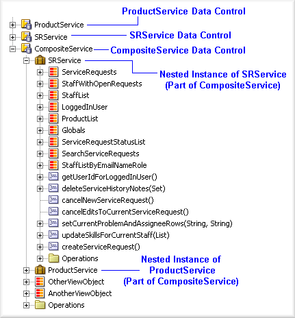

If you build composite application modules, by including nested instances of other application modules, the Data Control Palette reflects this component assembly in the tree hierarchy. For example, assume that in addition to the SRDemo application's oracle.srdemo.model.SRService
application module that you have also created the following application modules in the same package:
An application module named ProductService
, and renamed its data control to ProductService
An application module named CompositeService
, and renamed its data control to CompositeService
Then assume that you've added two view object instances named OtherViewObject
and AnotherViewObject
to the data model of CompositeService
and that on Application Modules page of the Application Module Editor you have added an instance of the SRService
application module and an instance of the ProductMaintenance
application module to reuse them as part of CompositeService
. Figure 10-8 illustrates how your CompositeService
would appear in the Data Control Palette. The nested instances of SRService and ProductService appear in the palette tree display nested inside of the CompositeService
data control. The entire data model and set of client methods that the nested application module instances expose to clients are automatically available as part of the CompositeService
that reuses them.
One possibly confusing point is that even though you have reused nested instances of SRService
and ProductService
inside of CompositeService
, the SRService
and ProductService
application modules also appear themselves as top-level data control nodes in the palette tree. JDeveloper assumes that you might want to sometimes use SRService
or ProductService
on their own as a separate data controls from CompositeService
, so it displays all three of them. You need to be careful to perform your drag and drop data binding from the correct data control. If you want your page to use a view object instance from the nested SRService
instance's data model that is an aggregated part of the CompositeService
data control, then ensure you select the data collection that appears as part of the CompositeService
data control node in the palette.
It is important to do the drag and drop operation that corresponds to your intended usage. When you drop a data collection from the top-level SRService
data control node in the palette, at runtime your page will use an instance of the SRService
application module acquired from a pool of SRService
components. When you drop a data collection from the nested instance of SRService
that is part of CompositeService
, at runtime your page will use an instance of the CompositeService
application module acquired from a pool of CompositeService
components. Since different types of application module data controls will have distinct transactions and database connections, inadvertently mixing and matching data collections from both a nested application module and a top-level data control will lead to unexpected runtime behavior. Forewarned is forearmed.
