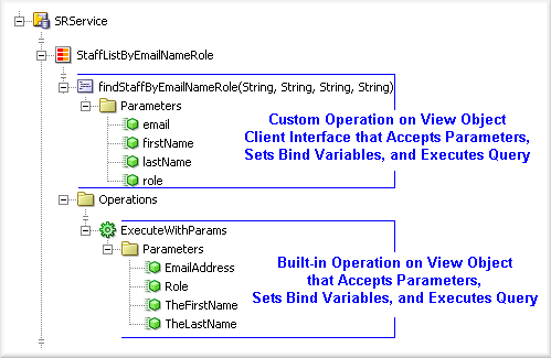

10.5.2 How to Work with Named View Object Bind Variables
When a view object has named bind variables, an additional ExecuteWithParams operation appears in the corresponding data collection's Operations folder. As shown in Figure 10-9, this built-in operation accepts one parameter corresponding to each named bind variable. For example, the StaffListByEmailNameRole view object in the figure has four named bind variables — EmailAddress, Role, TheFirstName, and TheLastName — so the parameters appear for the ExecuteWithParams action having these same names. At runtime, when the ExecuteWithParams built-in operation is invoked by name by the data binding layer, each named bind variable value is set to the respective parameter value passed by the binding layer, and then the view object's query is executed to refresh its row set of results.
Figure 10-9 Work with Named Bind Variables Using Either a Built-in or Custom Operation
Image shows ways of working wtih named bind variables
An alternative approach, also shown in Figure 10-9, involves creating a custom view object "finder" method that accepts the arguments you want to allow the user to set and then including this method on the client interface of the view object in the View Object Editor. Example 10-1 shows what the code for such a custom method would look like. It is taken from the StaffListByEmailNameRole view object in the SRDemo application. Notice that due to the application module's active data model, the method does not need to return the data to the client. The method has a void return type, sets the bind variable values to the parameter values passed into the method using the generated bind variable accessor methods setEmailAddress(), setRole(), setTheFirstName(), and setTheLastName(). Then, it calls executeQuery() to execute the query to refresh the view object's row set of results.
Example 10-1 Custom View Object Method Sets Named Bind Variables and Executes Query

Both of these approaches accomplish the same end result. Both can be used with equal ease from the Data Control Palette to create a search form. The key differences between the approaches are the following:
Using the built-in ExecuteWithParams operation
  • You don't need to write code since it's a built-in feature.
  • You can drop the operation from the Data Control Palette to create an ADF Search Form to allow users to search the view object on the named bind variable values.
  • Your search fields corresponding to the named bind variables inherit bind variables UI control hints for their label text that you can define as part of the view object component.
Using the custom View Object "finder" operation
  • You need to write a little custom code, but you see a top-level operation in the Data Control Palette whose name can help clarify the intent of the find operation.
  • You can drop the custom operation from the Data Control Palette to create an ADF Search Form to allow users to search the view object on the parameter values.
  • Your search fields corresponding to the method arguments do not inherit label text UI control hints you define on the view object's named bind variables themselves. Instead, you need to define UI control hints for their label text by using the Properties... choice from the context menu of the page definition variable corresponding to the method argument as shown in Figure 10-10.

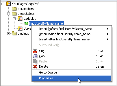

Figure 10-10 Accessing Properties of Page Definition Variables to Set UI Control Hints
Image of context menus in Application Navigator
In short, it's good to be aware of both approaches and you can decide for yourself which approach you prefer. As described in Section 10.6.5, "The SRStaffSearch Page", while the StaffListByEmailNameRole view object contains the above findStaffByEmailNameRole() custom method for educational purposes, the demo's JSF page uses the declarative ExecuteWithParams built-in action.

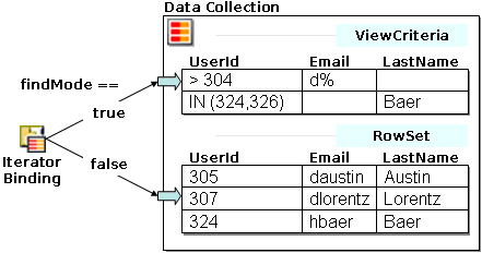

In the ADF Model layer, an iterator binding supports a feature called "find mode" when working with data collections that support query-by-example. As cited in Section 5.8, "Filtering Results Using Query-By-Example View Criteria", view objects support query-by-example when view criteria row set of view criteria rows has been applied. The view criteria rows have the same structure as the rows in the view object, but the datatype of each attribute is String to allow criteria like "> 304" or "IN (314,326)" to be entered as search criteria.
In support of the find mode feature, an iterator binding has a boolean findMode property that defaults to false. As shown in Figure 10-11, when findMode is false the iterator binding points at the row set containing the rows of data in the data collection. In contrast, when you set findMode to true the iterator binding switches to point at the row set of view criteria rows.
Figure 10-11 When Find Mode is True, Iterator Binding Points at ViewCriteria Row Set Instead
Image describes ADF Find Mode feature
In the binding layer, action bindings that invoke built-in data control operations are associated to an iterator binding in the page definition metadata. This enables the binding layer to apply an operation like Create or Delete, for example, to the correct data collection at runtime. When an operation like Create or Delete is invoked for an iterator binding that has findMode set to false, these operations affect the row set containing the data. In contrast, if the operations are invoked for an iterator binding that has findMode set to true, then they affect the row set containing the view criteria row, effectively creating or deleting a row of query-by-example criteria.
The built-in Find operation allows you to toggle an iterator binding's findMode flag. If an iterator binding's findMode is false, invoking the Find operation for that iterator binding sets the flag to true. The UI components that are bound to attribute bindings related to this iterator switch accordingly to displaying the current view criteria row in the view criteria row set. If the user modifies the values of UI components while their related iterator is in find mode, the values are applied to the view criteria row in the view criteria row set. If you invoke the Execute or ExecuteWithParams built-in operation on an iterator that is in find mode, each will first toggle find mode to false, apply the find mode criteria, and refresh the data collection.
If an iterator binding's findMode is true invoking the Find operation sets it to false and removes the view criteria rows in the view criteria row set. This effectively cancels the query-by-example mode.

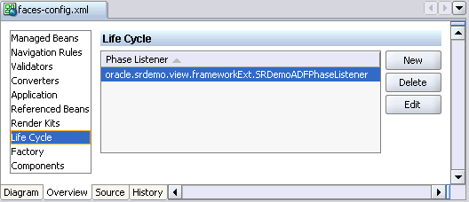

  • Change your faces-config.xml file to use your subclass of ADFPhaseListener instead of the default ADFPhaseListener. As shown in Figure 10-12, you can do this on the Overview tab of the JDeveloper faces-config.xml editor, in the Life Cycle category.
Make sure to replace the existing ADFPhaseListener with your custom subclass of ADFPhaseListener, or everything in the JSF / ADF lifecycle coordination will happen twice!
Figure 10-12 Setting Up a Custom ADFPhaseListener To Install a Custom Page Lifecycle Globally
Image of faces-config.xml editor
The SRDemo application includes a SRDemoPageLifecycle class that globally overrides the reportErrors() method of the page lifecycle to change the default way that exceptions caught and cached by the ADF Model layer are reported to JSF. The changed implementation reduces the exceptions reported to the user to include only the exceptions that they can directly act upon, suppressing additional "wrapping" exceptions that will not make much sense to the end user.

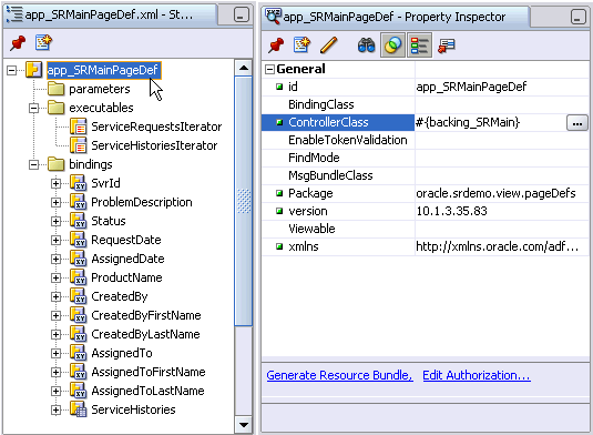

Figure 10-13 illustrates how to select the root node of the page definition in the Structure window to set.
Figure 10-13 Setting the ControllerClass of a Page Definition
Image of setting a controller class in Property Inspector
When using an EL expression for the value of the ControllerClass attribute, the Structure window may show a warning, saying the "#{YourExpression}" is not a valid class. You can safely ignore this warning.

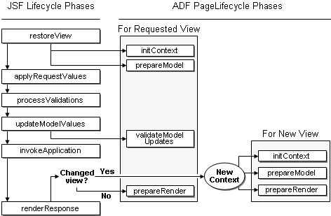

10.5.5 How to Use Refresh Correctly for InvokeAction and Iterator Bindings
Figure 10-14 illustrates how the JSF page lifecycle relates to the extended page processing phases that the ADF page lifecycle adds. You can use the Refresh property on iterator bindings and invokeAction executables in your page definition to control when each are evaluated during the ADF page lifecycle, either during the prepareModel phase, the prepareRender phase, or both. Since the term "refresh" isn't exactly second-nature, this section clarifies what it means for each kind of executable and how you should set their Refresh property correctly to achieve the behavior you need.
Figure 10-14 How JSF Page Lifecycle and ADF Page Lifecycle Phases Relate
Image shows relationships between JSF and ADF lifecycles

Notice in Figure 10-14 that the key distinction between the ADF prepareModel phase and the prepareRender phase is that one comes before JSF's invokeApplication phase, and one after. Since JSF's invokeApplication phase is when action listeners fire, if you need your invokeAction to trigger after these action listeners have performed their processing, you'll want to use the Refresh="renderModel" setting on it.
