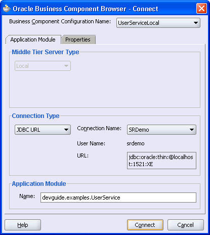

To test an application module, select it in the Application Navigator and choose Test from the context menu. The Business Component Browser Connect dialog appears as shown in Figure 5-14. In the upper right corner of the dialog, the Configuration Name list allows you to choose any of your application module's configurations for the current run of the tester tool. Click Connect to start the application module using the selected configuration.

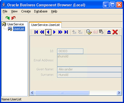

When you launch the Business Components Browser, JDeveloper starts the tester tool in a separate process and the Business Components Browser appears. The tree at the left of the dialog displays all of the view object instances in your application module's data model. Figure 5-15 has only one instance called UserList. Double-clicking the UserList view object instance in the tree executes the view object — if it has not been executed so far in the testing session — and displays a panel to inspect the query results as shown in Figure 5-15. Additional context menu items on the view object node allow you to re-execute the query if needed, to remove the tester panel, and to perform other tasks.

You can see that the fields in the test panel for the view object are disabled for the UserList view object instance, because the view object is read only. In Section 7.5, "Testing Entity-Based View Objects Interactively", you'll see that the tester tool becomes even more valuable by allowing you to experiment with inserting, updating, and deleting rows in view objects, too. But even for a read-only view object, the tool affords some useful features. Firstly, you can validate that the UI hints and format masks are defined correctly. The attributes display with their defined Label Text control hints as the prompt, and the UserId field is displayed as 00303 due to the 00000 format mask defined in Section 5.4.1, "How to Add Attribute Control Hints". Secondly, you can scroll through the data using the toolbar buttons.

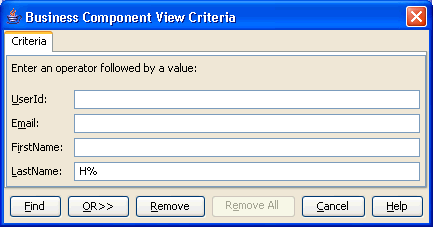

Thirdly, you can enter query-by-example criteria to find a particular row whose data you want to inspect. By clicking the Specify View Criteria button in the toolbar, the View Criteria dialog displays as shown in Figure 5-16. You can enter a query criteria like "H%" in the LastName attribute and click Find to narrow the search to only those users with a last name that begins with the letter H (Hunold, Himuro, Hartstein, and Higgins).

As described in Figure 5-14, on the Connect dialog of the Business Component Browser you can select a predefined configuration to run the tool using that named set of runtime configuration properties. The Connect dialog also features a Properties tab that allows you to see the selected configurations settings and to override any of the configuration's settings for the current run of the browser. For example, you could test the Italian language translations of the UI control hints for a single Business Components Browser run by opening the Properties tab and setting the following two properties:
  • jbo.default.country = IT
  • jbo.default.language = it
If you wanted to make the changes permanent, you could use the Configuration Manager to copy the current UserServiceLocal configuration and create a new UserServiceLocalItalian which had these two additional properties set. This way, anytime you wanted to test in Italian you could simply choose to use the UserServiceLocalItalian configuration instead of the default UserServiceLocal one.
