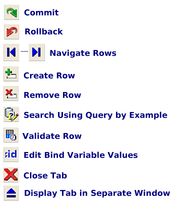

You'll find the Business Components Browser tool invaluable in quickly testing and debugging your application modules. Figure 7-14 gives an overview of the operations that all of the Business Components Browser toolbar buttons perform.

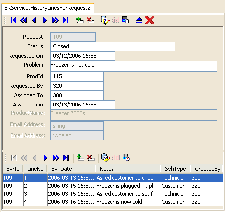

When you launch the Business Components Browser, JDeveloper starts the tester tool in a separate process and the Business Component Browser appears. As shown in Figure 7-16 the tree at the left of the display shows the hierarchy of the view object instances in the data model, and includes additional nodes between a master view object instance and a detail view object instance that represent the view link instance that performs the active master/detail coordination as the current row changes in the master.
Double-clicking on the HistoryLinesForRequest2
view link instance in the tree executes the master objects — if it has not been executed so far in the testing session — and displays the master/detail tester panel shown in Figure 7-17. Additional context menu items on the view object node allow you to reexecute the query if needed, remove the tester panel, and perform other tasks. You saw a similar master/detail panel when you used the Business Components Browser in Section 5.5, "Testing View Objects Using the Business Components Browser". You can see and scroll through the query results. One important difference is a direct result of using an entity-based view object this time. Instead of seeing disabled UI controls showing read-only data, you now see editable fields and are free to experiment with creating, inserting, updating, validating, committing and rolling back.

Using just the master/detail tester page shown in Figure 7-17, you can test several functional areas of your application.
Use the navigation buttons on the toolbar, you can see that the service history rows for the current service request are correctly co-ordinated.
The prompts displayed in the testing panels help you see whether you have correctly defined a user-friendly Label Text control hint for each attribute. For example, the RequestDate
attribute in the ServiceRequests
view object instance has the prompt Requested On. Hovering your mouse over the edit field for the RequestDate
field, you'll shortly see the Tooltip control hint text appear if you've defined it. The tooltip that appears says, "The date on which the service request was created", which is how you set up the hint on your entity object back in Section 6.5.1, "How to Add Attribute Control Hints". Since you didn't specifically define any new control hints for the ServiceRequests
view object, this illustrates that the entity-based view object attributes inherit their control hints from those on the underlying entity object attribute.
By scrolling through the data — or using Specify View Criteria toolbar button to search — you can verify whether service requests that have not yet been assigned are correctly displaying. If you correctly altered the query's WHERE clause to use an outer join, these row will appear as expected.
By changing the AssignedTo
attribute to a different technician's user ID — double-click on the StaffList
view object instance in the Business Components Browser to browse for some valid staff user ID's — you can verify that the corresponding reference information is automatically updated to reflect the new technician.
