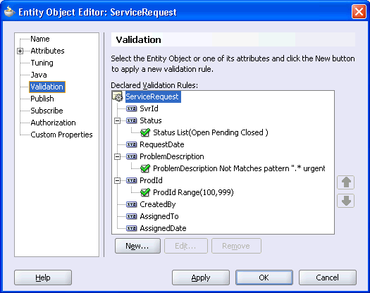

To add a validation rule to an entity object, use the Validation page of the Entity Object Editor, as shown in Figure 6-17. To add an attribute-level validation rule, select the attribute in the Declared Validation Rules tree, and click New.... Defining an entity-level validation rule is similar, except that you select the root entity object node in the tree before clicking New....
Figure 6-17 Validation Page of the Entity Object Editor

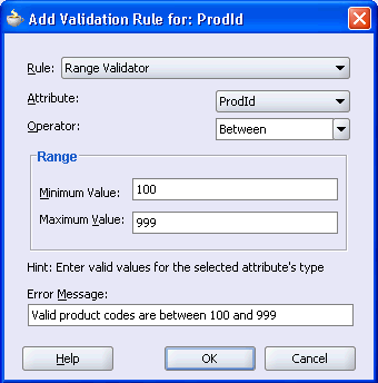

When you add a new validation rule, the Add Validation Rule dialog appears. Use the Rule dropdown list to select the kind of validation rule you want, and configure its declarative settings using the other controls in the page. The controls will change depending on the kind of validation rule you select. Figure 6-18 illustrates what the Add Validation Rule dialog would look like when defining a range validation rule for the ProdId attribute of the ServiceRequest entity object. This validation rule has been selected to enforce that the value lie between 100 and 999 inclusive. When you add a validation rule, you also can enter an error message that will be shown to the user if the validation rule fails.

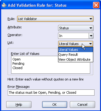

The List Validator is designed for validating an attribute against a relatively small set of values. As shown in Figure 6-19, if you select the Query Result or View Object Attribute style of list validation, keep in mind the validator will retrieve all of the rows from the query before performing an in-memory scan to validate whether the attribute value in question matches an attribute in the list. The query performed by the Validator's SQL or view object query does not reference the value being validated in the WHERE clause of the query.
In other words, this is not the feature to use if you want to validate that a user-entered product code exists in a table of a million products. Section 9.6, "Using View Objects for Validation", explains the technique you can use to efficiently perform SQL-based validations by using a view object to perform a targeted validation query against the database.
Figure 6-19 List Validator is Designed for Relatively Small Lists of Values
