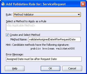

To create an entity-level method validator:
Open the Entity Object Editor.
If your entity object does not yet have a custom Java class, then first open the Java page and enable the generation of an Entity Object Class, and click Apply to generate the *.java
file.
Open the Validation page and select root node in the tree that represents the entity object itself.
Click New to add a validation rule.
Select the Method Validator type from the Rule dropdown list, as shown in Figure 9-4.
The Add Validation Rule dialog displays the expected method signature for an entity-level validation method. You have two choices:
If you already have a method in your entity object's custom Java class of the appropriate signature, it will appear in the list and you can select it after unchecking the Create and Select Method checkbox
If you leave the Create and Select Method checked, you can enter any method name in the Method Name box that begins with the word validate
and when you click OK JDeveloper will add that method to your entity object's custom Java class with the appropriate signature.
Finally, supply the text of the error message for the default locale that the end user should see if this validation rule fails.
When you add a new method validator, JDeveloper updates the XML component definition to reflect the new validation rule. If you asked to have the method created, the method is added to the entity object's custom Java class. Example 9-2 illustrates a simple entity-level validation rule that ensures the AssignedDate
of a service request comes after the RequestDate
