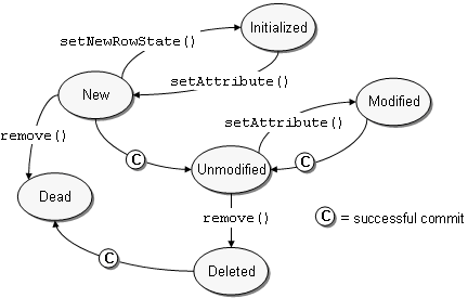

9.2.5 Understanding Entity Objects Row States
When an entity row is in memory, it has an entity state that reflects the logical state of the row. Figure 9-2 illustrates the different entity row states and how an entity row can transition from one state to another. When a entity row is first created, its status is New. You can use the setNewRowState() method to mark the entity as being Initialized, which removes it from the transaction's list of pending changes until the user sets at least one of its attributes, at which time it returns to the New state. The Unmodified state reflects an entity that has been retrieved from the database and has not yet been modified. It is also the state that a New or Modified entity transitions too after the transaction successfully commits. During the transaction in which it is pending to be deleted, an Unmodified entity row transitions to the Deleted state. Finally, if a row that was New and got removed before the transaction commits, or Unmodified and got successfully deleted, the row transition to the Dead state.
Figure 9-2 Diagram of Entity Row States and Transitions
Image of diagram of entity row states and transitions
You can use the getEntityState() method to access the current state of an entity row in your business logic code.
