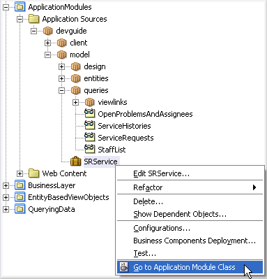

To add a custom service method to your application module, you must first enable a custom Java class for it. If you have configured your IDE-level Business Components Java generation preferences to automatically generate an application module class, you're set. If you're not sure whether your application module has a custom Java class, as shown in Figure 8-3, check the context menu for the Go to Application Module Class option. This option lets you quickly navigate to your application module's custom class, but if you don't see the option in the menu then that means your application module is currently an XML-only component.
Figure 8-3 Quickly Navigating to an Application Module's Custom Java Class
Image of context menu in Application Navigator
To enable the class, open the Application Module Editor, visit the Java page, select the Generate Java File checkbox for an Application Module Class, then click OK to finish the wizard.

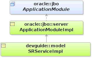

As shown in Figure 8-4, your application module class extends the base ADF ApplicationModuleImpl class to inherit all the default behavior before adding your custom code.
