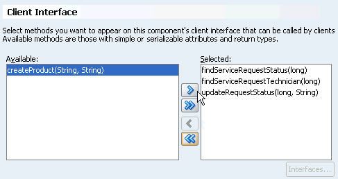

To include a public method from your application module's custom Java class on the client interface, use the Client Interface page of the Application Module Editor. As shown in Figure 8-5, select one or more desired methods from the Available list and press > to shuttle them into the Selected list. Then click OK to dismiss the editor.
Figure 8-5 Adding a Public Method to an Application Module's Client Interface
Image of Client Interface dialog

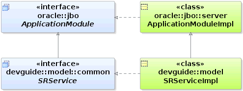

When you publish custom service methods on the client interface, as illustrated in Figure 8-6, JDeveloper creates a Java interface with the same name as the application module in the common subpackage of the package in which your application module resides. For an application module named SRService in the devguide.model package, this interface will be named SRService and reside in the devguide.model.common package. The interface extends the base ApplicationModule interface in the oracle.jbo package, reflecting that a client can access all of the base functionality that your application module inherits from the ApplicationModuleImpl class.
Figure 8-6 Custom Service Interface Extends the Base ApplicationModule Interface
Image of interface extending application module interface

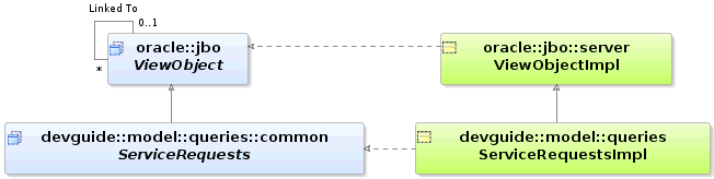

If for the ServiceRequests view object in the devguide.model.queries package you were to enable the generation of a custom view object Java class and add one or more custom methods to the view object client interface, JDeveloper would generate the ServiceRequestsImpl class and ServiceRequests interface, as shown in Figure 8-7. As with the application module custom interface, notice that it gets generated in the common subpackage.
Figure 8-7 Custom View Object Interface Extends the Base ViewObject Interface
Image of view object interface extending another interface

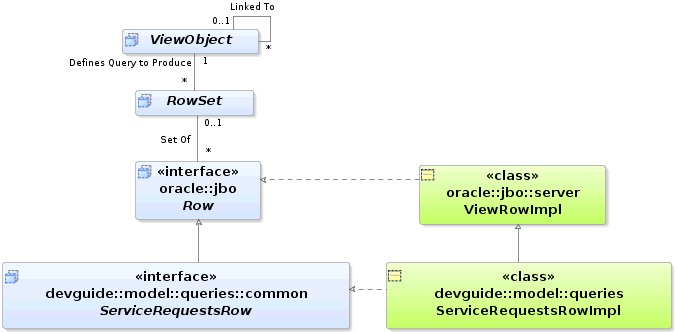

Likewise, if for the same view object you were to enable the generation of a custom view row Java class and add one or more custom methods to the view row client interface, JDeveloper would generate the ServiceRequestsRowImpl class and ServiceRequestsRow interface, as shown in Figure 8-8.
Figure 8-8 Custom View Row Interface Extends the Base Row Interface
image view row interface extending the Base Row Interface
