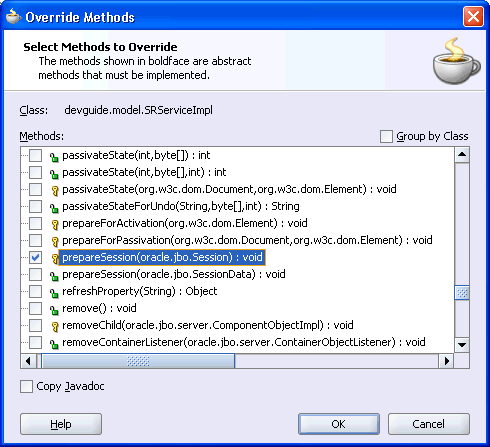

To override a built-in framework method for an application module, go to the application module Java class and then choose Source | Override Methods... from the JDeveloper main menu. As shown in Figure 8-9, the Override Methods dialog appears. You can scroll the list of methods using the scrollbar, but if you know the method you want to override, begin typing the first few letters of its name to perform an incremental search to find it more quickly in the list.
Assume that you want to override the application module's prepareSession() method to augment the default functionality when a new user session begins working with an application module service component for the first time. Check the checkbox next to the prepareSession(oracle.jbo.Session) method, and click OK.
Here you've only selected one method, but the Override Methods dialog allows you to select any number of methods to override simultaneously.
