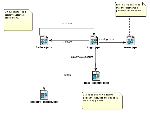

Consider a simple application that requires users to log in to see their orders. Figure 19-3 shows the page flow for the application, which consists of five pages—login.jspx
, orders.jspx
, new_account.jspx
, account_details.jspx
, and error.jspx

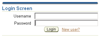

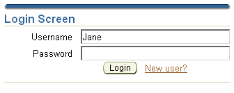

When an existing user logs in successfully, the application displays the Orders page, which shows the user's orders, if there are any. When a user does not log in successfully, the Error page displays in a popup dialog, as shown in Figure 19-4.

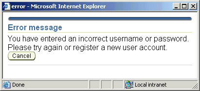

On the Error page there is a Cancel button. When the user clicks Cancel, the popup dialog closes and the application returns to the Login page, as shown in Figure 19-5.

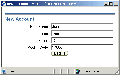

When a new user clicks the New User link on the Login page, the New Account page displays in a popup dialog, as shown in Figure 19-6.

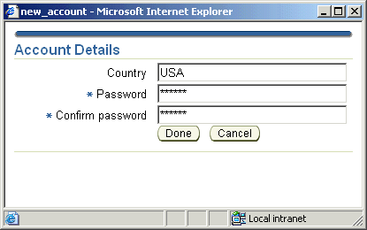

After entering information such as first name and last name, the user then clicks the Details button to display the Account Details page in the same popup dialog, as shown in Figure 19-7. In the Account Details page, the user enters other information and confirms a password for the new login account. There are two buttons on the Account Details page—Cancel and Done.
If the new user decides not to proceed with creating a new login account and clicks Cancel, the popup dialog closes and the application returns to the Login page. If the new user clicks Done, the popup dialog closes and the application returns to the Login page where the Username field is now populated with the user's first name, as shown in Figure 19-8. The new user can then proceed to enter the new password and log in successfully.

You manage the navigation into a popup dialog by defining a standard JSF navigation rule with a special dialog:
outcome. Using the dialog sample application shown in Figure 19-3, three navigation outcomes are possible from the Login page:
Show the Orders page in the same window (successful login)
Show the Error dialog page in a popup dialog (login failure)
Show the New Account dialog page in a popup dialog (new user)
Example 19-16 shows the navigation rule for the three navigation cases from the Login page (login.jspx

In the originating page from which a popup dialog is launched, you can use either an action method or a static action outcome on the ActionSource
component. Whether you specify a static action outcome or use an action method that returns an action outcome, this action outcome must begin with dialog:
The sample application uses an action method binding on the commandButton
component to determine programmatically whether to navigate to the Orders page or the Error dialog page, and a static action outcome on the commandLink
component to navigate directly to the New Account dialog page. Both command components are on the Login page. Example 19-17 shows the code for the Login commandButton
component.
Example 19-17 Login Button on the Login Page
af:commandButton id="cmdBtn"
text="Login"
action="#{backing_login.commandButton_action}"
useWindow="true"
windowHeight="200"
windowWidth="500"
partialSubmit="true"/>

The dialog pages in our sample application are the Error page, the New Account page, and the Account Details page. The dialog process for a new user actually contains two pages: the New Account page and the Account Details page. The dialog process for a user login failure contains just the Error page.
A dialog page is just like any other JSF page, with one exception. In a dialog page you must provide a way to tell ADF Faces when the dialog process finishes, that is, when the user dismisses the dialog. Generally, you do this programmatically or declaratively via a command component. Example 19-20 shows how to accomplish this programmatically via a Cancel button on the Error page.
Example 19-20 Cancel Button on the Error Page
<af:commandButton text="Cancel" actionListener="#{backing_error.cancel}" />
The actionListener
attribute on commandButton
specifies a reference to an action listener method in the page's backing bean, Error.java
. The action listener method processes the action event that is generated when the Cancel button is clicked. You call the AdfFacesContext.returnFromDialog()
method in this action listener method, as shown in Example 19-21.
Example 19-21 Action Listener Method for the Cancel Button in a Backing Bean
public void cancel(ActionEvent actionEvent)
AdfFacesContext.getCurrentInstance().returnFromDialog(null, null);
Note: TheAdfFacesContext.returnFromDialog() method returns null . This is all that is needed in the backing bean to handle the Cancel action event. |
To accomplish the same declaratively on the Account Details dialog page, attach a af:returnActionListener
tag to the Cancel button component, as shown in Example 19-22. The af:returnActionListener
tag calls the returnFromDialog
method on the AdfFacesContext
—no backing bean code is needed.

In the sample application, a new user can enter a name in the Username field on the Login page, and then click the New User link. When the New Account dialog page displays in a popup dialog, the First Name input field is automatically populated with the name that was entered in the Login page. To accomplish this, you register a launch listener on the command component that launched the dialog (which would be commandLink
). Example 19-27 shows the code for the commandLink
component.
Example 19-27 Input Field and New User Command Link on the Login Page
<af:inputText label="Username" value="#{backing_login.username}"/>
<af:commandLink id="cmdLink" text="New User?"
action="dialog:newAccount"
useWindow="true" partialSubmit="true"
launchListener="#{backing_login.handleLaunch}"
returnListener="#{backing_login.handleReturn}"
windowHeight="200" windowWidth="500" />
The LaunchListener
attribute on commandLink
specifies a reference to a launch listener method in the page's backing bean, Login.java
. In the launch listener method you use the getDialogParameters()
method to add a parameter to a Map
using a key-value pair. Example 19-28 shows the code for the launch listener method.
Example 19-28 Launch Listener Method for the New User Command Link in a Backing Bean
public void handleLaunch(LaunchEvent event)
//Pass the current value of the field into the dialog
Object usr = username;
event.getDialogParameters().put("firstname", usr);
// Use by inputText value binding
public String username;
public String getUsername()
return username;
public void setUsername(String username)
this.username = username;

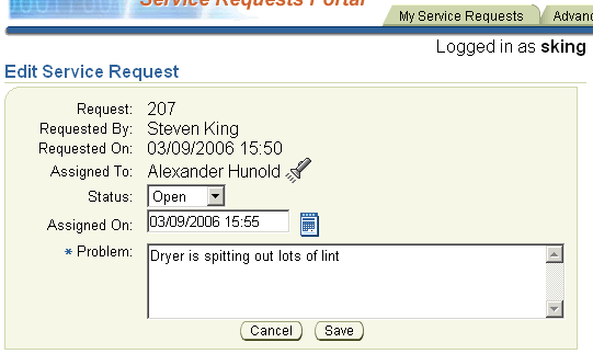

The SRDemo application uses a popup dialog to:
Display a list of frequently asked questions (FAQ).
Select and assign a technician to an open service request.
In the Create New Service Request page (see Figure 19-13), when the user clicks the Frequently Asked Questions link, the application displays a popup dialog showing the FAQ list.
In the Edit Service Request page, when the user clicks the flashlight icon next to the Assigned to label (see Figure 19-12), the application displays the Search for Staff popup dialog. In the dialog (as shown in Figure 19-9), the user first makes a search based on user role. Then in the results section, the user clicks the radio button next to a name and clicks Select.
After making a selection, the popup dialog closes and the application returns to the Edit Service Request page where the Assigned to display-only fields are now updated with the selected technician's first name and last name, as shown in Figure 19-10. You don't need to write any code to facilitate the update as the fields are automatically updated when the foreign key AssignedTo

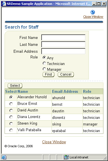

Thirdly, the dialog pages SRStaffSearch.jspx
and SRFaq.jspx
have to call the AdfFacesContext.returnFromDialog()
method to let ADF Faces know when the user dismisses the dialogs. In SRStaffSearch.jspx
, which uses a table
component with a tableSelectOne
component to display the names for selection, the AdfFacesContext.returnFromDialog()
method is called when the user clicks the Select commandButton
component after selecting the radio button for a name in the table. The af:returnActionListener
tag on the Select button component calls the returnFromDialog()
method, which closes the dialog and sends the return value from the dialog—no backing bean code is needed. Example 19-33 shows the code snippet for the Select button component.
Example 19-33 CommandButton Component for Selecting a Name and Closing the Popup Dialog
<af:tableSelectOne>
<af:commandButton text="#{res['srstaffsearch.button.select']}">
<af:setActionListener from="#{row.UserId}"
to="#{bindings.AssignedTo.inputValue}"/>
<af:returnActionListener value="#{row.UserId}"/>
</af:commandButton>
</af:tableSelectOne>

Note that the SRStaffSearch page definition file includes a binding to the AssignedTo
attribute. In the SRStaffSearch dialog, when the user selects a radio button for a name and then clicks Select, the dialog is dismissed and the application returns to the SREdit page with the selected name populated in the Assigned To display-only fields. As shown in Example 19-33, the Select commandButton
component has an af:setActionListener
tag that is configured to set the value of the selected UserId
to the value of the AssignedTo
attribute. The Select commandButton
also has the af:returnActionListener
tag, which returns the value of the selected UserId
. The commandLink
component that launches the SRStaffSearch dialog has an attached return listener (see Example 19-31), but the return handler code (as shown in Example 19-35) does not use the return value. The return handler simply causes the Assigned On date field to refresh its value from the binding.
