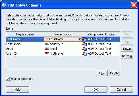

  4. On the Data Control Palette context menu, choose Bind Existing ADF Table or Bind Existing ADF Read-only Table. The Edit Table Column dialog appears, as shown in Figure 21-4.
    Figure 21-4 Edit Table Column Dialog
    The Display Label column in the dialog displays the placeholder column headings entered when the table was created. In the example, the placeholder column headings are First Name, Last Name, Email, and User ID. The Value Binding column displays the attributes from the data collection. The Component to Use column displays the types of components each table column will contain.

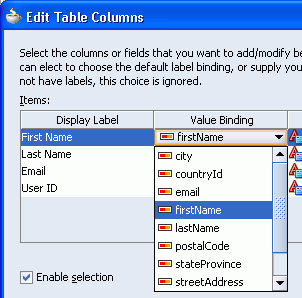

  5. In the Edit Table Columns dialog, use the dropdowns in the Value Binding fields to choose the attributes from the data collection to be bound to each column in the table, as shown in Figure 21-5. If placeholder column headings were entered when the table was created, match the attributes to the appropriate column headings. For example, if a column heading is First Name, you would choose the firstName attribute from the Value Binding dropdown next to that column heading.
    Figure 21-5 Value Binding Dropdown in the Edit Table Columns Dialog
    Value Binding Dropdown in the Edit Table Columns dialog.
    Tip:
    If you need to add additional columns to the table, click New.
