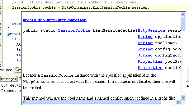

24.5.3 Seeing Better Information in the Code Editor
Once you have added the ADF Source library to your project, you instantly have access to the helpful Quick JavaDoc feature ([Ctrl]+[D]) that the JDeveloper Code Editor makes available. As shown in Figure 24-3, invoking the Quick JavaDoc on a method like findSessionCookie().
Figure 24-3 Using Quick JavaDoc on ADF API's in Code Editor
Screenshot shows Quick JavaDoc in Code Editor.

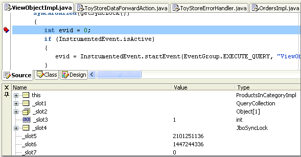

24.5.5 Seeing Better Symbol Information Using Debug Libraries
When debugging Oracle ADF source, as shown in Figure 24-4 by default you will not see symbol information for parameters or member variables of the currently executing method.
Figure 24-4 Local Symbols Are Hard To Understand Without Debug Libraries
Screenshot shows symbols in debugger without debug libs.
This can make debugging a little less useful. You can make the situation better by using the debug versions of the ADF JAR files supplied along with the source, while debugging in your development environment.
The supplied debug libraries are not recommended for use in a test or production environment since they typically have slightly slower runtime performance than the optimized JAR files shipped with JDeveloper.

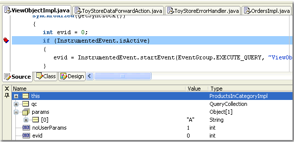

The debuglib subdirectory of C:\adf_1013_3673_source contains versions of Oracle ADF JAR files from JDeveloper 10.1.3 Build 3673 that have been compiled with additional debug information. When you use these debug JAR files instead of the default optimized JAR files you will see all of the information in the debugger as shown in Figure 24-5.
Figure 24-5 See Local Symbol Information in Debugger Using Debug Libraries
Screenshot shows local symbol information in debugger.
