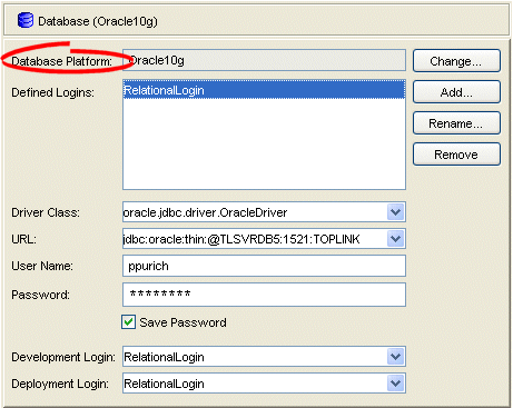

Configuring Relational Database Platform at the Project Level
For each relational project, you must specify the database platform (such as Oracle Database 10g). This platform configuration is overridden by the session login, if configured.
For more information, see the following:
Using TopLink Workbench
To specify the database platform of a relational project, use this procedure:
  1. Select the database object in the Navigator. The Database property sheet appears.
    Figure 20-1 Database Property Sheet, Database Platform Options
    Description of Figure 20-1 follows
    Description of "Figure 20-1 Database Property Sheet, Database Platform Options"
Click Change to select a new database platform for the project. For more information, see "Data Source Platform Types".

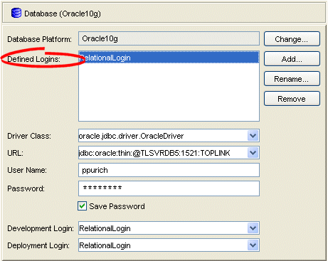

To create or edit a database login, use this procedure:
    Figure 20-3 Database Property Sheet, Database Login Fields
    Description of Figure 20-3 follows
    Description of "Figure 20-3 Database Property Sheet, Database Login Fields"
  2. Click Add to create a new Defined Login.
Use this table to enter data in the following fields on the Database property sheet to configure the database login:
Field Description
Defined Logins Login used to access the database. Click Add to add a new login, or Remove to delete an existing login.
Driver Class The JDBC driver to use to connect to the database.
URL The URL used to connect to the appropriate database.
User Name The name required to log in to the database.
Password The password required to log in to the database.
Note: When exporting Java source and deployment XML (see "Exporting Project Information"), TopLink Workbench writes the database password (if applicable) using JCE encryption (when using JDK 1.4). Refer to Oracle TopLink Getting Started Guide for information on using password encryption with JDK 1.3 and earlier. For information on how to specify password encryption options, see "Configuring Password Encryption".
    Save Password Whether or not to save the Password for this Defined Login.

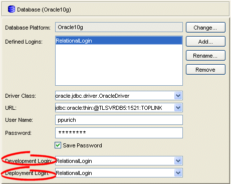

Configuring Development and Deployment Logins
This section describes how to designate a defined login's role. For information on how to define a login, see "Configuring Login Information". TopLink recognizes the following login roles:
Development Role
While using TopLink Workbench to develop a project (see "Development Role: Development Login"), you must define a login (see "Configuring Login Information") and designate it as the development login. The development login is stored in the TopLink project file. TopLink Workbench uses the information in the development login whenever you perform a data source operation from within TopLink Workbench. For example, when you read or write schema information from or to a data source during application development, the development login information is never written to a sessions.xml or project.xml file and is overridden by the deployment login (or the session login) at run time.
For more information on how to use a development login to connect to a database, see "Logging in to the Database".
CMP Deployment Role
If you are creating a CMP project (see "CMP Deployment Role: Deployment Login"), you may define a run-time login (see "Configuring Login Information") and designate it as the deployment login. This is the login that the application will use at run time, unless overridden in the sessions.xml file, CMP deployment file, or through Java code.
Non-CMP Session Role
If you are creating a non-CMP project (see "Non-CMP Session Role: Session Login"), Oracle recommends that you use the sessions.xml file to store the sessions your project uses at run time (see "Data Source Login Types").
To specify different development and deployment database logins, use this procedure:
    Figure 20-4 Database Property Sheet, Development and Deployment Login Options
    Description of Figure 20-4 follows
    Description of "Figure 20-4 Database Property Sheet, Development and Deployment Login Options"
Use this table to enter data in the following fields on the Database property sheet to configure the login:
Field Description
Development Login The Defined Login to be used by TopLink Workbench during development to connect with the database, and to read or write table information.
Deployment Login The Defined Login to be used by your TopLink-enabled application during deployment.

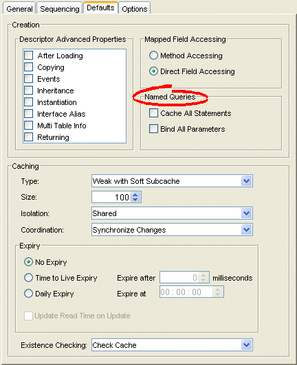

Configuring Named Query Parameterized SQL and Statement Caching at the Project Level
You can configure TopLink to use parameterized SQL and prepared statement caching for all named queries and finders.
These setting apply only to named queries (see "Named Queries")–not to all queries in general or write operations.
Generally, to use parameterized SQL, you should configure it on the session's login (see "Configuring JDBC Options"). Configuring at the session level ensures that all queries will use parameterized SQL.
For applications using a J2EE data source or external connection pool, you must configure statement caching in the J2EE server's data source–not in TopLink.
Table 20-2 summarizes which projects support query statement caching and binding configuration.
Table 20-2 Project Support for Default Named Query Caching and Binding
Descriptor Using TopLink Workbench
Using Java
Relational Projects
Supported.
Supported.
EIS Projects
Unsupported
Unsupported
XML Projects
Unsupported
Unsupported
This section describes configuring statement caching and binding options at the project level. This configuration applies to all named queries you create on the descriptors in this project.
You can also configure named query statement caching and binding options at the query level to override this project-level configuration on a query-by-query basis (see "Configuring Named Query Options").
Using parameterized SQL, you can create and store queries that are complete except for one or more bound parameters. The TopLink runtime binds the current parameter values when executing the query. This approach avoids the preparation of SQL execution and, thus, improves the performance of frequently executed SQL statements.
By default, Oracle TopLink writes data directly into its generated SQL, and does not use parameterized SQL. This is due to the fact that many JDBC drivers do not fully support parameter binding and impose restrictive size or type limits. For more information, see "Parameterized SQL (Binding) and Prepared Statement Caching".
To specify the named query options, use this procedure:
  1. Select the project object in the Navigator.
  2. Select the Defaults tab in the Editor. The Defaults tab appears.
    Figure 20-5 Defaults Tab, Named Queries Options
    Description of Figure 20-5 follows
    Description of "Figure 20-5 Defaults Tab, Named Queries Options"
Use this table to enter data in following fields on the Defaults tab to specify the named query options for newly created descriptors.:
Field Description
Cache All Statements Caches the query's prepared statement in the TopLink statement cache.
Bind All Parameters Binds all of the query's parameters.

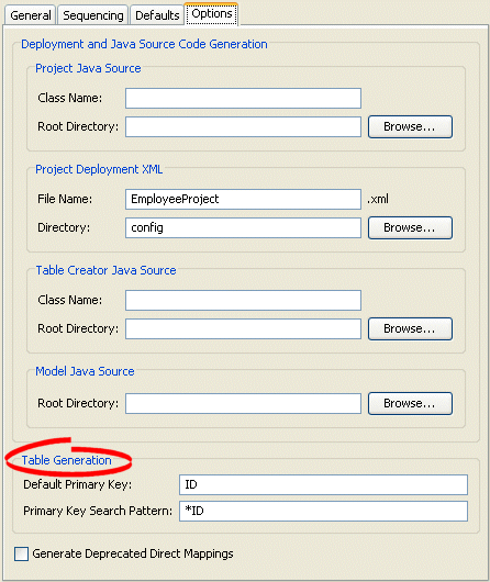

Configuring Table Generation Options
Using TopLink Workbench, you can configure options that apply when you generate database tables from the descriptors you define in your TopLink Workbench project. The resulting tables and columns will conform to the naming restrictions of the project's target database.
To specify the default table generation options, use this procedure:
  2. Select the Options tab in the Editor. The Options tab appears.
    Figure 20-6 Options Tab, Table Generation Options
    Description of Figure 20-6 follows
    Description of "Figure 20-6 Options Tab, Table Generation Options"
Use this table to enter data in the following fields to specify the default export and generation options.
Field Description
Default Primary Key Enter the default name to use when generating primary keys.
Primary Key Search Pattern Enter the default search pattern to use when generating primary keys.

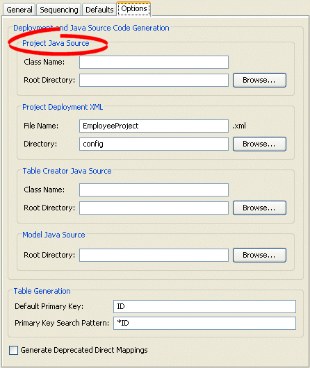

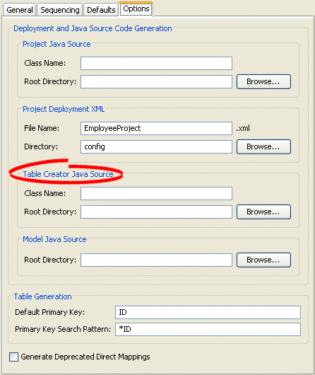

Configuring Table Creator Java Source Options
Using TopLink Workbench, you can configure options that apply when you export Java source code that you can use to create database tables.
To specify the default Java code generation options, use this procedure:
    Figure 20-7 Options Tab, Table Creator Java Source Options
    Description of Figure 20-7 follows
    Description of "Figure 20-7 Options Tab, Table Creator Java Source Options"
Use this table to enter data in the following fields to specify the default table creator options.
Field Description
Class Name Base class name to use when generating table's Java source code from the project.
Root Directory Directory for storing the generated source code.
Configuring Project Java Source Code Options
Using TopLink Workbench, you can export a project as Java source. You can configure the class name and root directory that TopLink Workbench uses when exporting the project to Java source code.
For more information on exporting a project as Java source, see "Exporting Project Java Source".
    Figure 20-8 Options Tab, Project Java Source Options
    Description of Figure 20-8 follows
    Description of "Figure 20-8 Options Tab, Project Java Source Options"
Use this table to enter data in the following fields to specify the default export and generation options:
Field Description
Class Name Base class name to use when generating Java source code from the project.
