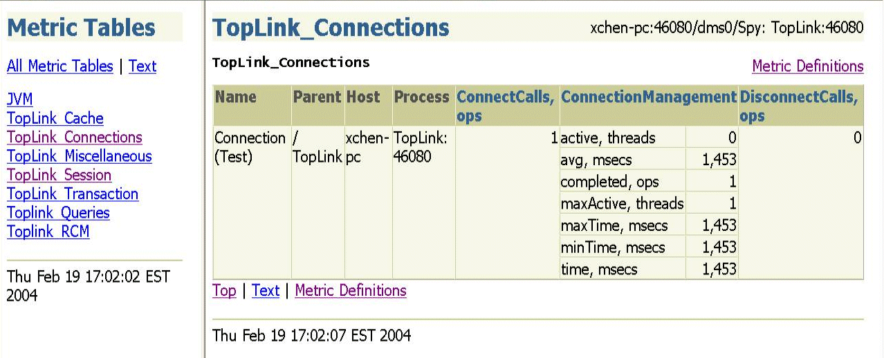

Accessing Oracle DMS Profiler Data Using the DMS Spy Servlet
Once your DMS enabled TopLink application is running, you can access the DMS data it is collecting.
The DMS Spy servlet is available in all Java processes that use DMS. It lets you monitor metrics for a single Java process from a Web browser.
To access DMS data directly using the DMS Spy servlet, do the following:
  1. Ensure that the dms.jar file is in your application classpath.
    By default, the dms.jar file is located in <ORACLE_HOME>\lib.
  2. Set the following system properties for the DMS enabled Java process you want to monitor:
    oracle.dms.publisher.classes=oracle.dms.http.Httpd
    oracle.dms.httpd.port.start=<port>
    where <port> is the HTTP port on which DMS accepts requests (the default value is 46080).
  3. Apply the system property changes by restarting the Java process you want to monitor.
  4. Using a Web browser, connect to the Java process and access the Spy servlet by entering the following URL:
    http://<host>:<port>/dms0/Spy
    where <host> is the host name of your Java process and <port> is the value specified by the oracle.dms.httpd.port.start system property.
    The Spy servlet displays all TopLink DMS-enabled objects appropriate for the current DMS level setting. Figure 11-1 shows an example of the DMS Spy servlet display.
    Figure 11-1 DMS Spy Servlet Display
    Description of Figure 11-1 follows
    Description of "Figure 11-1 DMS Spy Servlet Display"
