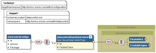

The toplevel element of the DataControls.dcx file is <DataControlConfigs>:
<DataControlConfigs xmlns="http://xmlns.oracle.com/adfm/configuration"
version="10.1.3.35.65" Package="oracle.srdemo.model"
id="DataControls">
where the XML namespace attribute (xmlns) specifies the URI to which the data controls bind at runtime. Only the package name is editable; all other attributes should have the values shown.
Figure A-3 displays the toplevel <DataControlConfigs> element. Note that the BaseDataControl element is a placeholder for the concrete data control types. In the SRDemo application, the data control type is the AdapterDataControl.

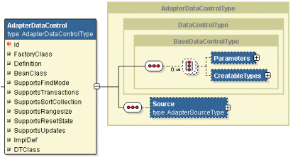

Figure A-4 displays the <AdapterDataControl> element that substitutes for the placeholder <BaseDataControlType> element. Note that each business service for which you have created a data control, will have its own <AdapterDataControl> definition.
The child elements have the following usages:
<AdapterDataControl> created by the Adapter Data Control to define properties of the data control. The properties of the data control definition varies with the business service for which the data control is created.
<CreatableTypes> defines types from which a constructor method may be called. For example, a type may be an EJB, TopLink object, JavaBean, or web service. Contains one or more child elements <TypeInfo>.
<Source> defines the service for which the data control is created. Used only in the case of adapter-based data controls, such as EJB session facade data controls. In the case of the EJB session facade, contains the child element <ejb-definition>.
