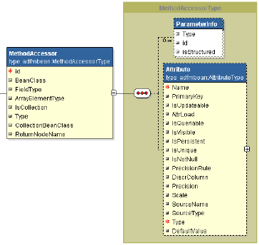

Figure A-8 displays the <MethodAccessor> child element of the <JavaBean> element. It defines the structure information for a method that returns an object or collection. Note that unlike attribute accessors, method accessors can define parameters.
Table A-2 describes the attributes of the structure definition of the bean. Note that each attribute or method specified by the bean, will have its own <Attribute>, <AccessorAttribute>, and <MethodAccessor> definition and each method parameter will have its own <ParameterInfo> definition.
