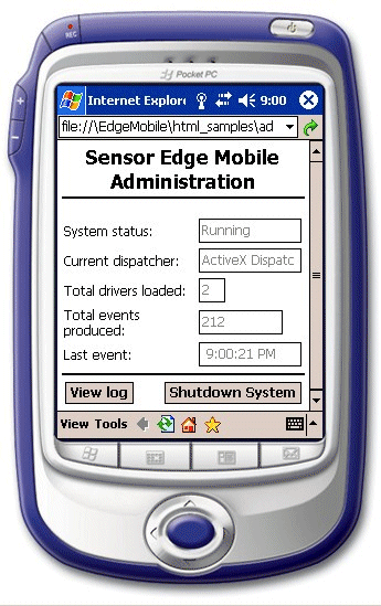

  2. To start the Sensor Edge Mobile background service from the emulator screen, choose Start, then choose Programs, and then click the Start EdgeMobile Service shortcut. The background service should now be running.
  3. To verify that the background service is running, open a File Explorer window, navigate to the \EdgeMobile\html_samples directory, and click admin.html. The Sensor Edge Mobile Administration page should appear as shown in Figure 1-1.
    Figure 1-1 Sensor Edge Mobile Administration Page
    Description of "Figure 1-1 Sensor Edge Mobile Administration Page"

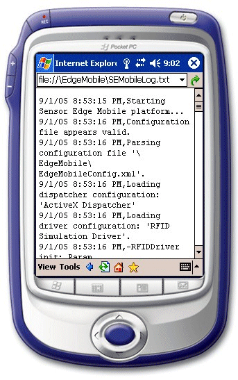

  4. Verify that the System status is "Running". If System status is not "Running", click View log to examine the log file for errors. The log file is shown in Figure 1-2.
    Figure 1-2 Sensor Edge Mobile Log File
    Sensor Edge Mobile Log file
    Description of "Figure 1-2 Sensor Edge Mobile Log File"
