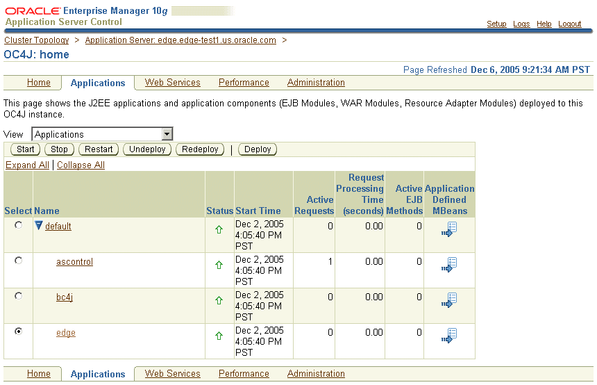

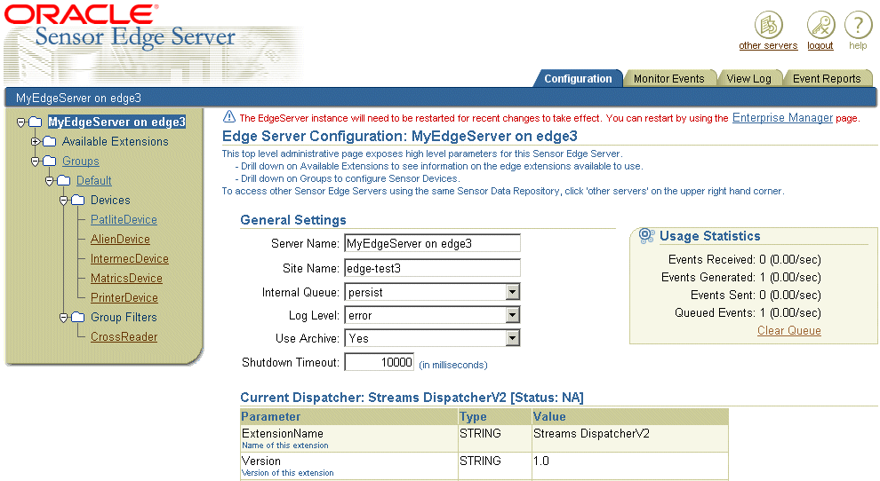

After you log into the SES Console using the OC4J administrator name and password, The console defaults to the Configuration tab, which displays the Main page. This page provides an overall view of the current Oracle Sensor Edge Server instance usage, its basic configuration and its current dispatcher. You can edit the basic configuration, such as the Server and Site Name parameters from this page, as well as select another dispatcher method. For more information on the basic configuration for an Oracle Edge Sensor Server Instance, see "Setting the General Information for the Oracle Sensor Edge Server Instance".
Figure 3-1 The Main Page (Partial View)
Description of Figure 3-1 follows
Description of "Figure 3-1 The Main Page (Partial View)"
See "Setting the General Information for the Oracle Sensor Edge Server Instance" for more information on the basic configuration of the Oracle Sensor Edge Server instance. For more information on dispatchers, see "Configuring Devices, Filter Instances, and Dispatchers".

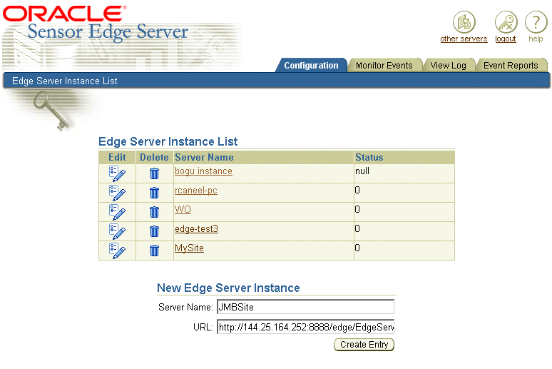

The SES Console enables you to access other Oracle Sensor Edge Server instances that are connected to the same Sensor Data Repository using the Edge Server Instance List page (Figure 3-3), which you access using the other servers icon (Figure 3-4).
Figure 3-3 The Edge Server Instance List
Description of Figure 3-3 follows
Description of "Figure 3-3 The Edge Server Instance List"
The page's Edge Server Instance List table lists the entries for the other Oracle Sensor Edge Servers that are connected to the same Sensor Data Repository. These entries enable you to identify and access the other server instances. Using this table, you can both access another Oracle Sensor Server instance, and view the running status of other Oracle Sensor Server instances. In addition you can edit and delete the entries for other Oracle Sensor Server instances.
To access another Oracle Sensor Server instance, click the name of the instance in the Server Name column of the Edge Server Instance List table and then enter the OC4J administrator name and password in the login page that appears.
Clicking the table's notepad and trash can icons enable you to edit or delete an entry for a selected Oracle Sensor Edge Server instance, respectively. The fields in the page's New Server Instance section enable you create an entry for an Oracle Sensor Edge Server instance, which is comprised of the instance's name and its location as described in "Creating an Entry for an Oracle Sensor Edge Server Instance".
Because live Oracle Sensor Edge Server instances create their own entries once they are started, you are not required to create an entry for an Oracle Sensor Edge Server instance.
To create an entry for an Oracle Sensor Edge Server instance:
  1. Click the other servers icon (Figure 3-4). The Edge Server Instance List page appears (Figure 3-3), which includes a table listing the Oracle Sensor Edge Server instances that are connected to the same Sensor Data Repository.
  2. Enter a name for the Oracle Sensor Edge Server instance.
  3. Enter the URL that points to the Oracle Sensor Edge Server instance. Enter the URL in the following format:
    http://<hostname/ip address>:<port>/edge
    The <port> value is the port on which Oracle Application Server Containers for J2EE (OC4J) listens, which is located on the machine running the Oracle Sensor Edge Server instance. For a 10.1.3 OC4J instance, find the port value by navigating to oracle_home/opmn/bin and then running the following command:
    opmnctl status - l
    For a 10.1.2 OC4J instance, the OC4J listener port is generally 8888. For more information on OC4J 10.1.2, see Oracle Application Server Containers for J2EE User's Guide and "Installing OC4J".
  4. Click Create Entry. The new Oracle Sensor Edge Server instance appears in the Edge Server Instance List table.

The General Settings section of the Main page enables you to edit the basic information for the Oracle Sensor Edge Server instance (described in Table 3-2). Click Save Changes to commit the updates to the Oracle Sensor Edge Server.
Table 3-2 The General Settings
Parameter Description
Server Name
A name for the Oracle Sensor Edge Server instance.
Site Name
The site name for the Oracle Sensor Edge Server. This parameter is a grouping mechanism to logically distinguish between Oracle Sensor Edge Server instances.
Internal Queue
Event messages sent from readers (or any device) are enqueued into the internal queue. A dispatcher takes events from this queue and then dispatches them. For example, the Streams Dispatcher dispatches the event messages from this queue to a database.
The following options enable you to protect data by controlling how event messages are held before they are dispatched and safeguard event data.
. Options include:
  • Persist -- Selecting the Persist mode stores event messages to a disk where they are then gathered by a dispatcher. Storing these event messages to a disk prevents them from becoming lost if the Oracle Sensor Edge Server instance crashes.
  • Memory -- Select this option if either the database or the connection is slow to ensure that event messages do not back up when the devices generate them faster than they can be dispatched. When you select Memory, the Oracle Sensor Edge Server instance holds these messages in memory which creates less overhead because it does not write the message to a disk; however, the event messages are lost if the Oracle Sensor Edge Server instance crashes.
Log Level
A list of the following error logging options that set the level of severity for the messages written to the log file:
  • Error
  • Warning
  • Notify
  • Monitor
  • Debug
The error messages written to the log file reflect not only the log level that you select, but also the log levels that are of greater severity than the log level that you select. The level you select affects the data that displays in the View Log tab. See also "Viewing Log Information".
Use Archive
Selecting this option enables the events to be saved to the Sensor Data Repository.
Shutdown Timeout
Enter the time (in milliseconds) that the Oracle Sensor Edge Server waits before shutting down threads that are not functioning properly.

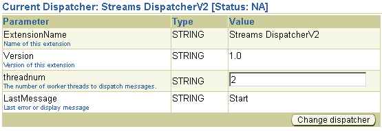

Setting the Dispatcher for the Oracle Sensor Edge Server Instance
Clicking the Change Dispatcher in the Main page (Figure 3-5), enables you to change the dispatcher used by the Oracle Sensor Edge Server. See also "Managing Dispatchers for an Oracle Sensor Edge Server Instance".
Figure 3-5 Changing Dispatchers
Description of Figure 3-5 follows
Description of "Figure 3-5 Changing Dispatchers"
From the Search and Select page (Figure 3-6) that appears, you can select an edge dispatcher to send event messages using such means as remote Web Services, Oracle Streams, or to a client application using HTTP.
Figure 3-6 Selecting a New Dispatcher
Description of Figure 3-6 follows
Description of "Figure 3-6 Selecting a New Dispatcher"
An Oracle Sensor Edge Server instance uses only one dispatcher at a time. After you assign a dispatcher as current, the Oracle Sensor Edge Server instance must be restarted. See "Starting and Stopping the Oracle Sensor Edge Server Instance".

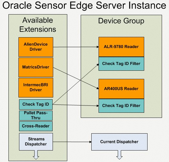

Setting the Devices and Filters Used by the Oracle Sensor Edge Server
To enable the Oracle Edge Sensor Server instance to receive, filter and dispatch event data, you must first create a device group, a logical grouping of devices (the instances of drivers) and the filters associated with these devices. An Oracle Sensor Edge Server instance can have one or many device groups instantiated. Each device group is responsible for all of the devices (and their associated filters) included within it.
Device groups make one or more devices into a logical device or "group." You use device groups to associate devices for processing as a single streams of events. For example, If you create device group called Warehouse Exits consisting of all of the devices placed at all of the exits of a warehouse (and if needed, add a filter instance to this group), then all of the generated events are viewed as originating from one logical device rather than from several devices.
You can group devices in terms of management if you want to treat them as a logical unit to manage (such as in the case of the aforementioned Warehouse Exits device group), or you can group them by the type of filtering they perform (as illustrated in Figure 3-8). For example, if you group devices by cross-reader filtering, then you create a group of related devices and then attach filters to that group. For more information, see "Managing the Filter Instances for a Device or Device Group"
Figure 3-8 Reader Devices Grouped by Filter
Description of Figure 3-8 follows
Description of "Figure 3-8 Reader Devices Grouped by Filter"

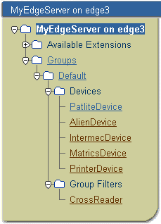

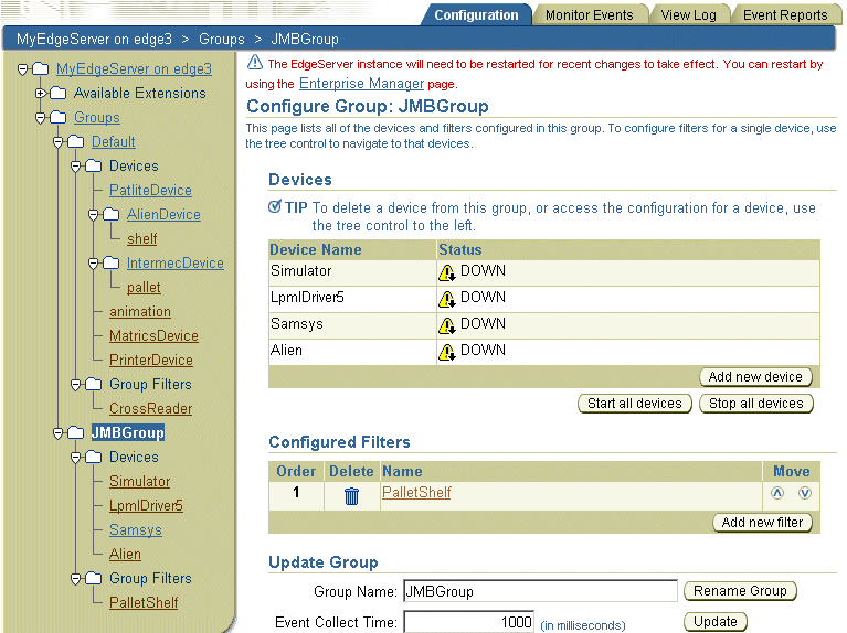

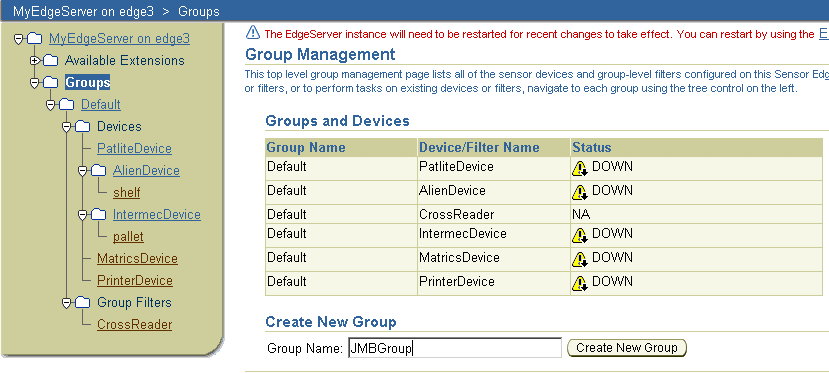

Viewing the Device Groups of the Oracle Sensor Edge Server
Clicking the Groups folder invokes the Group Management page (Figure 3-9), which lists the device groups and their respective filters. In addition, the page lists the running status of the devices for each group. This page also enables you to create a new device group (as described in "Creating a Device Group"). To view the configuration of a specific device group, expand the Groups folder and then select the appropriate node to invoke the Configure Group page for the selected device group. The default device group is called Unassigned and is a special reserved group. For more information on Configure Group page, see "Editing a Device Group".
Figure 3-9 Configuring a Device Group
Description of Figure 3-9 follows
Description of "Figure 3-9 Configuring a Device Group "

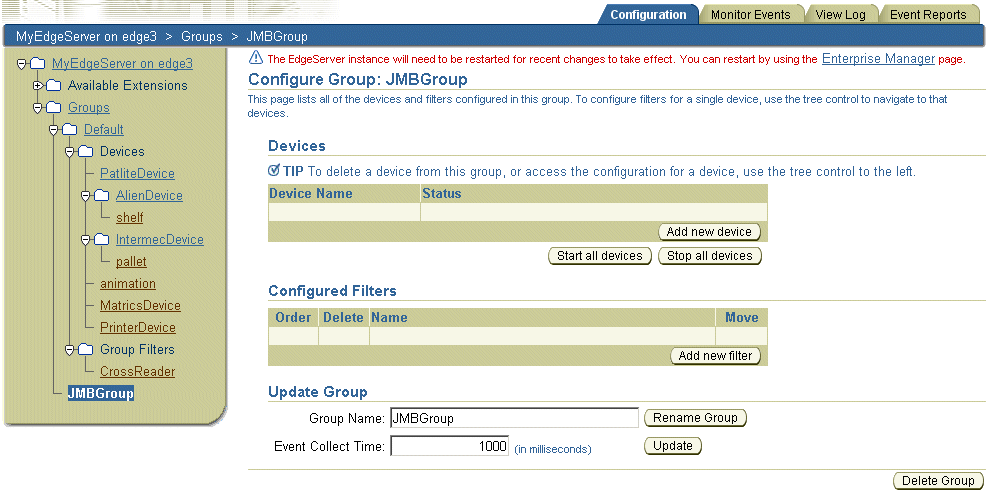

Creating a device group is the first step to connecting the Oracle Sensor Edge Server instance to devices and filters. Once you create a device group, you populate it with devices (the instances of the available drivers) and then attach filter instances to the individual devices (or to the entire device group). To create a new device group:
  1. In the Group Management page, enter a name for the device group in the Group Name field and then click Create New Group. The Configure Group page appears for the new device group.

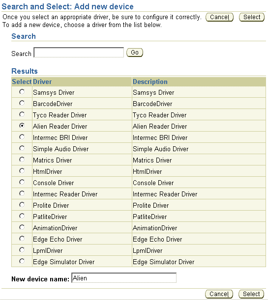

  2. Create a device (a driver instance) for the device group by clicking Add new device. The Search and Select page appears, listing the drivers in the repository.
    Figure 3-11 Selecting a Driver for the Device
    Description of Figure 3-11 follows
    Description of "Figure 3-11 Selecting a Driver for the Device"
    Tip:
    Locate a driver by entering the name of the driver (or part of the driver name) in the Search field and then by clicking Go.
    1. Select a driver for the device. Table 3-3 describes the drivers supported by Oracle Sensor Edge Server. For descriptions of the these drivers, the configuration parameters required to create devices from them, and the models supported by these drivers, see Chapter 6, "Configuring Devices, Filter Instances, and Dispatchers".
      Table 3-3 Supported Drivers
      Readers Indicators, Notification and Display Printers Other
      The drivers that support readers include:
      The drivers that support notification and display include:
      LpmlDriver (See "Configuring LpmlDriver-Based Devices".)
      Edge Echo Driver (See "Configuring Edge Echo Driver-Based Instances".)
    2. If needed, enter a name for the device in the New Device Name field. If you do not assign a name to the device, then Oracle Sensor Edge Server assigns a default name.
    3. Click Select. The Configure Group page reappears, listing the device in the Devices section. The navigation tree also displays the device.

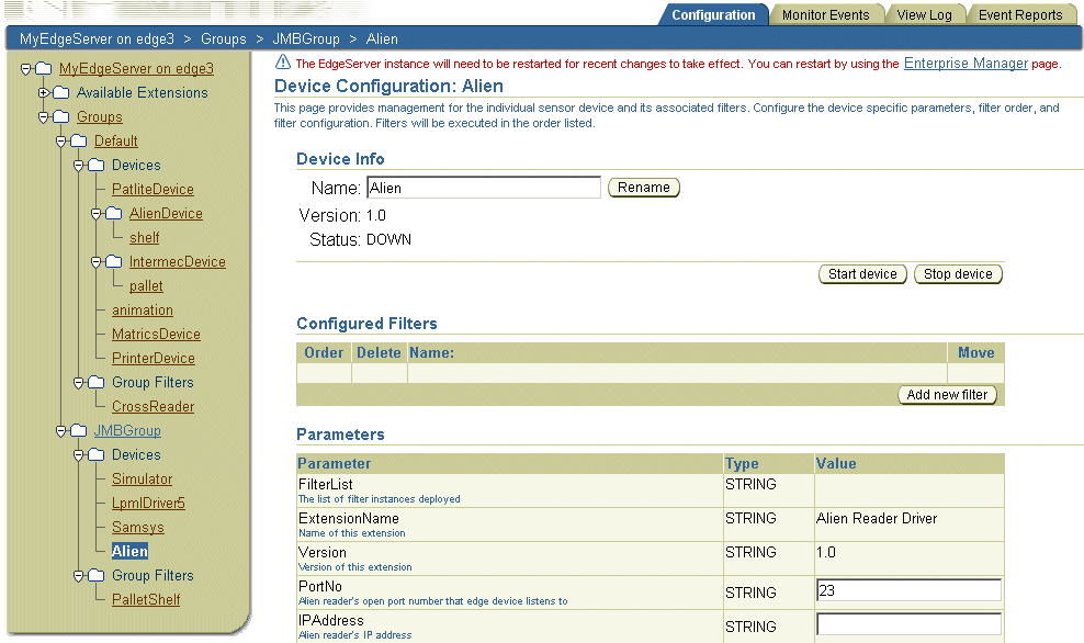

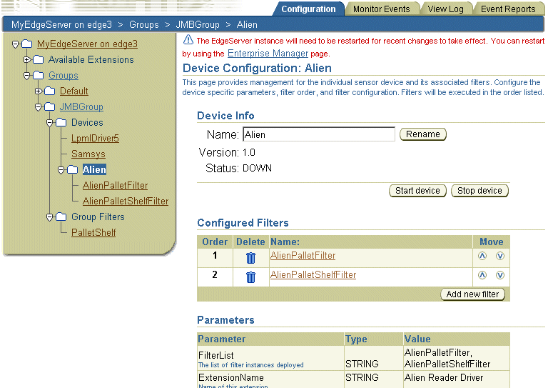

  3. Configure the device by first selecting it from the tree. The Device Configuration page appears (Figure 3-13), displaying the parameters specific to the driver.
    1. Define the parameters. For more information on the driver parameters, see "Configuring Devices".
    2. Click Save Changes.

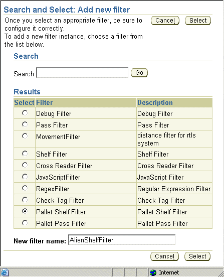

  4. Add filters (filter instances) to the device by clicking Add new filter. The Search and Select page appears (Figure 3-14), listing the filters in the repository. Table 3-5 lists the Oracle Edge Sensor Server's seeded device- and group-level filters.
    Figure 3-14 Selecting a Filter
    Description of Figure 3-14 follows
    Description of "Figure 3-14 Selecting a Filter"
    1. Select a filter instance for the device.
      Tip:
      Locate a filter by entering the name of the filter (or part of the filter name) in the Search field and then by clicking Go.
    2. If needed, enter a name for the device in the New Filter Name field. If you do not assign a name to the filter instance, then Oracle Sensor Edge Server assigns a default name.
    3. Click Select. The selected filter appears in the Configured Filters section of the device's configuration page (Figure 3-15) and in the tree under the device.

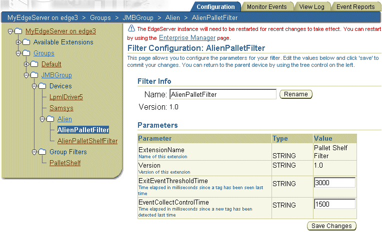

  5. Configure the filter instance by first selecting the filter instance from the table in the Configured Filters section of the Device Configuration page, or from the tree. The Filter Configuration page appears (Figure 3-16), displaying the parameters of the selected filter.
    1. If needed, rename the filter instance.
    2. Define the filter parameters. For more information on filter parameters, see "Configuring Filter Instances".
    3. Click Save Changes.
      You must stop and then restart the Oracle Sensor Edge Server after you create, edit or delete a device group. For more information, see "Starting and Stopping the Oracle Sensor Edge Server Instance".
The Configure Group page (Figure 3-9) enables you to edit the properties of a device group. This page, which appears when you click a device group in the navigation tree (Figure 3-2), enables you to do the following tasks:
Renaming a Device Group
To rename a device group:
  1. Enter a new name for the device group in the Group Name field.
  2. Click Rename Group. The new group name appears in the tree.
Updating the Devices and Filters Used by a Device Group
You can add devices and filter instances to a device group using the Add new device and Add new filter buttons described in "Creating a Device Group". Once you complete the device and filter instance assignments, click Update.
Starting and Stopping the Devices Assigned to a Device Group
You must stop and then start device groups whenever you perform such tasks as adding new devices or filter instances. You start and stop the devices belonging to a device group using the Start all devices and Stop all devices buttons.
Deleting a Device Group
The Delete Group button enables you to remove a device group from the Oracle Sensor Edge Server. When you delete a device group, you also remove all of the devices and filter instances that have been configured for the group. Once you delete a device group, you must re-start entire Oracle Sensor Edge Server for the change to take effect.
Once you have modified an Oracle Sensor Edge Server instance, you must restart the Oracle Sensor Edge Server to commit the changes. You can stop and restart the Oracle Sensor Edge Server using either of the following methods:
Stopping and Starting an Oracle Sensor Edge Server Instance Using opmnctl
After you change the Oracle Sensor Edge Server's general settings, its dispatcher, or edit any device group, you can stop and restart the Oracle Sensor Edge Server using the opmnctl shutdown and opmnctl startall commands. For more information, see Oracle Process Manager and Notification Server Administrator's Guide.
Restarting an Oracle Sensor Edge Server Instance Using the OracleAS Enterprise Manager
When you change anything in an Oracle Sensor Edge Server instance, the SES Console displays a message (Figure 3-17) notifying you to restart the Oracle Sensor Edge Server instance using OracleAS Enterprise Manager. This message includes a link to OracleAS Enterprise Manager.

To restart an Oracle Sensor Edge Server instance:
  1. Click the Enterprise Manager link in the message (Figure 3-17). The login page for OracleAS Enterprise Manager appears.
  2. After you enter the OC4J user name and password, the cluster topology page appears.
  3. Navigate to the Home page (Figure 3-18).
  4. Click Applications.
  5. Select edge.
  6. Click Restart.

Managing Filters
Filters can be attached to either a specific device or to a device group. Some filters, such as the Cross-Reader Redundant filter, are written as group-level filters and can only be attached to a device group. A device group filter provides filtering of events before they are delivered to an edge device. While some filters are written only for device groups, others are written only for device-level filtering and only function if they are attached to a specific device.
The Configured Filters tables of the Device Configuration (Figure 3-12) and Configure Group (Figure 3-15) pages enable you to add, delete, or reorder the filter instances. The add new filter button enables you to add additional filter instances to a device or to a device group. For more information, see "Creating a Device Group" and "Adding a Filter to a Device Group". Clicking the table's trash can icon enables you to remove a filter instance from a device or device group. The table's arrows enable you to prioritize the filter instances.
Prioritizing Filter Instances
The order of filter instances affects the efficacy of the data filtering. For example, if a device or device group is assigned a group filter, which groups IDs into an array of events and treats them as one item and a tag filter the filters out the events for a specific tag, TagXYZ, then applying the group filter before the tag filter results in the Oracle Sensor Edge Server receiving events grouped into chunks based on when they were detected, but only after the tag filter has strained out the events for TagXYZ. Reversing the order of the filters (that is, putting the group filter before the tag filter) would prevent the tag filter from filtering out anything, because it would see only the group events and not those for TagXYZ.
Using the arrows in the Configured Filters table (Figure 3-15), you can arrange the filter instances by selecting a filter instance and then moving it up or down using the arrows.
A filter instance is an instantiated object of a filter. Whenever a filter is applied to a device (or to a device group), a filter instance is created, enabling the device or device group to use the filter.
Although you can develop your own filters and then upload them (see "Adding Extensions to the Oracle Sensor Edge Server Instance"), Oracle Sensor Edge Server ships with several filters (described in Table 3-5).
Table 3-5 The Pre-Seeded Filters of the Oracle Sensor Edge Server

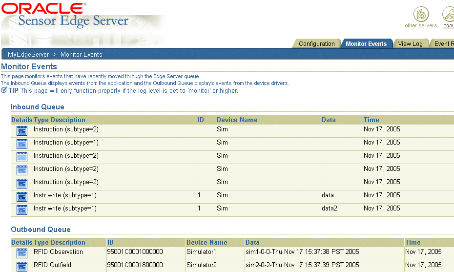

Viewing Unprocessed Event Data
The SES Console enables you to view this event data in real-time from its Monitor Events tab. Clicking the Monitor Events tab displays the Monitor Events page (Figure 3-21).
Figure 3-21 The Monitor Events Page
Description of Figure 3-21 follows
Description of "Figure 3-21 The Monitor Events Page"
The Monitor Event page enables you to view all of the inbound event data and the outbound event data that passes through the queue. The event data displayed on this page has not been processed; it has not been sent to the Sensor Data Repository.
Tip:
The event data displayed in the Monitor Events page is dynamic and often-changing; if data remains static, then devices may not be sending events or receiving instruction events.

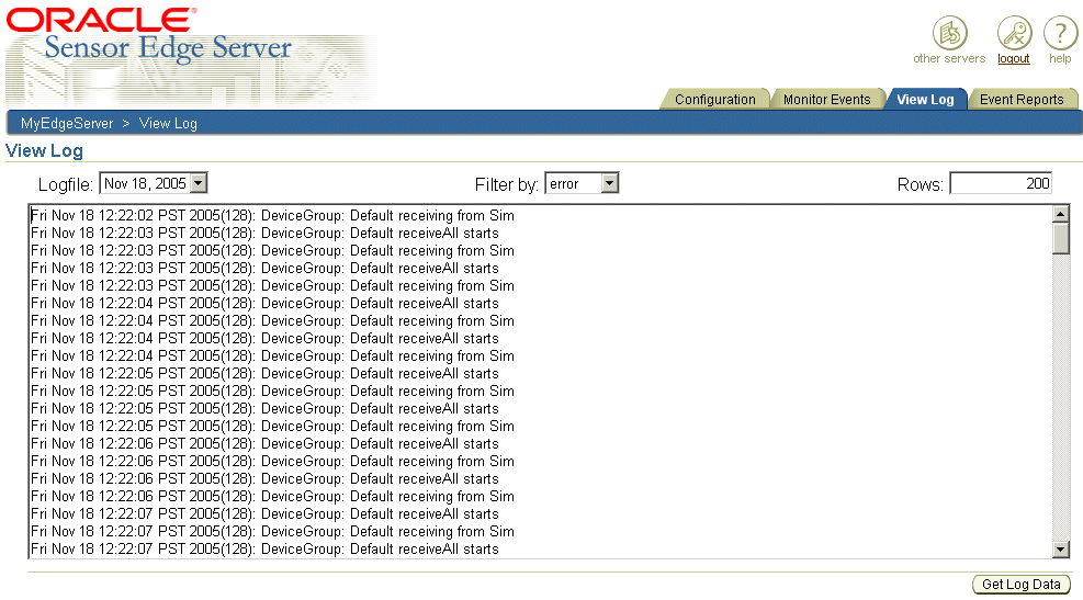

The View Log page (Figure 3-22), which you access from the View Log tab, displays data written to the log according to the severity level selected from the Log Level list located on the Main page (Figure 3-1). For example, if you selected Error from the Main page, then the View Log page only displays error-level messages; if you selected All from the Main page, then the View Log page displays all of the logging data.
Figure 3-22 The View Log Page
Description of Figure 3-22 follows
Description of "Figure 3-22 The View Log Page"
Using the View Log page, you can select the log file by date and set the number of rows displayed in this page.
To view log data:
  1. Select the date for the log file from the Logfile list.
  2. If needed, select a log level from the Filter by list.
  3. If needed, enter the number of rows for display in the Rows field.
  4. Click Get Log Data.

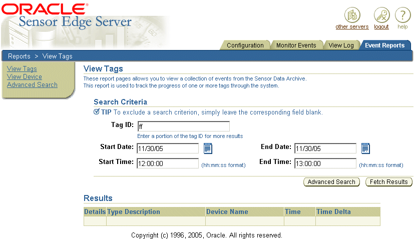

When you click the Events Reports tab, the View Tags page (Figure 3-23) appears by default.
Figure 3-23 The View Tags Page
Description of Figure 3-23 follows
Description of "Figure 3-23 The View Tags Page"
You can select other types of event searches using the navigation tree in the View Tags page. The tree appears in all of the pages accessed through the Events Reports tab.

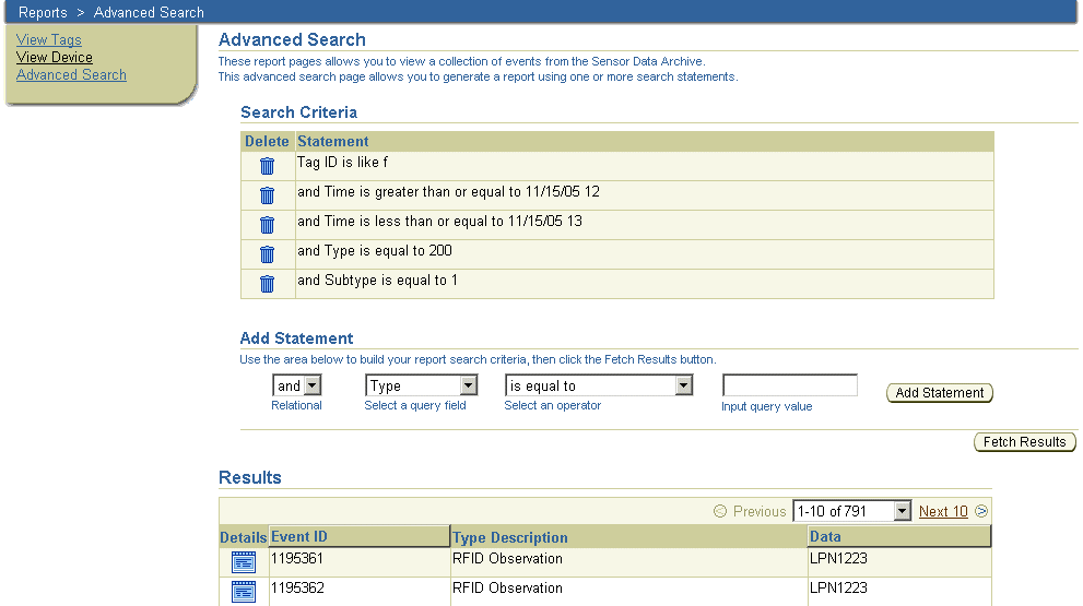

Searching for Events by Tag ID
To retrieve events by tag ID:
  1. Enter a portion of the tag ID. (This is a like pattern.)
  2. Enter a starting date, or select a starting date using date-time editor. This is an optional condition; leaving this field blank excludes this condition from the search.
  3. Enter a starting time (as hh:mm:ss). This is an optional condition; leaving this field blank excludes this condition from the search.
  4. Enter an ending date, or select an ending date using the date-time editor. This is an optional condition; leaving this field blank excludes this condition from the search.

Searching for Events by Device Name
To retrieve events by device name:
  1. Enter the device name (or a portion of the device name). This is a like pattern.
  2. Enter a starting date, or select a starting date using the date-time editor. This is an optional condition; leaving this field blank excludes this condition from the search.
  5. Enter an ending time (as hh:mm:ss). This is an optional condition; leaving this field blank excludes this condition from the search.
    Tip:
    Clicking within the End Time field populates the End Date field with the same value as that entered in the Start Date field.
  6. Click Fetch Results. The search results appear in the Results table. Clicking the Details icon enables you view a specific event. For more information, see "Refining Tag ID and Device Name Searches". To add conditions to the search, click Advanced Search.

Creating Advanced Searches
The Advanced Search page enables you retrieve specific event data by constructing a query comprised of statements to retrieve event data using the event data's Metadata and Payload information.
Figure 3-25 The Advanced Search Page
Description of Figure 3-25 follows
Description of "Figure 3-25 The Advanced Search Page"
To create specific search criteria for event data:
  1. Using the Select a query field list, select the event Metadata (such as Event ID, Device Name, Source Name, Site Name, Type, Subtype and Correlation ID) and the Payload (Tag ID, Data, and Time).
  2. Select an operator to compare the search value selected from the Select a query field list to the value entered in the Input query value field. Options include:
    • is equal to
    • is not equal to
    • is less than
    • is less than or equal to
    • is greater
    • is greater than or equal to
    • is like
  3. Enter a value in the input query value field that is relevant to the option selected in the Select a query field. For example, select Type from the Select a query field and then enter 200 in the input query value field.
    Tip:
    The Relational list appears once you complete a query and click Add Statement. This list enables you to bind the query statements using compound search conditions (and, or, not). Use the trash can icons to remove a query statement.
  4. Click Add Statement. The search statement appears in the Search Criteria section.
  5. If needed, add other statements.
  6. Click Fetch Results. The Sensor Data Repository is queried using the selected search statements. The results display in the Results section of the page. You can sort the data in ascending and descending order by Event ID and by Data. To view an individual event, click the Details icon. For more information, see "Viewing an Individual Event"

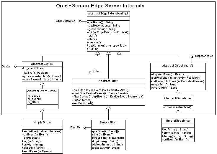

Extension Class Hierarchy
All of the extensions of the Oracle Sensor Edge Server are arranged as:
EdgeObject—The basic root class, which contains a unique identifier.
AbstractEdgeExtensionImpl—Implements the EdgeExtension interface.
  • AbstractDispatcherV2—The base class for all dispatchers.
    • AbstractDispatcher—Implements AbstractDeviceV2 class to provide basic dispatcher behavior.
      • SimpleDispatcher—Enables you to build custom dispatchers.
AbstractFilter—The base class for all filters. It implements the Filter interface and defines the monitoring API for filters required to generate events that monitor filter performance.
  • SimpleFilter—Enables you to write both device-level and device group-level filters.
AbstractDevice—The base class for all devices. It provides its own thread for reading data from the device and processing the read data.
  • AbstractEventDevice—Extended from AbstractDevice class; provides integration with the device-level filters and implements the required methods to propagate events to the event processor.
    • SimpleDriver—Provides the common functionality required by most custom drivers. Many of the drivers that ship with Oracle Sensor Edge Server are extended from SimpleDriver.
Extend from the SimpleDriver, SimpleFilter, or SimpleDispatcher classes to create an extension.
Figure 3-26 illustrates the extension class hierarchy.
Figure 3-26 The Edge Extension Hierarchy
Description of Figure 3-26 follows
Description of "Figure 3-26 The Edge Extension Hierarchy"
