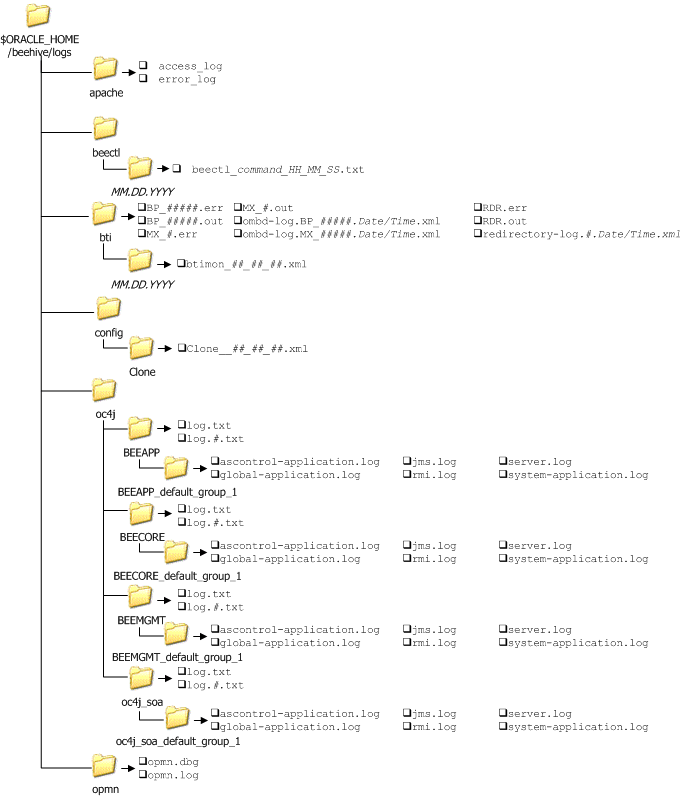

Oracle Beehive logs are located in the following directory:
$ORACLE_HOME/beehive/logs
A variety of directories and files will appear within the $ORACLE_HOME/beehive/logs directory. The folders represent different functional areas of Oracle Beehive. The sub-directories and files that are in your logs directory depend on the types of operations performed with your Oracle Beehive deployment.
Once a beectl command has been used, for example, a beectl sub-directory will appear under $ORACLE_HOME/beehive/logs directory. Within the beectl directory, directories represented using a date MM.DD.YYYY format will be created. Each MM.DD.YYYY directory represents the day on which the information was logged. A log file denoting the beectl command that was used will appear under the dated directory.
Within the $ORACLE_HOME/beehive/logs/oc4j directory, sub-directories are named after managed components and will typically include a log.txt file and a series of files named log.txt.#. The # in log.txt.# represents an archived version of the log file. The most recent log file is always log.txt.
For more information about log archiving options refer to the "Managing Logs" section.
Figure 15-1 outlines what you might typically expect to see in the $ORACLE_HOME/beehive/logs directory.
The directory structure on your Oracle Beehive deployment may have additional or fewer files and directories.
Figure 15-1 Oracle Beehive Log Directory Structure
The Oracle Beehive logs directory structure
Description of "Figure 15-1 Oracle Beehive Log Directory Structure"
The $ORACLE_HOME/beehive/logs/config/clone directory will only exist in the log directory structure in cloned environments.
