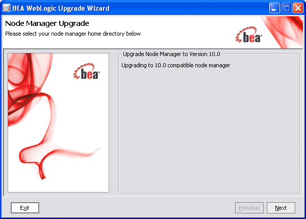

  5. At a command prompt, enter the following command:
  6. java weblogic.Upgrade -type nodemanager [-out file]
    The -out argument is optional. It allows you to designate a file in which you want all standard output (stdout) and error messages to be written. By default, these messages are written to the command window and a summary of them is displayed at the end of the upgrade process.
    After you run the command, the WebLogic Upgrade Wizard opens, as shown in the following figure.
    Figure 4-1 WebLogic Upgrade Wizard for Node Manager
  1. Click Next to proceed to the next window.

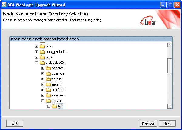

Node Manager Home Directory Selection
Select a home directory for the instance of Node Manager to be upgraded by navigating the local directory hierarchy.
The Node Manager home directory contains the nodemanager.properties file, logs, and other related files. The exact set of files generated by Node Manager varies between releases and service packs.
By default, the Node Manager home directory is WL_HOME/common/nodemanager, where WL_HOME specifies the root directory of the WebLogic Server installation, as shown in the following example.
Figure 4-2 Node Manager Home Directory Selection
