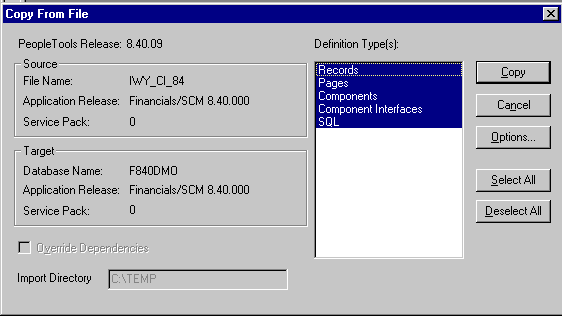

The Copy Project From File dialog box opens.
Navigate to the original directory in which you unzipped the file.
Click Open (in release 8.4) or Copy (in release 8.1) to open the Copy From File dialog box.

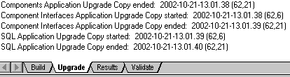

Although the preceding figures illustrate PeopleSoft release 8.4, the corresponding instructions are accurate for releases 8.1 and 8.4.Highlight all objects listed in Definition Type(s), and then click Copy.
The Application Designer displays the following message, which indicates successful completion.

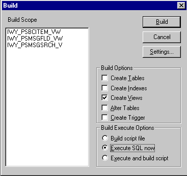

To build the views in the project, select Build, and then select Project.
The Build dialog box is displayed.
In the Build Options pane, select Create Views.
Select your site's customary option in the Build Execute Options pane. (In the previous figure, Execute SQL now is selected.)
Click Build.
The Application Designer displays a Build Progress status window.

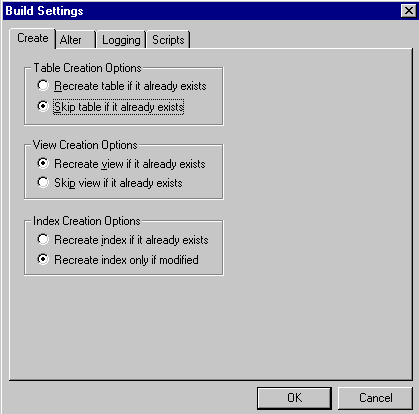

If you encounter problems, check the Build settings options by selecting Build, and then Settings.
The Build Settings dialog box is displayed.
Depending on the application server database for PeopleSoft, some databases may require the Tablespace name. Consult your PeopleSoft database administrator for more information regarding this function.

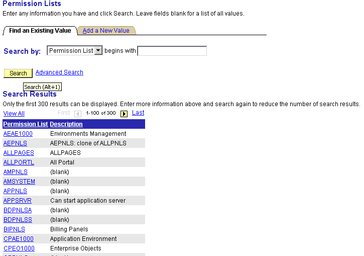

Select PeopleTools, Security, User Profiles, Permissions & Roles, and then Permission Lists.
Click Search and select the relevant Permission List.
The Permission List pane opens on the right.

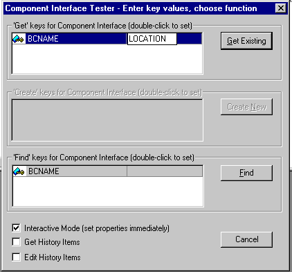

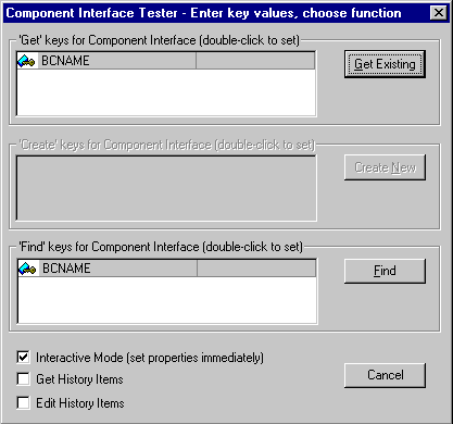

The Component Interface Tester dialog box is displayed.

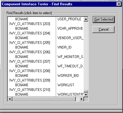

The Create New option is disabled because the Add method is not applicable to this Component Interface.Click Find. Entries for the underlying component appear.
A message may appear stating that display is limited to a certain number of entries. This is not a problem.
Highlight one of the lines with its corresponding key in the Find Results window and click Get Selected. The relevant data for the selected key is displayed.
If this window opens, the Component Interface has been successfully tested for the Find method.

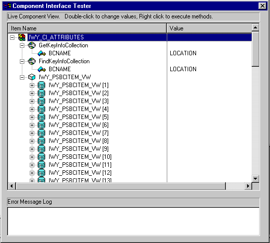

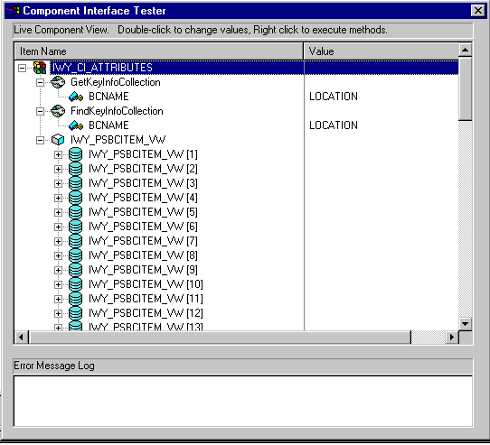

Click Get Existing. For the Get method, an existing key must be entered.
The exposed properties for the key that is entered are returned.
If the following window opens, the the Component Interface has been successfully tested for the Get
method.
