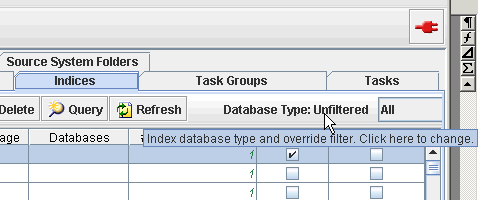

The following actions are available in the top pane toolbar and in the right-click menu when the Indices tab is active. Database Filter
The database filter appears in the Indices tab to the right of the top pane toolbar, as shown in Figure 11. Click on the words "Database Type" to open the Index Filtering dialog box. It allows you to filter the set of displayed indices based on the database type. To display all indices regardless of database type, select the option All.
Figure 11. Indices Tab Database Filter
