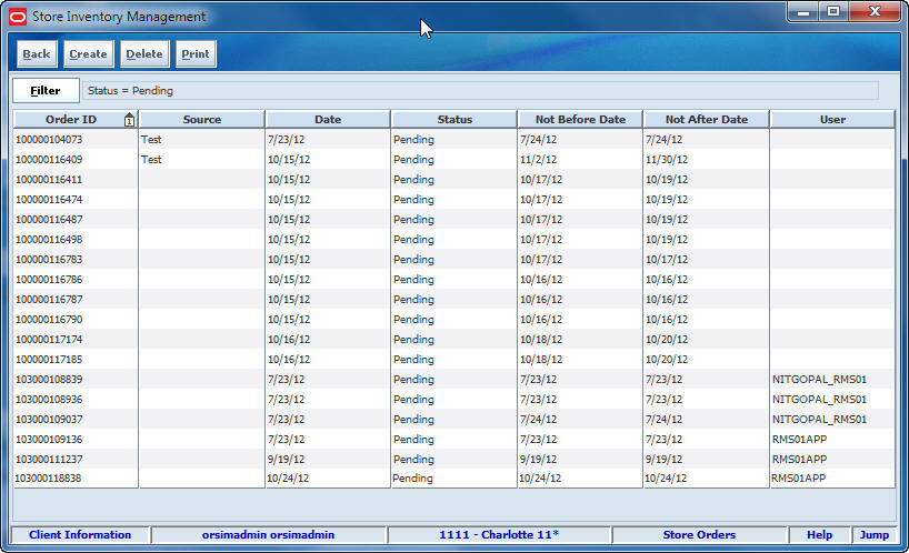

Navigate: Main Menu > Inventory Mgmt > Store Orders. The Store Orders window opens.
From the Store Orders window, you can do the following:
From the Store Orders window, click Back to return to the Inventory Management menu.
At any time while the Store Orders window is open, you can also change how the list is filtered.
Current filtering is displayed next to the Filter button on the Store Orders window. If no filtering is displayed, all items are currently selected and listed.

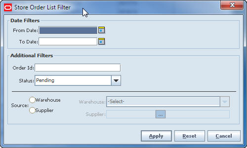

To filter the store orders listed in the Store Orders window, follow these steps:
Click Filter. The Store Order List Filter window opens.
Enter or select search values as needed to specify the store orders that you want to list. All values are optional. If you leave a field blank or select All, all values are included in the search.
Date Filters – Enter or select From Date and To Date values to limit the date range.
Order ID – Enter the Order ID.
Status – Select Approved, Closed, Pending, or All.
Warehouse or Supplier – Select either the Warehouse or Supplier radio button. For a warehouse, select the warehouse from the drop-down list. For a supplier, enter the supplier or click the Ellipsis button to look up the supplier. See ”Supplier Lookup” in Chapter 20 for more information.
Click Apply. You return to the Store Orders window, where your filter has been applied.

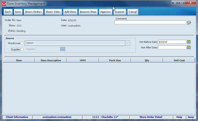

Create store orders to replenish items for which you have the authority to place orders from the store.
To create a store order, follow these steps:
Click Create Order. The Store Order Detail window opens.
Note: While the Store Order Detail window is open, you can also view details about items on the order. See ”View Item Details." |
Select the source of the item:
Supplier – Enter a supplier ID or click the Ellipsis button to look up a supplier.
In the Supplier Lookup window, locate and select the supplier you want. Click Apply to return to the Store Order Detail window.
Warehouse – Select a warehouse from the drop–down list.
Specify a delivery date range:
In the Not Before Date field, enter a date or click the Calendar button to select the date.
In the Not After Date field, enter or select a date.
Note: For warehouse orders, the Not After Date field is disabled. |
Enter item information:
Click Add Item. A new blank line is added to the store order list, or click Scanner to scan the item. See ”Scan an Item (Scanner Button)” in Chapter 2 for more information.
In the Item field, enter the item number, or click the Ellipsis button to look up the item.
In the Item Lookup window, locate and select the item you want. Click Apply to return to the Store Order Detail window. See ”Item Lookup” in Chapter 20 for more information.
Edit item information. Change values as needed in the following fields:
UOM – From the drop-down list, select the appropriate unit of measure.
Qty – If the displayed quantity is not correct, double-click and enter the correct quantity.
Repeat Steps a through c to add more items to the store order.
Click Save. Your order is saved and you return to the Store Orders window. Your order appears in Pending status.
