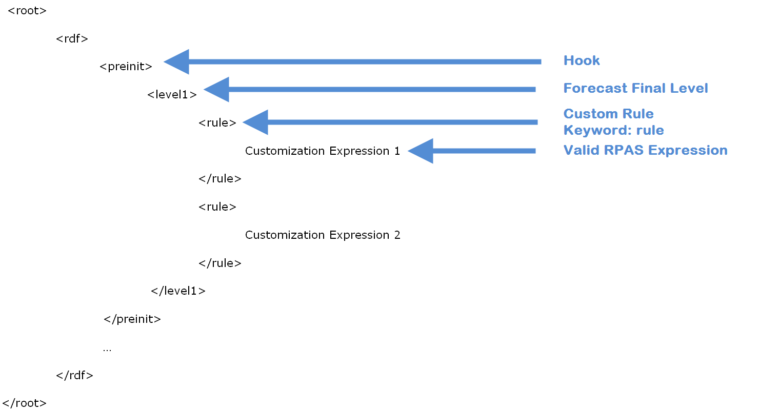

Each phase of the batch cycle begins and ends with a hook that links to the next phase. Table F-1 lists and describes the RDF batch phases along with its hooks. These hooks are provided in the RDF Generate utility and defined in the appcust.xml file as shown in Figure F-1.

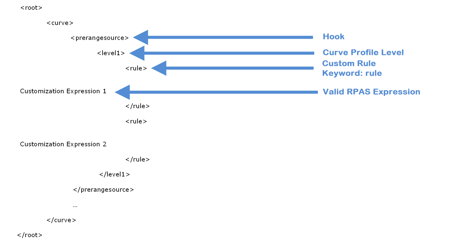

Each phase of the batch cycle begins and ends with a hook that links to the next phase. Table F-2 lists and describes the Curve batch phases along with its hooks. These hooks are provided in the Curvebatch utility and defined in the appcust.xml file as shown in Figure F-2.

The format of the RDF appcust.xml file is shown in Figure F-1.
The format of the Curve appcust.xml file is shown in Figure F-2.
