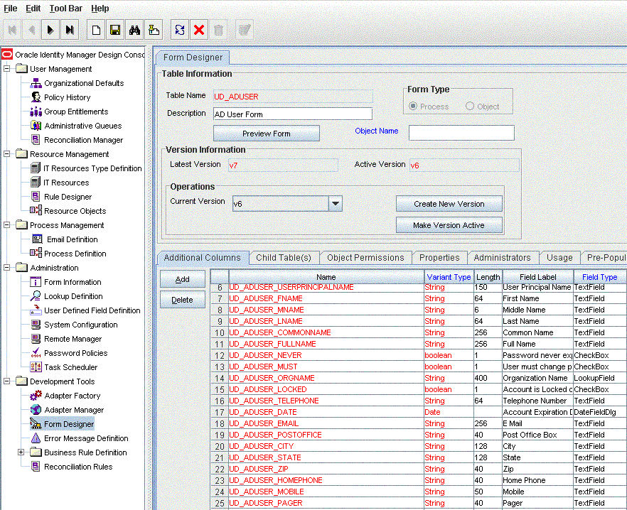

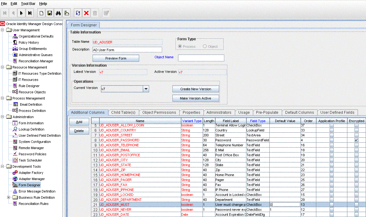

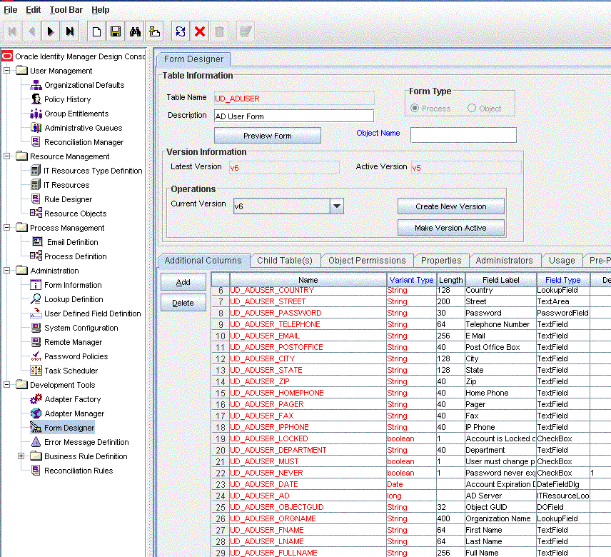

Add the new field on the process form as follows:
Expand Development Tools.
Double-click Form Designer.
Search for and open the UD_ADUSER process form. For groups, search for UD_ADGRP process form.
Click Create New Version, and then click Add.
Enter the details of the field.
For example, if you are adding the Employee ID field, enter UD_ADUSER_EMPLOYEE_ID in the Name field and then enter other details such as Variable Type, Length, Field Label, and Field Type.
Click Save, and then click Make Version Active. Figure 4-1 shows the new field added to the process form.
Figure 4-1 New Field Added to the Process Form

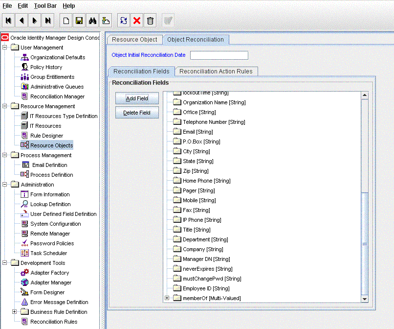

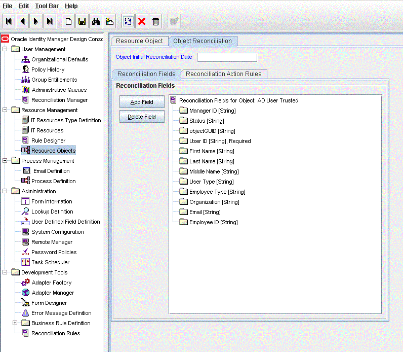

Add the new field to the list of reconciliation fields in the resource object as follows:
Expand Resource Management.
Double-click Resource Objects.
Search for and open the AD User resource object. For groups, search for and open the AD Group resource object
On the Object Reconciliation tab, click Add Field.
For example, enter Employee ID in the Field Name field and select String from the Field Type list.
Later in this procedure, you will enter the field name as the Decode value of the entry that you create in the lookup definition for reconciliation.
Click Save. Figure 4-2 shows the new reconciliation field added to the resource object.
Figure 4-2 New Reconciliation Field Added in the Resource Object

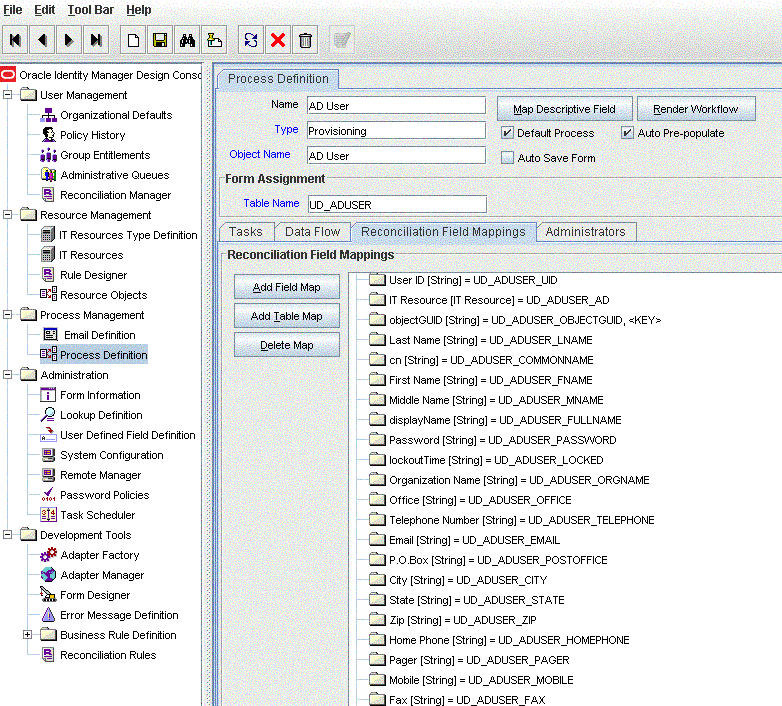

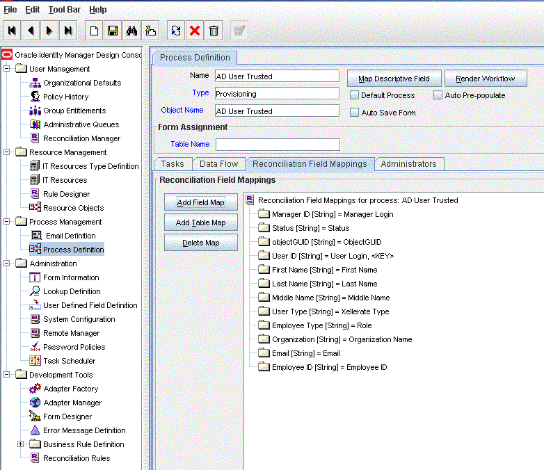

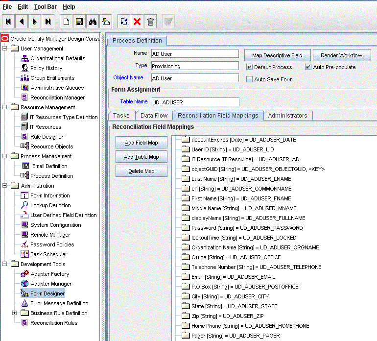

Create a reconciliation field mapping for the new field in the process definition as follows:
Expand Process Management.
Double-click Process Definition.
Search for and open the AD User process definition. For groups, search for and open the AD Group process definition.
On the Reconciliation Field Mappings tab of the AD User (or AD Group) process definition, click Add Field Map.
In the Field Name field, select the value for the field that you want to add.
Double-click the Process Data Field field, and then select UD_ADUSER_EMPLOYEE_ID.
Click Save. Figure 4-3 shows the new reconciliation field mapped to a process data field in the process definition.
Figure 4-3 New Reconciliation Field Mapped to the Process Data Field

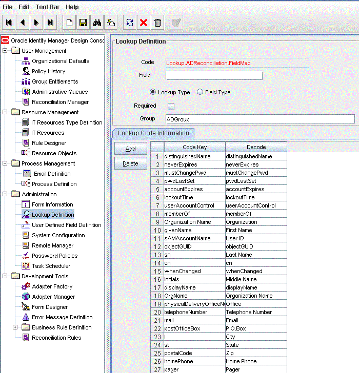

For a user field on Microsoft ADAM, open Lookup.ADAMReconciliation.FieldMap.
For a group field on Microsoft Active Directory, open Lookup.ADGroupReconciliation.FieldMap.
For a group field on Microsoft ADAM, open Lookup.ADAMGroupReconciliation.FieldMap.
For a user field, if the field that you want to add is an Environment, Remote Control, or Sessions field, then search for and open the Lookup.AD.BLOBAttribute.Values lookup definition.
You need not make any change in the VBScript file run by the Remote Manager during provisioning operations.Click Add and enter the Code Key and Decode values for the field. The Code Key value must be the name of the field on the target system, which you determined at the start of this procedure. The Decode value is the name that you provide for the reconciliation field in Step 3.e.
For example, enter employeeID in the Code Key field and then enter Employee ID in the Decode field.
Click Save. Figure 4-4 shows the lookup code added to the lookup definition.
Figure 4-4 Entry Added in the Lookup Definition

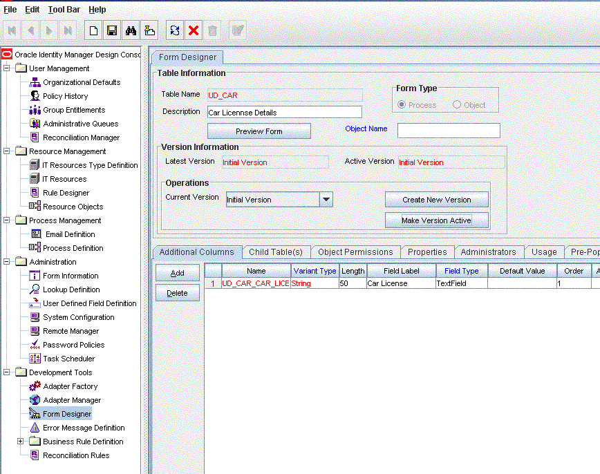

Create a form for the multivalued field as follows:
Create a form by specifying a table name and description, and then click Save.
Click Add and enter the details of the field.
Click Save and then click Make Version Active. Figure 4-5 shows the multivalued field added on a new form.
Figure 4-5 Multivalued Field Added on a New Form

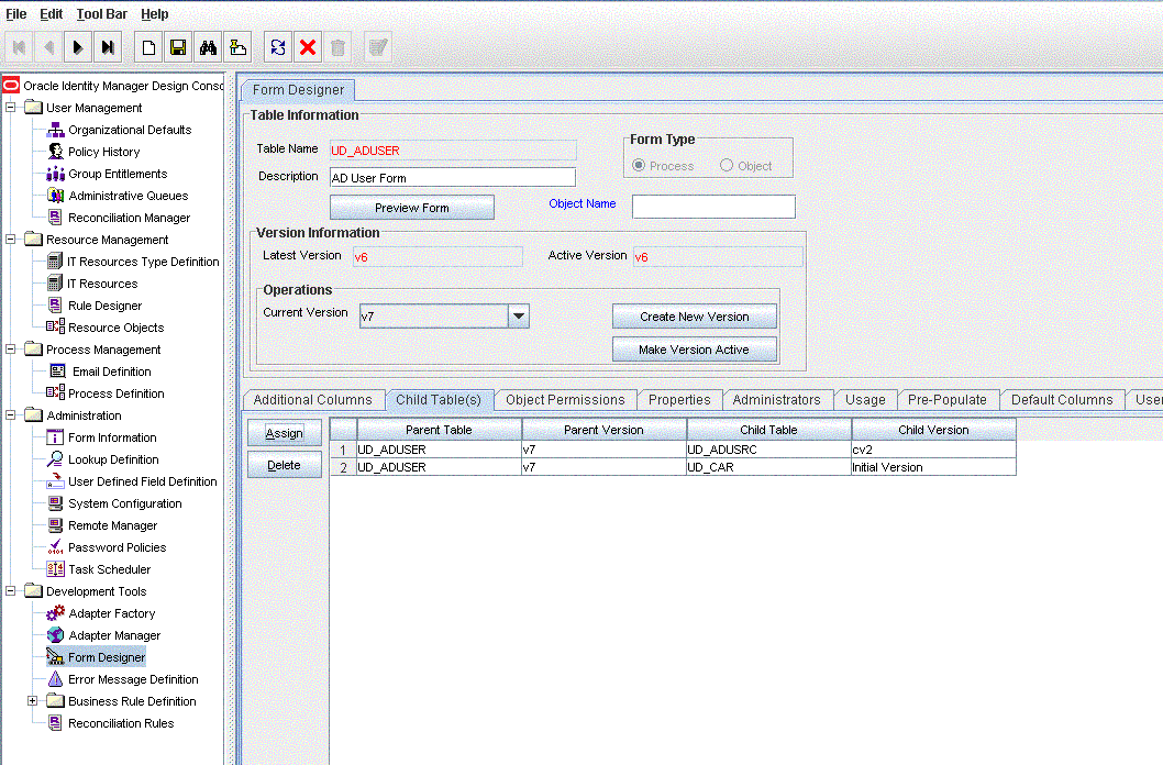

Add the form created for the multivalued field as a child form of the process form as follows:
Search for and open the UD_ADUSER process form. For groups, search for and open the UD_ADGRP process form.
Click Create New Version.
Click the Child Table(s) tab.
Click Assign.
In the Assign Child Tables dialog box, select the newly created child form, click the right arrow, and then click OK.
Click Save and then click Make Version Active. Figure 4-6 shows the child form added to the process form.
Figure 4-6 Child Form Added to the Process Form

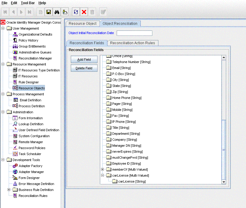

Search for and open the AD User resource object. For groups, search for and open the AD Group resource object.
In the Add Reconciliation Fields dialog box, enter the details of the field.
For example, enter carLicense in the Field Name field and select Multi Valued Attribute from the Field Type list.
Click Save and then close the dialog box.
Right-click the newly created field.
Select Define Property Fields.
In the Add Reconciliation Fields dialog box, enter the details of the newly created field.
For example, enter carLicense in the Field Name field and select String from the Field Type list.
Click Save, and then close the dialog box. Figure 4-7 shows the new reconciliation field added in the resource object.
Figure 4-7 New Reconciliation Field Added in the Resource Object
Create a reconciliation field mapping for the new field as follows:
On the Reconciliation Field Mappings tab of the AD User (or AD Group) process definition, click Add Table Map.
In the Add Reconciliation Table Mapping dialog box, select the field name and table name from the list, click Save, and then close the dialog box.
Right-click the newly created field, and select Define Property Field Map.
Double-click the Process Data Field field, and then select UD_CAR_LICENSE.
Select Key Field for Reconciliation Field Matching and click Save. Figure 4-8 shows the new reconciliation field mapped to a process data field in the process definition.
Figure 4-8 New Reconciliation Field Mapped to a Process Data Field

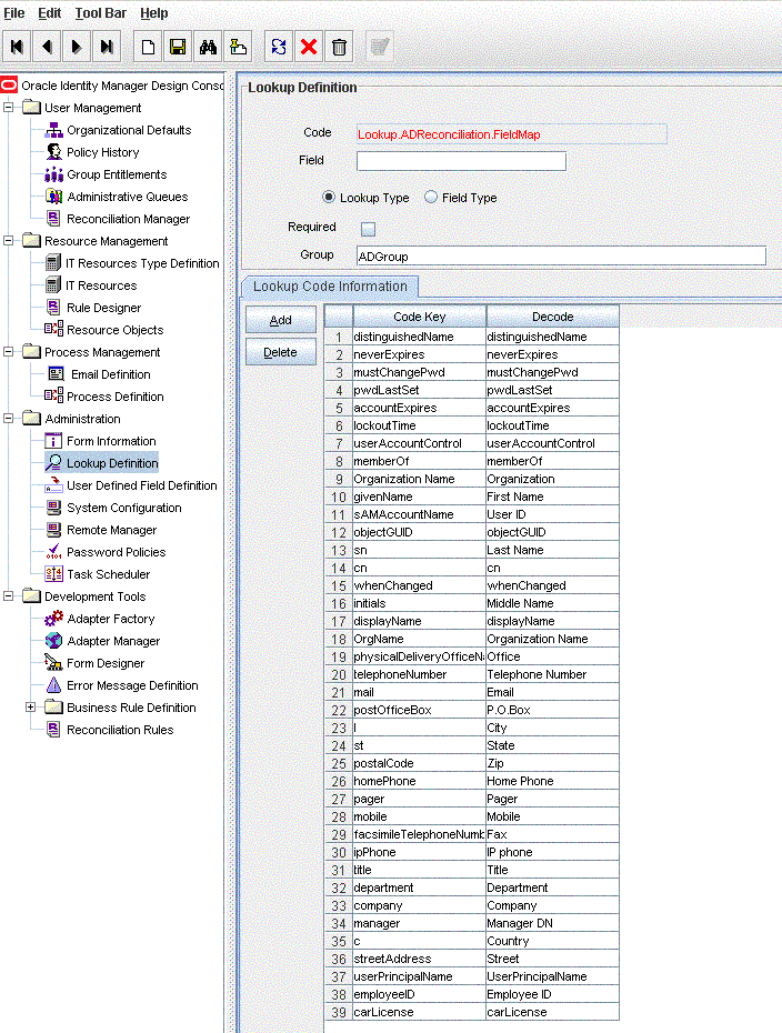

Create an entry for the field in the lookup definition for reconciliation as follows:
Expand Administration.
Double-click Lookup Definition.
Search for and open the Lookup.ADReconciliation.FieldMap (or Lookup.ADGroupReconciliation.FieldMap) lookup definition if the target system is Microsoft Active Directory.
For the target system fields, you must use the same case (uppercase or lowercase) as given on the target system. This is because the field names are case-sensitive.Search for and open the Lookup.ADAMReconciliation.FieldMap (or Lookup.ADAMGroupReconciliation.FieldMap) lookup definition if the target system is Microsoft ADAM.
Cick Add and enter the Code Key and Decode values for the field, and then Click Save. The Code Key value must be the name of the attribute field on the target system.
For example, enter carLicense in the Code Key field and then enter carLicense in the Decode field. Figure 4-9 shows the lookup code added to the lookup definition.
Figure 4-9 Entry Added in the Lookup Definition

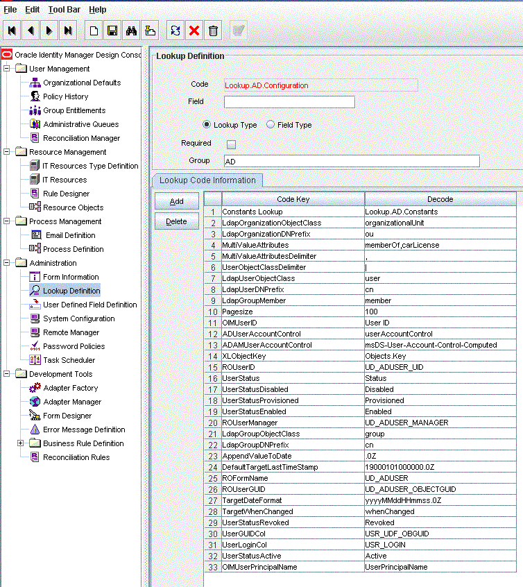

For a user field, add the multivalued field to the Lookup.AD.Configuration lookup definition as follows:
Search for and open the Lookup.AD.Configuration lookup definition.
Add multivalued attributes that are to be reconciled in the Decode field and click Save. The attributes must be separated by the Decode value entered in the MultiValueAttributesDelimiter field.
For example, if MultiValueAttributesDelimiter contains the semicolon (;) as the Decode value, then the Decode value of MultiValueAttributes must be memberOf;carLicense. In this value, the semicolon has been used as the delimiter character. Figure 4-10 shows the multivalued field added to the Lookup.AD.Configuration lookup definition.
Figure 4-10 Multivalued Field Added to the Lookup Definition

Add the new field on the process form.
If you have added the field on the process form by performing Step 2 of "Adding New Fields for Target Resource Reconciliation", then you need not add the field again. If you have not added the field, then:
For example, if you are adding the Employee ID field, enter UD_ADUSER_EMPLOYEE_ID in the Name field, and then enter the rest of the details of this field.
Click Save and then click Make Version Active. Figure 4-11 shows the new field added to the process form.
Figure 4-11 New Field Added to the Process Form

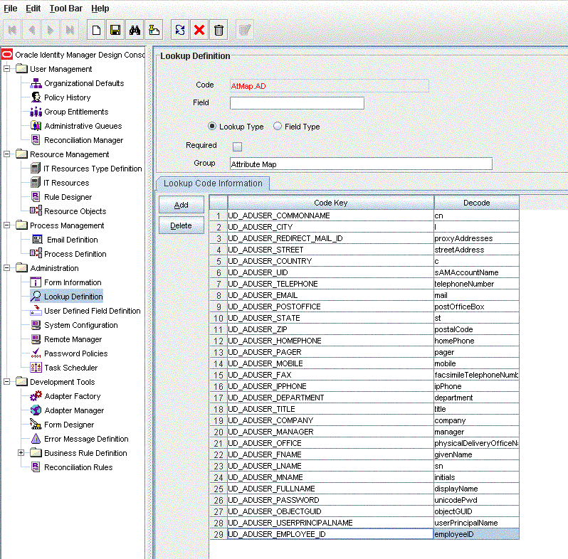

Create an entry for the field in the lookup definition for provisioning as follows:
If the field that you want to add is not an Environment, Remote Control, or Sessions field, then search for and open one of the lookup definitions:
If the field that you want to add is an Environment, Remote Control, or Sessions field, then search for and open the AtMap.AD.RemoteScriptlookUp lookup definition.
You need not make any change in the VBScript file run by the Remote Manager during provisioning operations.Cick Add and then enter the Code Key and Decode values for the field. The Decode value must be the name of the field on the target system, which you determined at the start of this procedure.
For the target system fields, you must use the same case (uppercase or lowercase) as given on the target system. This is because the field names are case-sensitive.For example, enter UD_ADUSER_EMPLOYEE_ID in the Code Key field and then enter employeeID in the Decode field. Figure 4-12 shows the entry added to the lookup definition.
Figure 4-12 Entry Added to the Lookup Definition

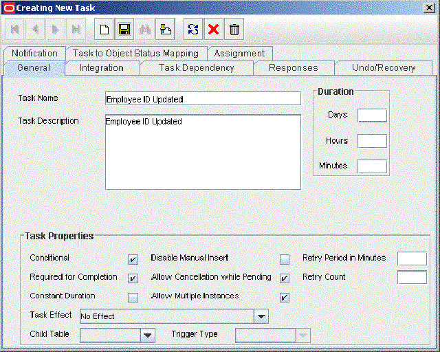

Click Add and enter the task name and the task description.
In the Task Properties section, select the following fields:
Conditional
Required for Completion
Allow Cancellation while Pending
Allow Multiple Instances
Click Save. Figure 4-13 shows the new task added to the process definition.

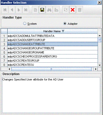

In the AD User process definition, select the adapter name in the Handler Type section as follows:
Go to the Integration tab, click Add and select Adapter.
In the Handler Type section, select adpADCSCHANGEATTRIBUTE for a user attribute or adpADCSGROUPCHANGEATTRIBUTE for a group attribute.
Click Save. Figure 4-14 shows the adapter added to the handler.

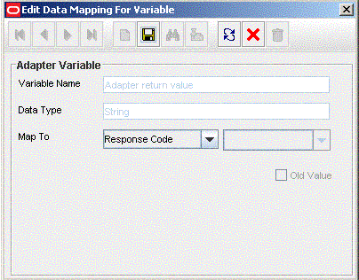

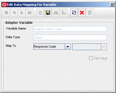

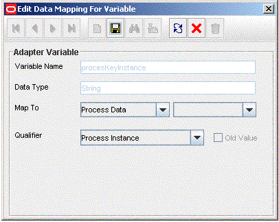

Double-click the Variable Name field to get the value and map the adapter variable to Response Code Figure 4-15 shows the variable name mapped to Response Code.
Figure 4-15 Adapter Return Value Mapped to Response Code

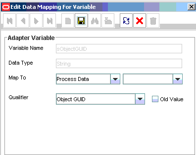

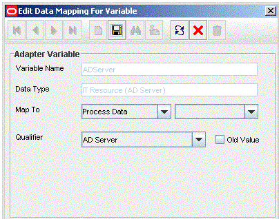

Double-click the Variable Name field to get the value and map the adapter variable to a process data field. Figure 4-16 shows the variable name mapped to a process data field.
Figure 4-16 Adapter Variable Mapped to a Process Data Field

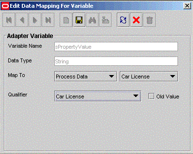

Double-click the Variable Name field to get the value and map the adapter variable to a process data field. Figure 4-17 shows the adapter variable mapped to a process data field.
Figure 4-17 Adapter Variable Mapped to a Process Data Field

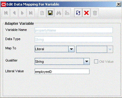

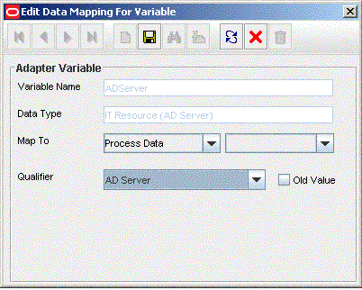

Double-click the Variable Name field to get the value and map the adapter variable with the corresponding field on the target system, which you determined in the "Adding New Fields for Provisioning". For example, enter employeeID for updating Employee ID. Figure 4-18 shows the adapter variable mapped to a target system field.
Figure 4-18 Adapter Variable Mapped to a Target System Field

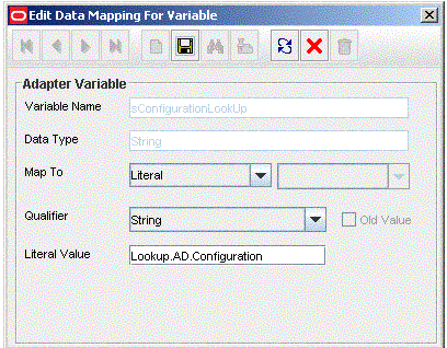

If you create a copy of the Lookup.AD.Configuration lookup definition, then:
Double-click the Variable Name field and select the sConfigurationLookUp variable.
Map the variable to the literal value Lookup.AD.Configuration.
Figure 4-18 shows the adapter variable mapped to the literal.
Figure 4-19 Adapter Variable Mapped to a Literal

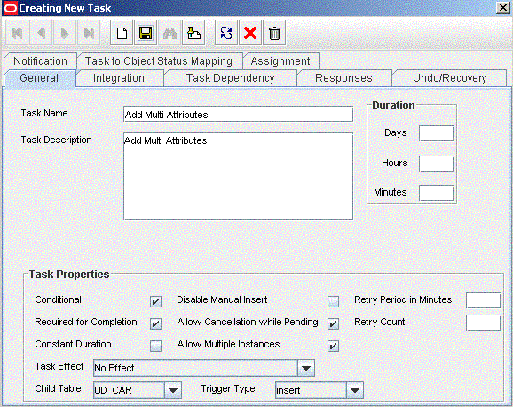

To add new multivalued fields for provisioning:
Before starting the following procedure, perform Steps 1 through 3 as described in the section "Adding New Multivalued Fields for Target Resource Reconciliation". If these steps have been performed while adding new multivalued fields for target resource reconciliation, then you need not repeat the steps.Log in to the Oracle Identity Manager Design Console.
In the process definition, add the task for provisioning multivalued attributes as follows:
Search for and open the AD User process definition. For groups, open the AD Group process definition.
Click Add and enter the task name and the description.
In the Task Properties section, select the following:
Conditional
Retry Count
Child table name from the Child Table list
Insert, if you want to add the data, from the Trigger Type list
Delete, if you want to remove the data, from the Trigger Type list.
Click Save. Figure 4-20 shows the multivalued task added to the process.
Figure 4-20 Multivalued Field Added to the AD User Provisioning Process

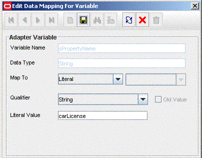

Double-click and map the adapter variable to a literal and specify the name of the attribute to be updated in the Literal Value field, and then click Save. Figure 4-22 shows the adapter variable mapped to a literal.
Figure 4-22 Adapter Variable Mapped to a Literal

Auto Pre-populate and Auto Save are two of the options available in the resource object. You use the Auto Pre-populate option to specify whether a custom form will be populated by Oracle Identity Manager or a user. You use the Auto Save option to specify that Oracle Identity Manager must save the data, without user intervention, in any resource-specific form that was created using the Form Designer form.
See Also:
Oracle Identity Manager Design Console Guide for more information about both optionsIf you want to use either of these options, then specify default values for mandatory check boxes of the process definition as follows:
Log in to the Design Console.
Expand Development Tools, and double-click Form Designer.
On the Additional Columns tab:
For the UD_ADUSER_MUST field, enter a value (0 or 1) in the Default column.
For the UD_ADUSER_NEVER field, enter a value (0 or 1) in the Default column.
Click Save.
Figure 4-27 shows the default values specified for the Checkbox field types on the process form.
Figure 4-27 Default Values Specified for the Checkbox Field Types on the Process Form

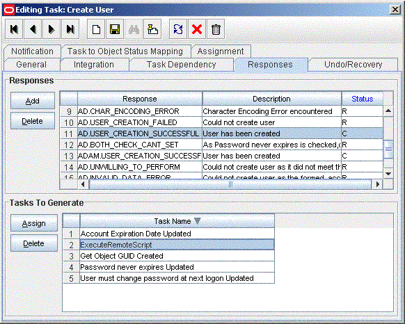

During a provisioning operation, the ExecuteRemoteScripts process task is used to set values for the Terminal Services Profile fields of the target system. This process task is triggered after successful completion of the Create User process task, even if values are not entered for the Terminal Services Profile fields on the process form. If you do not want the ExecuteRemoteScripts process task to be triggered, then:
Search and open the AD User process definition.
Search for and open the Create User process task.
On the Responses tab, select AD.USER_CREATION_SUCCESSFUL.
From the Task Name list, select ExecuteRemoteScript and then click Delete.
Click Save. Figure 4-28 shows ExecuteRemoteScript deleted from the process form.

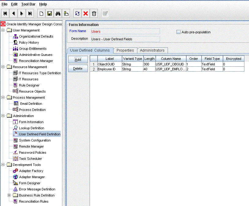

Add the new field on the OIM User process form as follows:
Double-click User Defined Field Definition.
Search for and open the Users form.
For example, if you are adding the Employee ID field, then enter Employee ID in the Name field, set the data type to String, enter USR_UDF_EMPLOYEE_ID as the column name, and enter a field size value.
Click Save. Figure 4-29 shows the new field added on the User Defined Columns tab of the Users form.
Figure 4-29 New Field Added to the Users Form
Expand the Resource Management folder.
Search for and open the AD User Trusted resource object.
Enter the details of the field and click Save.
Later in this procedure, you will enter the field name as the Decode value of the entry that you create in the lookup definition for reconciliation. Figure 4-30 shows the new field added to the process data field in the process form.
Figure 4-30 New Field Added to the Resource Object
Search for and open the AD User Trusted process definition.
On the Reconciliation Field Mappings tab, click Add Field Map.
For example, select Employee ID = Employee ID.
Click Save. Figure 4-31 shows the new reconciliation field mapped to a process data field in the process definition.
Figure 4-31 New Reconciliation Field Mapped to a Process Data Field
Search for and open the Lookup.ADReconciliation.FieldMap lookup definition.
Search for and open the Lookup.ADAMReconciliation.FieldMap lookup definition if you are using Microsoft ADAM.
Cick Add and then enter the Code Key and Decode values for the field. The Code Key value must be the name of the field on the target system, which you determined at the start of this procedure. The Decode value is the name that you provide for the reconciliation field in Step 3.e.
For the target system fields, you must use the same case (uppercase or lowercase) as given on the target system. This is because the field names are case-sensitive.For example, enter employeeID in the Code Key field and then enter Employee ID in the Decode field.
Click Save.
Select Field Type and click Save. Figure 4-32 shows the entry added to the lookup definition.
Figure 4-32 Entry Added to the Lookup Definition

The User Principal Name field on the process form is pre-populated with values from the User ID field and the UPN Domain IT resource parameter. Before you switch to a different IT resource during a provisioning operation, you must change the IT resource to which the User Principal Name field is mapped.
Expand Development Tools, and double-click Form designer.
Search for and open the AD User form.
On the Pre-Populate tab, double-click the User Principal Name row.
In the Pre-Population adapter dialog box, double-click the IT resource that you are currently using (for example, ADITResource).
From the Qualifier list in the Map Adapter Variables dialog box, select the IT resource that you want to use. For example, select ADITResource2. Then, click the Save icon and close the dialog box.
In the Pre-Population adapter dialog box, click the Save icon and close the dialog box.
Click the Save icon on the Form Designer form.

To create a copy of the connector:
Create copies of the IT resource, resource object, process form, provisioning process, scheduled tasks, and lookup definitions that hold attribute mappings.
Create a copy of the Lookup.AD.Configuration lookup definition. In the copy that you create, change the values of the following entries to match the details of the process form copy that you create.
ROUserID
ROUserManager
ROFormName
ROUserGUID
See "Configuring the Lookup.AD.Configuration Lookup Definition" for information about these entries.
Map the new process tasks to the copy of the Lookup.AD.Configuration lookup definition.
