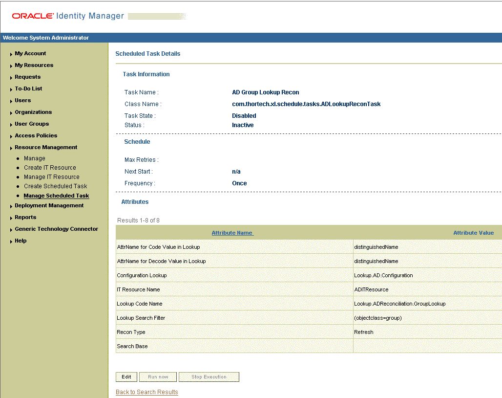

The procedure to configure these scheduled tasks is described later in the guide.This scheduled task is used to synchronize group lookup fields in Oracle Identity Manager with group-related data in the target system.
This scheduled task is used to synchronize organization lookup fields in Oracle Identity Manager with organization-related data in the target system.
Table 3-2 describes the attributes of both scheduled tasks.
Table 3-2 Attributes of the Scheduled Tasks for Lookup Field Synchronization
| Attribute | Description |
 Lookup Search Filter  |
 This attribute holds the filter or query condition for lookup synchronization.
 Note: You must not change the value of this attribute.  |
 Search Base  |
 Enter the DN of the organization in which the search for the lookup field (group or organization) values must be performed during reconciliation. Sample values:
 Recon Type  |
 Enter
 Enter
 Default value:   |
 IT Resource Name  |
 Enter the name of the IT resource that you configure by performing the procedure described in "Configuring the IT Resource for the Target System". Sample value:   |
 AttrName For Decode Value In Lookup  |
 This attribute holds the name of the target system field that is used to populate the Decode column of the lookup definition.
 AttrName For Code Value In Lookup  |
 This attribute holds the name of the target system field that is used to populate the Code Key column of the lookup definition.
 Lookup Code Name  |
 This attribute holds the name of the lookup definition that contains mappings between the lookup fields of the target system and corresponding lookup definitions created in Oracle Identity Manager.  |
 Configuration Lookup  |
 This attribute holds the name of the lookup definition containing values that are used during both reconciliation and provisioning: Value:  Note: You must not change the value of this attribute. However, if you create a copy of this lookup definition, then you can enter the unique name of the new lookup definition as the value of the Configuration Lookup attribute.  |
When you run the Connector Installer, scheduled tasks for user reconciliation are automatically created in Oracle Identity Manager. Configuring reconciliation involves providing values for the attributes of these scheduled tasks.

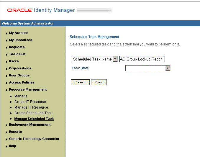

To configure a scheduled task:
Log in to the Administrative and User Console.
Expand Resource Management.
Click Manage Scheduled Task.
On the Scheduled Task Management page, enter the name of the scheduled task as the search criteria and then click Search.
Figure 3-1 shows the Scheduled Task Management page.
Figure 3-1 Scheduled Task Management Page
In the search results table, click the edit icon in the Edit column for the scheduled task. Figure 3-2 shows the Scheduled Task Details page.
On the Edit Scheduled Task Details page, you can modify the following details of the scheduled task by clicking Edit:
Status: Specify whether or not you want to leave the task in the enabled state. In the enabled state, the task is ready for use.
Max Retries: Enter an integer value in this field. This number represents the number of times Oracle Identity Manager must attempt to complete the task before assigning the ERROR status to the task. The default value is 1.
Next Start: Use the date editor to specify the date when you want the task to run. After you select a date value in the date editor, you can modify the time value that is automatically displayed in the Next Start field.
Frequency: Specify the frequency at which you want the task to run.
When you click Edit, the Edit Scheduled Task page is displayed. Figure 3-3 shows this page.
After modifying the values for the scheduled task details listed in the previous step, click Continue.
Specify values for the attributes of the scheduled task. To do so, select each attribute from the Attribute list, specify a value in the field provided, and then click Update.
Attribute values are predefined in the connector XML file that you import. Specify values only for the attributes that you want to change.
Values (either default or user-defined) must be assigned to all the attributes. If even a single attribute value is left empty, then reconciliation is not performed.
Figure 3-4 shows the Attributes page. The attributes of the scheduled task that you select for modification are displayed on this page.
Click Save Changes to commit all the changes to the database.

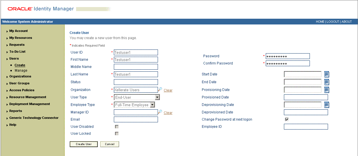

From the Users menu:
Select Create if you want to first create the OIM User and then provision a Microsoft Active Directory account to the user.
Select Manage if you want to provision a Microsoft Active Directory account to an existing OIM User.

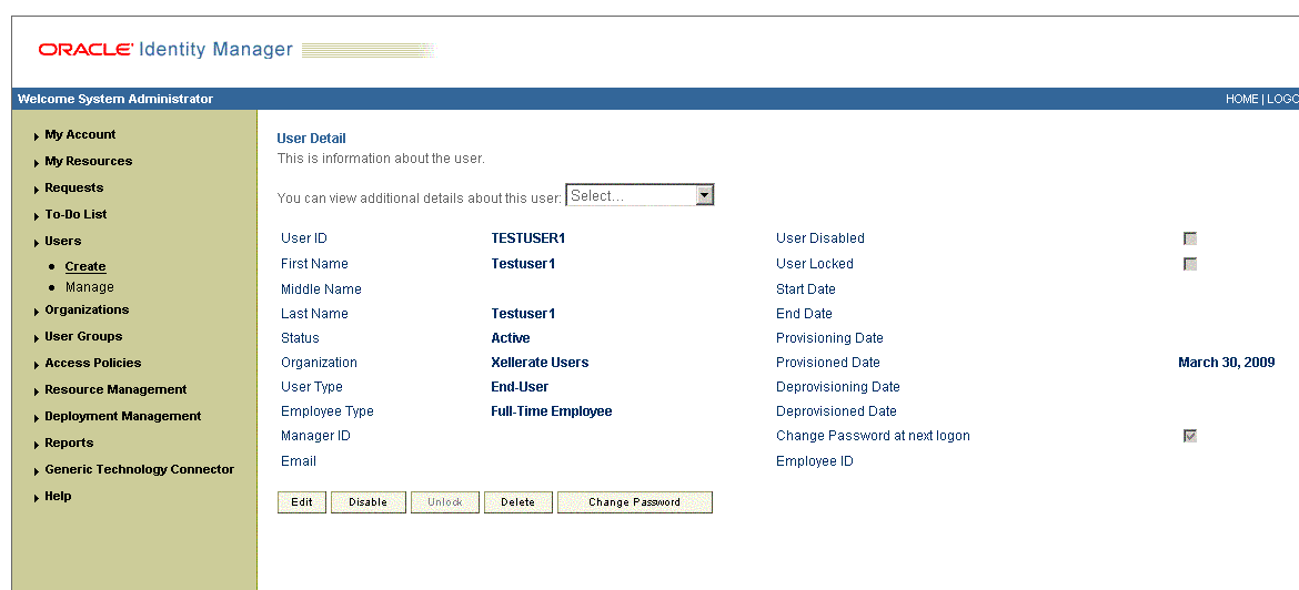

If you select Create, on the Create User page, enter values for the OIM User fields and then click Create User. Figure 3-5 shows the Create User page.
If you select Manage, then search for the OIM User and select the link for the user from the list of users displayed in the search results.

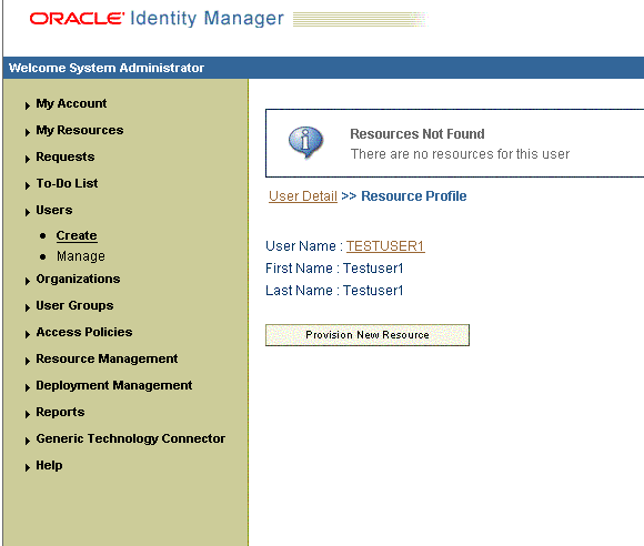

On the User Detail page, select Resource Profile from the list at the top of the page. Figure 3-6 shows the User Detail page.
On the Resource Profile page, click Provision New Resource. Figure 3-7 shows the Resource Profile page.

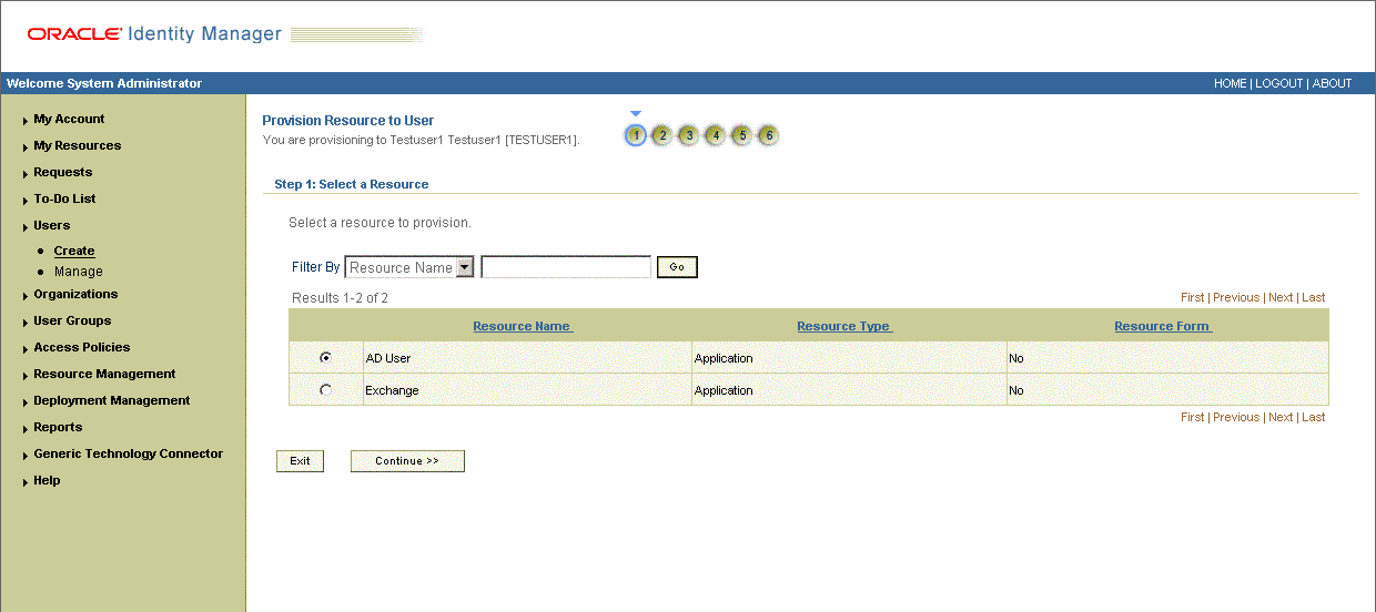

On the Step 1: Select a Resource page, select AD User from the list and then click Continue. Figure 3-8 shows the Step 1: Select a Resource page.
Figure 3-8 Step 1: Select a Resource Page

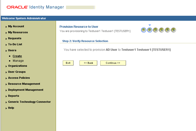

On the Step 2: Verify Resource Selection page, click Continue. Figure 3-9 shows the Step 2: Verify Resource Selection page.
Figure 3-9 Step 2: Verify Resource Selection Page

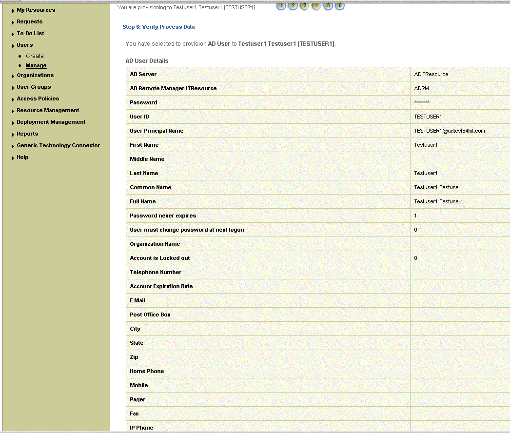

On the Step 6: Verify Process Data page, verify the data that you have provided and then click Continue. Figure 3-12 shows Step 6: Verify Process Data page.
Figure 3-12 Step 6: Verify Process Data Page
The Resource Profile page is displayed. Figure 3-13 shows this page. The resource that you provisioned is displayed on this page.
