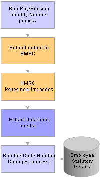

Tax Code UpdatesAt the end of every tax year, HMRC calculates employees’ tax codes for the next tax year. The Pay/Pension Numbers and Code Number Changes processes enable you to submit information to HMRC and receive updated tax codes electronically.
This diagram outlines the process:
Process for updating tax codes
The Code Number Changes process is discussed in an earlier chapter.
