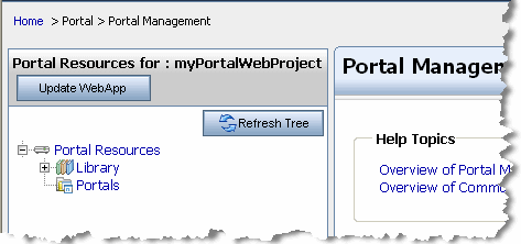

  1. Click the Portal Management menu shortcut on the Administration Console home page.
  2. The Portal Management page displays; the Portal Resources tree displays in the left pane of the page, as shown in Figure 4-3.
    Figure 4-3 Portal Resources Tree in the Administration Console
    Notice that the display is based on the Portal Web Project that you created in Creating a Portal in Your Development Environment. if you expand the Library > Portlets portion of the tree, you can see the portlets that you created earlier.

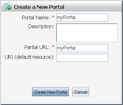

  5. Click Create New Portal.
  6. The Create a New Portal dialog displays, as shown in Figure 4-4.
    Figure 4-4 Create a New Portal Dialog in Administration Console
  7. Enter values for the portal, using Table 4-2 as a guide:
  8. Table 4-2 Create a New Portal Dialog Field Descriptions
    Field
    Value/Description
    Portal Name
    myPortal
    Partial URL
    myPortal
    URI (default resource)
    (leave blank)
  9. Click Create New Portal.
  10. When the Portals page displays again, the Browse Portals table includes the portal you created, and the Portal Resources tree includes the new portal.

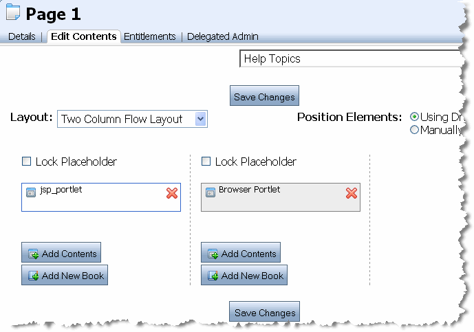

  5. Select the Edit Contents tab; it appears, as shown in Figure 4-8.
  6. Figure 4-8 Page 1 Edit Contents Tab
  7. Drag the Browser Portlet into the same placeholder as the Simple JSP Portlet, as shown in Figure 4-9.
  8. Figure 4-9 Moving the Browser Portlet by Dragging
    When you release the portlet, it displays above the Simple JSP Portlet, as shown in Figure 4-10.
  9. Click Save Changes.
  10. Figure 4-10 Result After Moving the Browser Portlet in the Administration Console

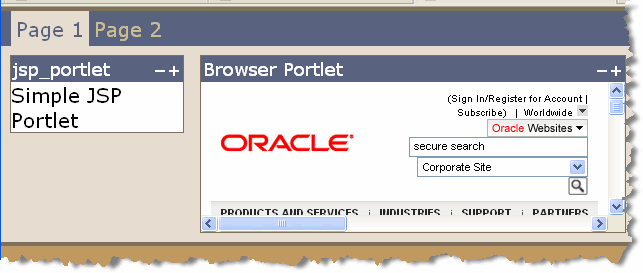

  13. The desktop displays in a browser, with the portlets in their new positions, as shown in Figure 4-11.
    Figure 4-11 Desktop in Browser Showing Moved Portlets

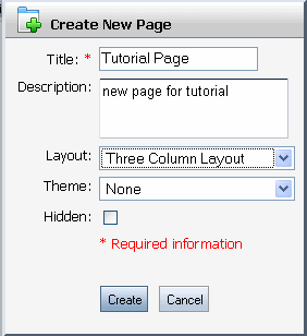

  5. Click Create New Page.
  6. The Create New Page dialog displays, as shown in Figure 4-14.
    Figure 4-14 Create New Page Dialog in Administration Console
  7. Enter values for the new page, using Table 4-4 as a guide:
  8. Table 4-4 Create New Page – Field Descriptions
    Field
    Value/Description
    Title
    Tutorial Page
    Description
    new page for tutorial
    Layout
    Three Column Layout
    Theme
    (leave as is - None)
    Hidden
    (leave as is - unchecked)
  9. Click Create.
  10. The new page is added, and is displayed in the Details page for the desktop; the Portal Resources tree updates to include the new page, as shown in Figure 4-15.
