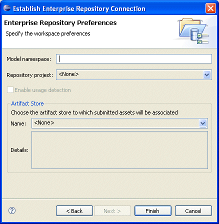

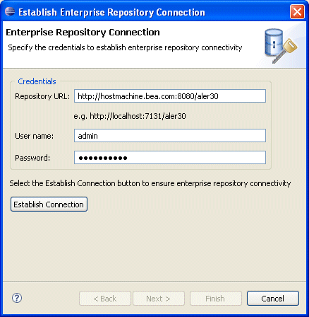

When you invoke an action on a repository, such as querying or publishing assets, before repository connectivity has been established, then the Connect to Enterprise Repository wizard will either be automatically displayed (in the case of querying the repository), or will be launched by an explicit user gesture.
Note: | If credential information had been specified in a previous session, the wizard will display this persisted information when it is launched. |
If a connection cannot be established, an appropriate error message will be displayed.
