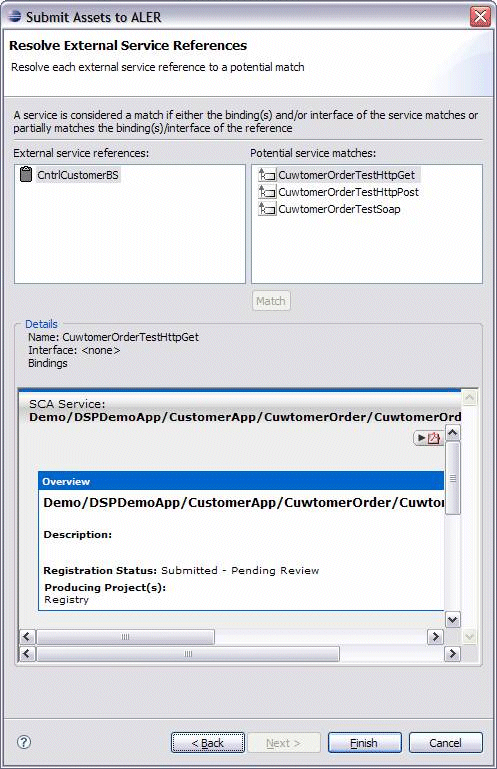

If a project contains unresolved external service references, you may want to resolve any unresolved references before submitting the project to the Enterprise Repository; however, this is not required.

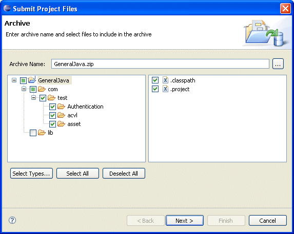

When you right-click an Eclipse project and select Submit to Oracle Enterprise Repository from the shortcut menu, Oracle Workshop for WebLogic plug-ins first determine if connectivity has been established to Oracle Enterprise Repository. If a connection is not yet established, the Connect to Enterprise Repository wizard is launched to establish connectivity.

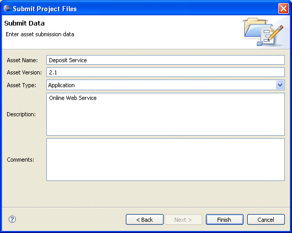

Once connectivity is established, the Oracle Enterprise Repository plug-in determines whether the associated project can be submitted as an Assembly Model (see Submitting Assembly Models to the Repository) or as an Archive File. When it is an Oracle Enterprise Repository project, the Submit Project Files wizard allows you to select and update an existing archive with assets to submit to Oracle Enterprise Repository.
.zip
file extension. The project will appear as an asset in the Submitted - Pending Review folder in the Oracle Enterprise Repository Asset Editor file tree. You can also refresh the data in the Enterprise Repository View’s Results pane to view the asset in Pending Review status. You can also click the asset to view more details. For more information, see The Results Pane.

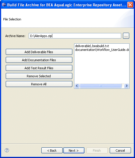

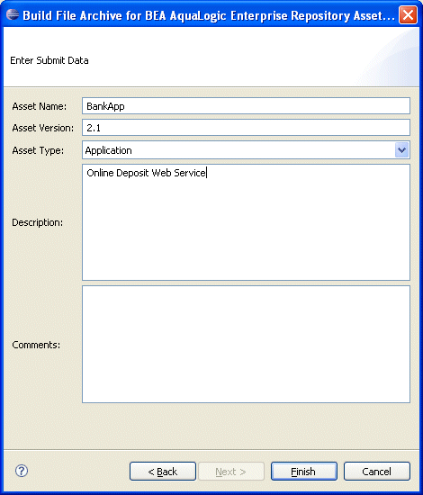

The Archive Submission wizard maintains support for legacy functionality for AquaLogic Enterprise Repository 2.x or earlier releases. This allows you to submit single and/or compound-payload assets to Oracle Enterprise Repository by creating an asset archive ZIP file.
To build an archive to submit to Oracle Enterprise Repository:
The asset will upload to the installed registry, and will appear in the Submitted - Pending Review folder in the file tree in Oracle Enterprise Repository's Asset Editor. You can also refresh the data in the Enterprise Repository View’s Results pane to view the asset in Pending Review status. You can also click the asset to view more details. For more information, see The Results Pane.
