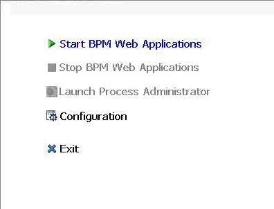

To start the Oracle Business Process Management Process engine and define the participants, you must launch the Oracle Business Process Management Admin Center.
Follow these steps to launch the Oracle Business Process Management Admin Center:
<BEA_HOME>
\albpm65\enterprise
bin
directory and double-click one of the following files:bpm_admin

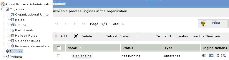

Process Engine by clicking the Engine link on the left side of the page. aler_engine
by clicking the Start icon under Engine Actions on the right side of the page. Starting the engine may take several minutes to complete. Make sure that the status of the engine is Ready

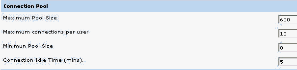

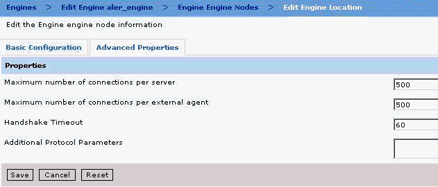

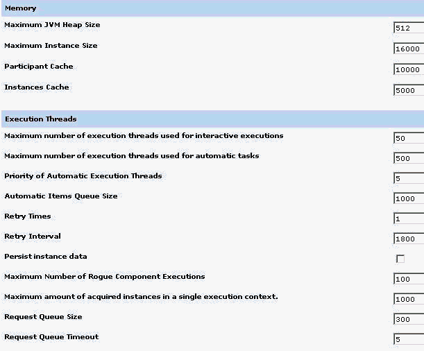

The following parameters need to be tuned using the Oracle Business Process Management Process Administrator.
Go to the Engines > <Engine Name> > Engine Nodes > Advanced Properties page.
Go to the Engines > <Engine Name> > Edit Engine Database Configuration page.
Go to the Engines > <Engine Name> > Execution page.
