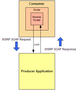

This section describes the basic WSRP architecture and then shows how this architecture can be enhanced by adding AquaLogic Service Bus.
The following figure shows the basic WSRP SOAP request and response flow between a producer application and a consumer application.
Figure 6-1 Basic Request/Response Flow Between Producer and Consumer Applications

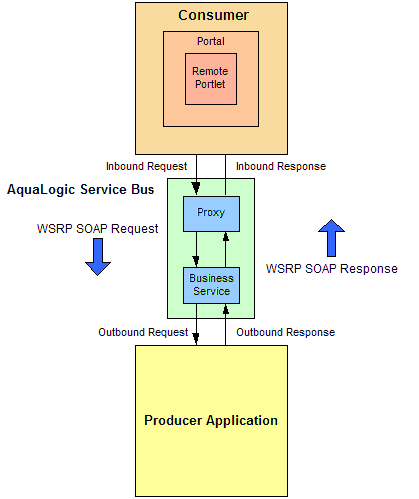

Because a WSRP producer implements SOAP Web Services, an enterprise service bus (such as the AquaLogic Service Bus) can be used as an intermediary between the producer and consumer to provide Service Level Agreement monitoring, as shown in the following figure.
Figure 6-2 Enhanced WSRP Request / Response Flow Via AquaLogic Service Bus
In this architecture, the WSRP SOAP request / response flow occurs in the following sequence:
